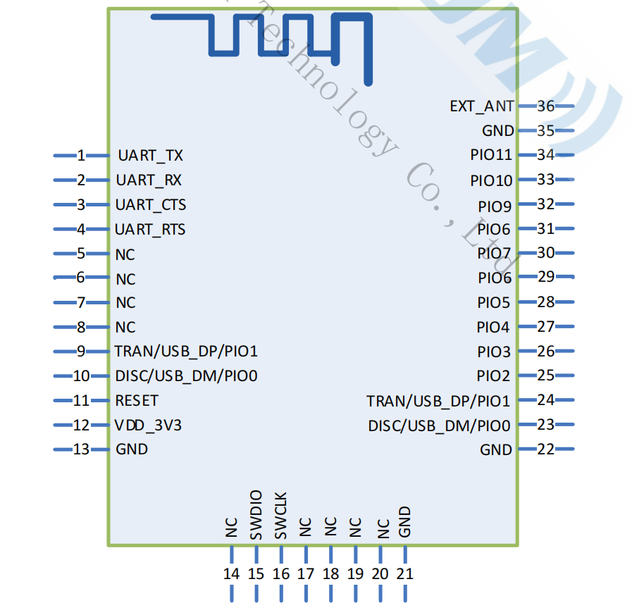

Pin diagram
Take FSC-BT986 as an example:
_images/BT986%E5%BC%95%E8%84%9A.jpg
Pin description
Pin
Pin Name
Type
Pin Descriptions
1
UART_TX
O
Serial pin
2
UART_RX
I
Serial pin
3
UART_CTS
I/O
Serial port flow controller pin/No connection required
4
UART_RTS
I/O
Serial port flow controllerrt flow controller pin/No connection required
9
Disc/USB_DM/PIO0
I/O
Disconnect pin
11
RESET
I
Low level reset
12
VDD
Power
3.3V power supply, LDO power supply is recommended
13
GND
GND
GND
15
ICE
I/O
Burn foot
32
LED
O
Bluetooth is not connected to the output square wave, Bluetooth is connected to the output high level
33
STATUS
O
Bluetooth unconnected output low, Bluetooth connected output high
34
Tran/USB_DP/PIO1
I/O
பSUART mode control foot ·H·=· Command mode ·L·=· transparent mode
36
EXT_ANT
ANT
Change the 0 ohm resistance near the antenna, you can connect the Bluetooth antenna

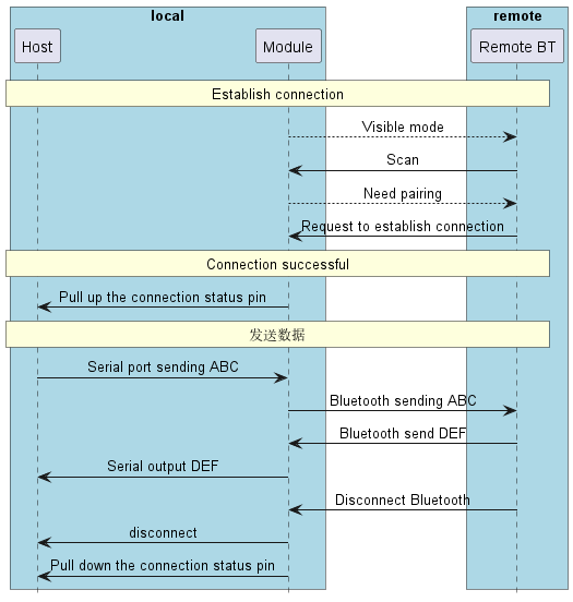

Working mode
Transparent mode
Bluetooth is not connected, the data received by the serial port is
analyzed according to the AT command;
After the Bluetooth connection, all data received by the serial port
is sent to the remote Bluetooth.
Instruction mode
After the Bluetooth connection, the data received by the serial port is
still analyzed according to the AT command.
To send data to the remote end, send the AT+SPPSEND command.

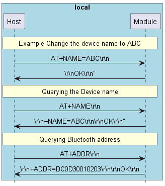

Read module Bluetooth name
<< AT+VERSION
>> +VERSION:1.0.0,FSC-BT986
>> OK

AT+NAME - Read/write BR/EDR Bluetooth name
AT+NAME{=Param1{,Param2}}
Param1
BR/EDR Bluetooth Name (1~31 Bytes ASCII)
Param2
Enable MAC address suffixes (0~2,default:0).
0: Close suffix
1: Enable the suffix “-XXXX” (4 bytes after the MAC address)
2: Enable the suffix “-XXXX “(6 bytes after the MAC address)
+NAME:Param
Param
Bluetooth name
Set the Bluetooth name if there is a parameter, otherwise just read
Read the BR/EDR Bluetooth name
<< AT+NAME
>> +NAME:FSC-BT986-XXXX
>> OK
Set the BR/EDR Bluetooth name and turn off the suffix
<< AT+NAME=ABC,0
>> OK
Set the BR/EDR Bluetooth name to ABC and automatically add an address suffix
<< AT+NAME=ABC,1
>> OK

Example Query or modify default module parameters
When the module is not connected to the Bluetooth, the serial port data will be parsed according to the AT command. The host can query and modify the default parameters of the module, as shown in the following figure:
  1. Example Change the device name to ABC
  2. Querying the Device name
  3. Querying Bluetooth address
rnote over host, bt: Example Change the device name to ABC
rnote over host, bt: Querying the Device name
rnote over host, bt: Querying Bluetooth address
Process for sending data
The module is powered on in a discoverable (visible) state by default, and the module is set to the state that needs to be paired, and the remote Bluetooth (mobile phone) can find and connect it, and initiate a connection request to the module. After the connection is successful, the module will raise the connection status pin to notify the host that the Bluetooth connection is successful. The host can send data to the remote Bluetooth through the Bluetooth module, and the remote Bluetooth can also send data to the host.
rnote over host, remote: Establish connection
        bt --> remote: Visible mode
        bt <-  remote: Scan
        bt --> remote: Need pairing
        bt <-  remote: Request to establish connection
rnote over host, remote: Connection successful
host <- bt: Pull up the connection status pin
host -> bt: Serial port sending ABC
        bt ->  remote: Bluetooth sending ABC
        bt <-  remote: Bluetooth send DEF
host <- bt: Serial output DEF
        bt <-  remote: Disconnect Bluetooth
host <- bt: disconnect
host <- bt: Pull down the connection status pin
