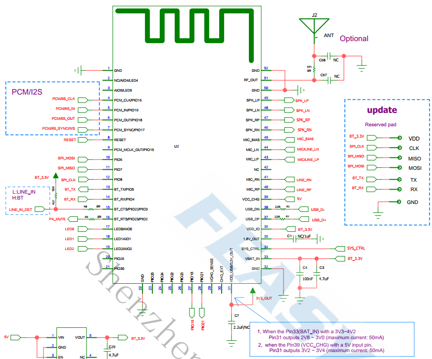

Hardware Design Notes
The simple test of the module only needs to connect VDD/VDD_IO/VREG_IN/GND/UART_RX/UART_TX to use
After drawing the schematic diagram, please send it to Feasycom for review,so as to avoid the Bluetooth distance not reaching the best effect

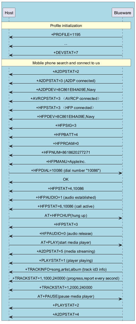

HFP Commands
AT+HFPSTAT - Read HFP State
Command |
AT+HFPSTAT |
Response |
+HFPSTAT=Param |
Description |
Format description reference: +HFPSTAT - HFP State |
AT+HFPRES - Get/Set HFP Sample Rate
Command |
AT+HFPRES{=Param} |
Sample rate (Hz) for HFP voice call, 0:16k 1-48K |
Response |
+HFPRES=Param |
Note |
BT1038 V1.0.1 does not support this command function |
AT+HFPCONN - Establish HFP Connection
Command |
AT+HFPCONN{=Param} |
MAC address of target device (12 Bytes ASCII) |
Description |
Reconnect to last HFP device if parameter not exist |
AT+HFPDISC - Release HFP Connection
Command |
AT+HFPDISC |
Description |
Release current HFP connection with remote device |
AT+HFPDIAL - Dial/Redial Phone Number
Command |
AT+HFPDIAL{=Param} |
Phone number (1~25 Bytes ASCII) |
Description |
Dial specific number if parameter exist, otherwise redial |
AT+HFPDTMF - Send DTMF code
Command |
AT+HFPDTMF{=Param} |
DTMF (0~9/#/*) |
AT+HFPANSW - Pick Up Incoming Call
Command |
AT+HFPANSW |
Description |
Pick up an incoming call |
AT+HFPCHUP - Reject/Hung up Call
Command |
AT+HFPCHUP |
Description |
Reject incoming call or hung up outgoing/active call |
AT+HFPADTS - Transfer Voice Audio Between Local and Remote Device
Command |
AT+HFPADTS=Param |
0: Transfer voice audio from module to remote device
1: Transfer voice audio from remote device to module
Description |
Transfer voice audio between module and remote device by default if no parameter set |
AT+HFPVR - Start/Stop Voice Recognition of Remote Device
Command |
AT+HFPVR=Param |
0-Stop 1-Start |
Description |
Start/Stop Voice Recognition of Remote Device (such as Siri for iOS devices) |
AT+HFPSCO - HFP SCO Configuration
Command |
AT+HFPSCO=Param |
0-default 1-always to HF 2-always to AG |
AT+HFPBATT - Send device battery level
Command |
AT+HFPBATT=Param |
level(0-9) |
A2DP/AVRCP Commands
AT+A2DPSTAT - Read A2DP State
Command |
AT+A2DPSTAT |
Response |
+A2DPSTAT=Param |
Description |
Format description reference: +A2DPSTAT - A2DP State |
AT+A2DPCONN - Establish A2DP Connection
Command |
AT+A2DPCONN{=Param} |
Description |
Reconnect to last A2DP device if parameter not exist |
AT+A2DPDISC - Release A2DP Connection
Command |
AT+A2DPDISC |
Description |
Release current A2DP connection with remote device |
AT+A2DPCFG - Read/Write A2DP Configuration
Command |
AT+A2DPCFG=Param |
A base-10 representation of a bit field, for each bit |
0: Disable AAC Codec 1: Enable AAC Codec |
0: Disable APTX Codec 1: Enable APTX Codec |
0: Disable APTX-LL Codec 1: Enable APTX-LL Codec |
0: Disable APTX-HD Codec 1: Enable APTX-HD Codec |
0: Disable APTX-AD Codec 1: Enable APTX-AD Codec |
0: Disable LDAC Codec 1: Enable LDAC Codec |
AT+A2DPDEC - Read A2DP Decoder
Command |
AT+A2DPDEC |
Response |
+A2DPDEC=Param |
1:SBC 2:AAC 3:APTX 4:APTX-HD 5:APTX-AD |
AT+A2DPRES - The resampling function is enabled
Command |
AT+A2DPRES |
Response |
+A2DPRES=Param |
0:disable 1:enable |
AT+AVRCPSTAT - Read AVRCP State
Command |
AT+AVRCPSTAT |
Response |
+AVRCPSTAT=Param |
Description |
Format description reference: +AVRCPSTAT - AVRCP State |
AT+AVRCPCFG - Get/Set AVRCP Configuration
Command |
AT+AVRCPCFG{=Param} |
A base-10 representation of a bit field, default:3, for each bit: |
Auto get track ID3 information (title, artist, album) on track changed.default:1 |
Auto get track play progress if value > 0. default:5 second |
Enable volume synchronization Settings. Default :0 |
AT+PLAYPAUSE - Track Play/Pause
Command |
AT+PLAYPAUSE |
Description |
Send play or pause command to remote media player according to current play status |
AT+PLAY - Track Play
Command |
AT+PLAY |
Description |
Send play command to remote media player |
AT+PAUSE - Track Pause
Command |
AT+PAUSE |
Description |
Send pause command to remote media player |
AT+STOP - Track Stop
Command |
AT+STOP |
Description |
Send stop command to remote media player |
AT+FORWARD - Track Forward
Command |
AT+FORWARD |
Description |
Send forward command to remote media player |
AT+BACKWARD - Track Backward
Command |
AT+BACKWARD |
Description |
Send backward command to remote media player |
AT+FFWD - Track FastForward
Command |
AT+FFWD=Param |
0-Fast Forward Release, 1-Fast Forward Press |
Description |
Send fast forward command to remote media player |
AT+RWD - Track Rewind
Command |
AT+RWD=Param |
0-Rewind Release, 1-Rewind Press |
Description |
Send rewind command to remote media player |

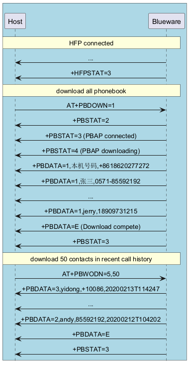

PBAP Commands
AT+PBSTAT - Read PBAP state
Command |
AT+PBSTAT |
Response |
+PBATAT=Param |
Description |
Format description reference: +PBSTAT - PBAP State |
AT+PBCONN - Establish PBAP Connection
Command |
AT+PBCONN{=Param} |
Description |
Module will use current HFP device’ MAC address if parameter not exist
For some firmware release, module will establish PBAP connection
automatically on received command AT+PBDOWN
AT+PBDISC - Release PBAP Connection
Command |
AT+PBDISC |
Description |
Release current PBAP connection with remote device |
AT+PBDOWN - Download Phonebook
Command |
Param1{,Param2} |
Phonebook type(0-5)
(0) Phonebook (SIM Storage)
(1) Phonebook (Phone Storage)
(2) Received call log
(3) Dialed call log
(4) Missed call log
(5) All call log
Max items (1~65535, default:3000 for phonebook; 50 for call log) |
Description |
For some phones (e.g. iPhone), the contact download permission
must be turned on in phone’s Bluetooth settting
refer to application note for more description: Phonebook downloading

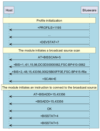

BIS Commands
AT+BISSTAT - Read BIS State
Command |
AT+BISSTAT |
Response |
+BISATAT=Param |
Description |
Format description reference: +BISSTAT - BIS State |
AT+BISSCAN - Scan BIS-Source devices
Command |
AT+BISSCAN{=Param} |
Scan timeout |
AT+BISADD - Add a synchronous broadcast source
Command |
AT+BISID{=Param1,Param2} |
adv_sid |
broadcast_id |
AT+BISREMOVE - BIS Remove broadcast source
Format |
AT+BISREMOVE |
NULL |
AT+BISPLAYPAUSE - BIS Play pause control
Format |
AT+BISPLAYPAUSE=Param1 |
NULL |
AT+BISPLAY - BIS play
Format |
AT+BISPLAY=Param1 |
NULL |
AT+BISPAUSE - BIS pause
Format |
AT+BISPAUSE=Param1 |
NULL |

(0) Stopped
(1) Playing
(2) Paused
(3) Fast Forwarding
(4) Fast Rewinding
+TRACKSTAT - Media Player Play Progress
Format |
+TRACKSTAT=Param1,Param2,Param3 |
(0~4), Media Player State, see +PLAYSTAT |
(Decimal ASCII),Elapsed time of current track in millisecond |
(Decimal ASCII),Total time of current track in millisecond |
+TRACKINFO - Media Track Information
Format |
+TRACKINFO=Param1,Param2,Param3 |
title |
artist |
album |
Phonebook Access Events
Format |
+PBSTAT=Param |
(0) Unsupported
(1) Standby
(2) Connecting
(3) Connected
(4) Downloading
+PBCNT - Phonebook Entries of Remote Device
Format |
+PBCNT=Param |
Phonebook entries of remote device |
+PBDATA - Phonebook Data
Format1 |
+PBDATA=Param1<FF>Param2<FF>Param3{<FF>Param4} |
Type
(3) Dialed call log
(4) Missed call log
Name |
Number |
(15 Bytes ASCII), Call time if current download type is call log
Format:
Year(4Bytes) Month(2Bytes) Day(2Bytes) T(1Byte) Hour(2Bytes)
Minute(2Bytes) Second(2Bytes). e.g. 20161012T152826 represents
2016/10/12/15/28/26
Format2 |
+PBDATA=E: Download complete |
Description |
Call time may not exist for some mobile phones |

BIS Events
Format |
+BISSTAT=Param |
(0) Unsupported
(1) Standby
(2) Scanning
(3) Connected
(4) Paused
(5) Streaming
+BIS - BIS The scanning result
Format |
+BIS=Param1,Param2,Param3,Param4,Param5,Param6 |
index value |
RSSI |
broadcast sid |
broadcast id |
mac address |
device name |

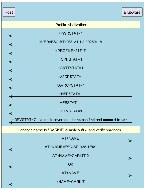

profiles initializing and change parameter
The following figure shows Profile initialization and name modification
MCU change device name CARKIT reference code:
1void change_name(void)
2{
3 uart_send("AT+NAME\r\n");
4 if(uart_read("+NAME",name_buf))
5 {
6 if(memcmp(name_buf,"CARKIT",6))
7 {
8 uart_send("AT+NAME=CARKIT,0\r\n"); //defalut disable MAC address suffix
9 uart_send("AT+NAME\r\n"); // read bt name
10 if(uart_read("+NAME",name_buf))
11 {
12 if(memcmp(name_buf,"CARKIT",6))
13 {
14 //change name fail
15 }
16 else
17 {
18 //change name success
19 }
20 }
21 }
22 }
23}
modify any parameters, it is recommended to query first and then modify the final verification
Classic BT Receive mode connection
LE Audio Broadcast Scan connection
