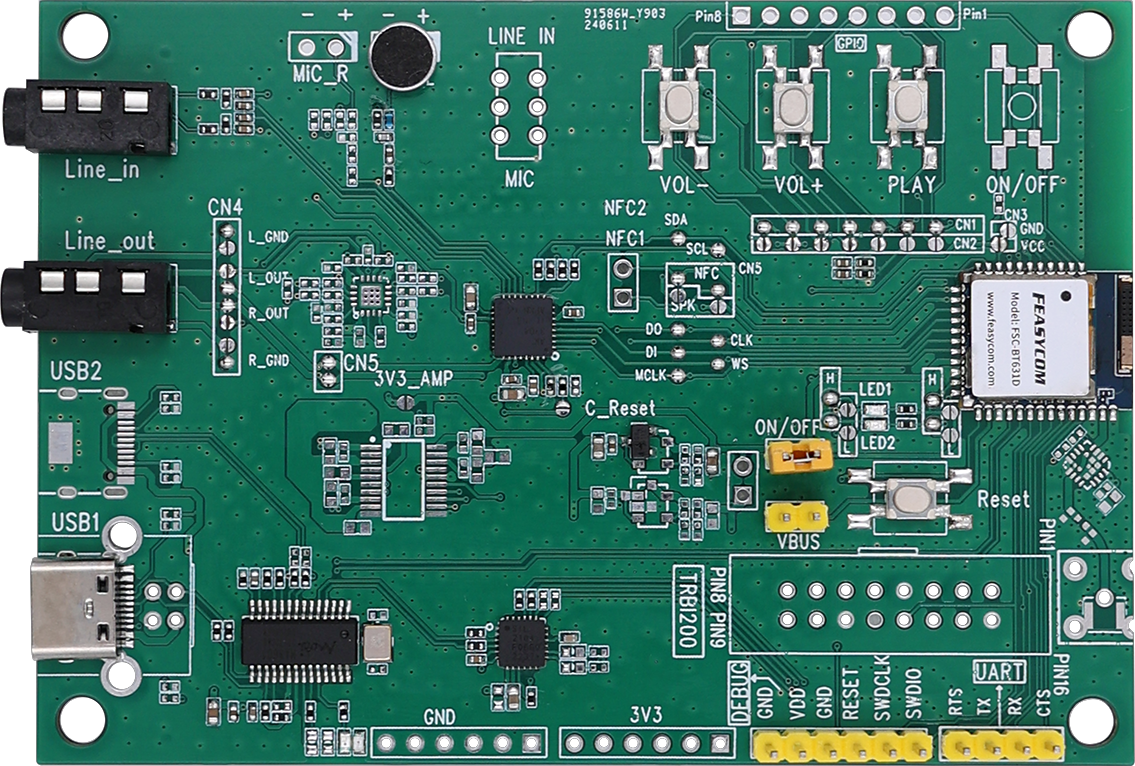

Product Describtion
Sample Picture
FSC-DB215_V3.1
FSC-DB215_V3.1
Due to the high RF requirements for the Bluetooth module in this application scenario, the module antenna is set as an external device. It is also recommended that after the customer’s terminal product design is completed, the circuit diagram/PCB of the Bluetooth part should be sent to our hardware department for verification. After confirming that there are no issues, the board can be printed

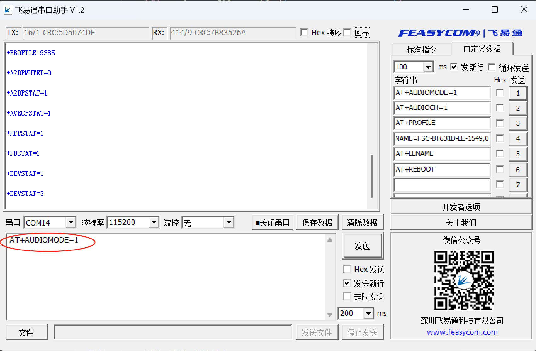

(3).You need to send the command AT+AUDIOMODE=1 through the serial port to set it to CIS mode
_images/%E4%B8%B2%E5%8F%A35.png

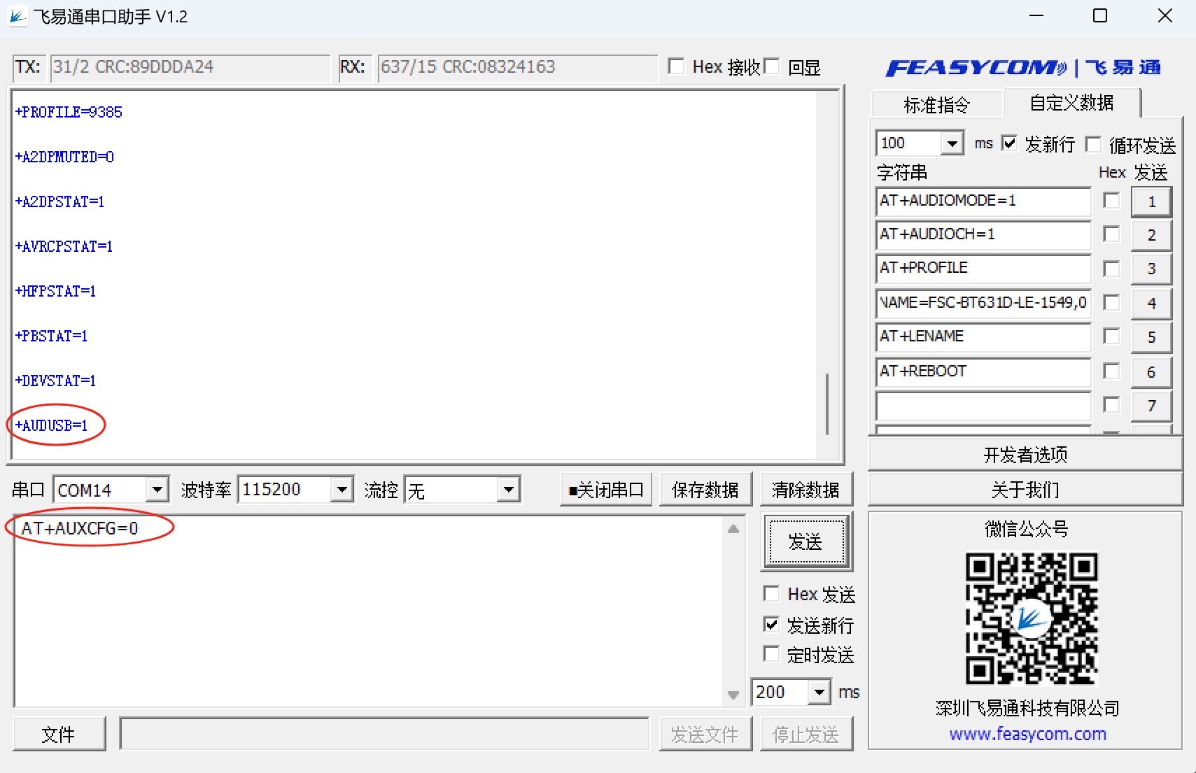

(4).Send the command AT+AUXCFG=0 through the serial port to change the audio input method to USB, and the PC will recognize a USB audio device.
_images/%E4%B8%B2%E5%8F%A36.png

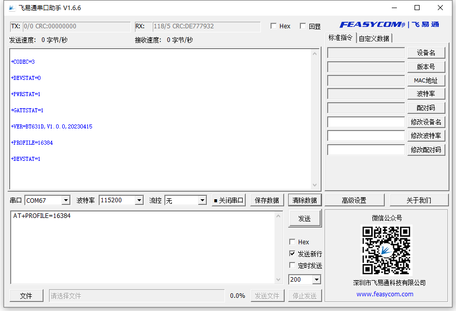

(5).Repeat operations 1, 2, and 3 on the development boards -DB2 and -DB3, then switch to CIS receiving mode and send the command: AT+PROFILE=16384
_images/%E4%B8%B2%E5%8F%A32.png

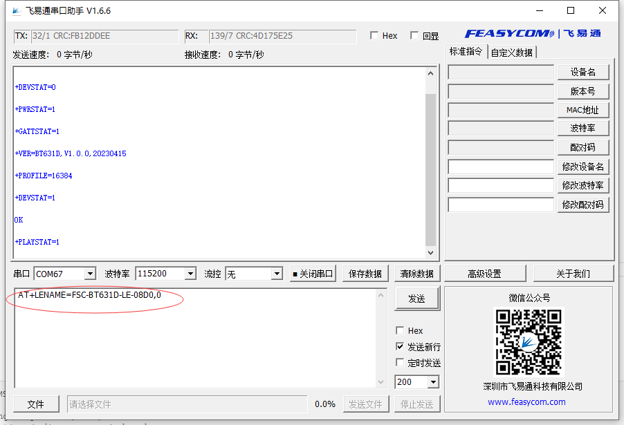

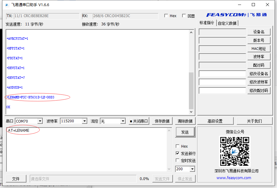

(6).For the development board -DB2, use the command AT+LENAME to read the Bluetooth name.
_images/%E4%B8%B2%E5%8F%A33.png

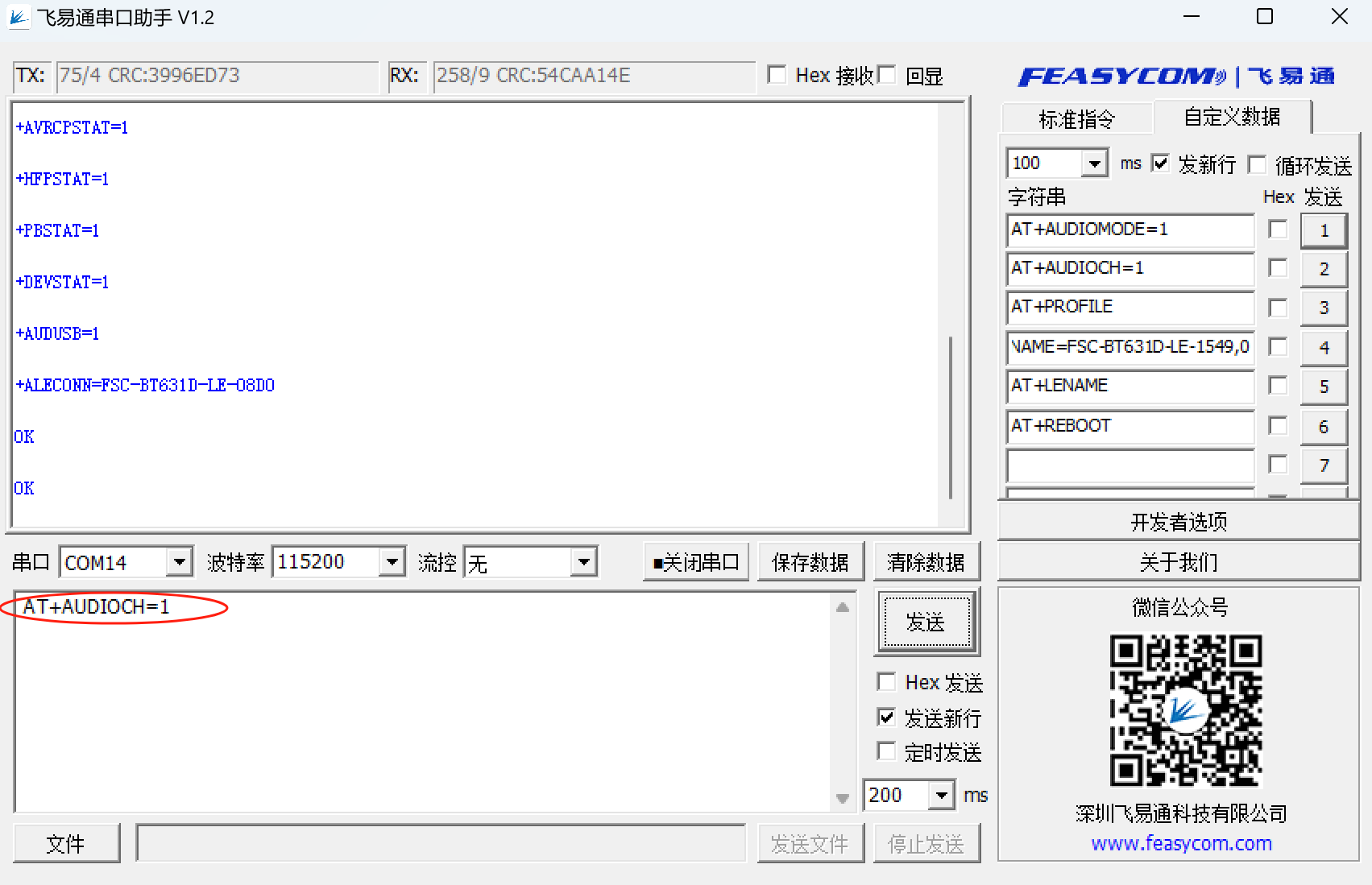

(7).For the development board -DB3, use the command AT+AUDIOCH=1 to set it to receive the right channel, and set the Bluetooth name to be consistent with the development board -DB2
_images/%E4%B8%B2%E5%8F%A38.png _images/%E4%B8%B2%E5%8F%A34.png

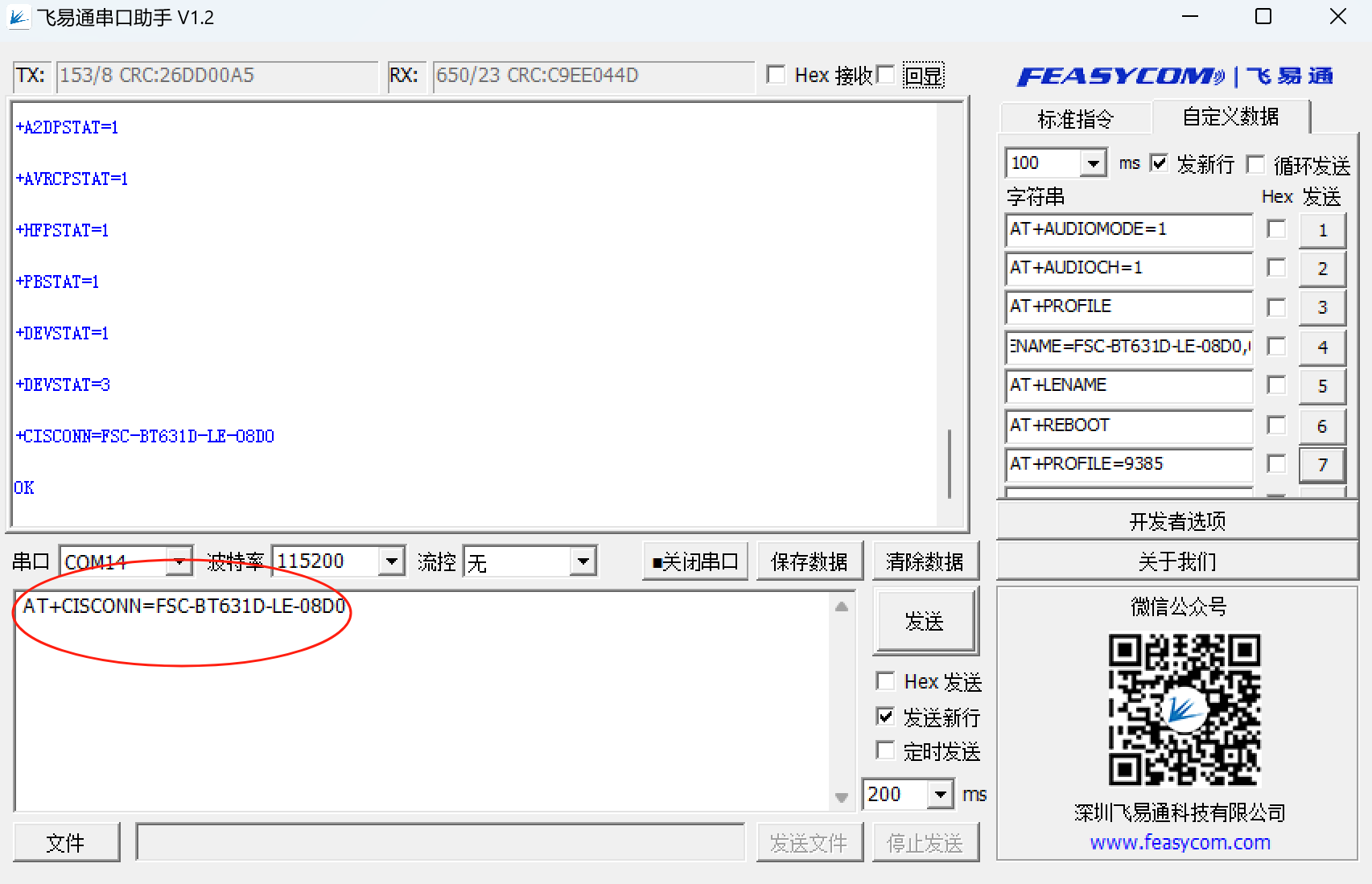

(9).For the development board-DB1, use the command AT+CISCONN=XXXX to connect two CIS slave devices. Send the command once, and DB1 will actively connect to DB2 and DB3. After the connection is successful, the green lights of DB1, 2, and 3 are always on. At this point, music played on the PC can be received on DB2 and DB3 at the same time.
_images/%E4%B8%B2%E5%8F%A37.png
