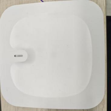

a) Gateway Introduction

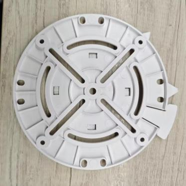

The gateway is divided to two parts, one is the main body part and the other is base part. When installing the gateway, user needs to install the base first, place it horizontally on the ceiling with screws.
main body part
base part

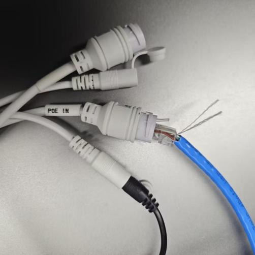

b) Gateway Connection and Power Supply
The gateway has four ports, which supports 12v wired power supply and POE power supply (requires POE-powered switch), the network cable needs to be connected to the POE IN port, as shown below:

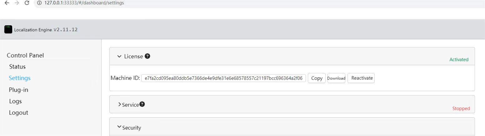

Obtain and Activate License
CCS (Core Config Station) software requires Feasycom to activate the license before using;

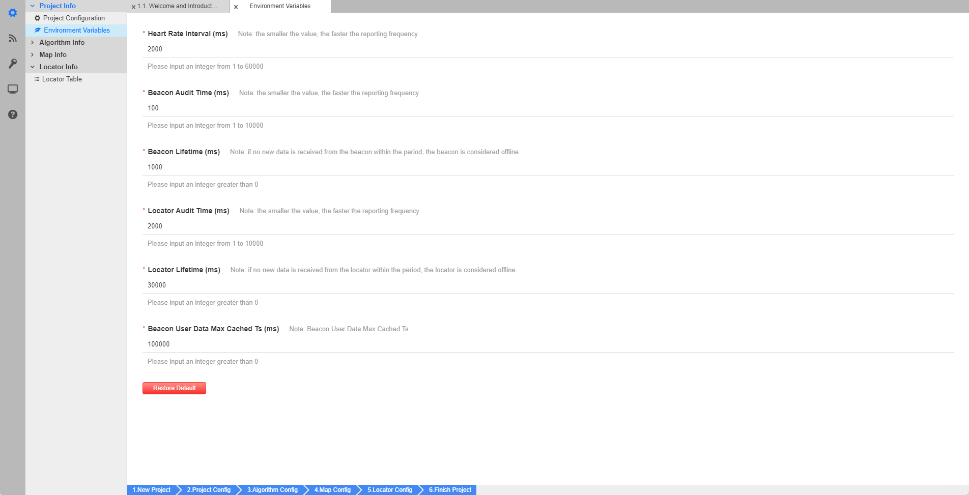

a) Environment Variable Configuration
Open CSS (Core Config Station), after creating a new project, go to Project Info - Environment Variables: The default parameters of the project are large. The following figure shows the configuration parameters that have been verified many times. They can be used directly or adjusted by the users.
CSS(Core Config Station)

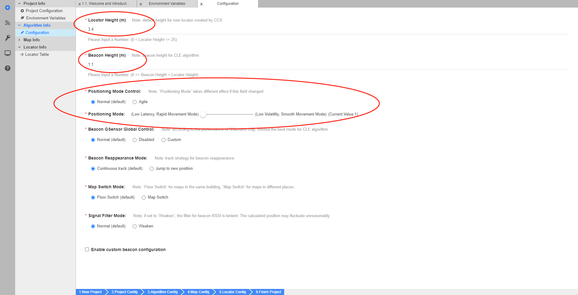

b) Algorithm Information Configuration
In the Project Info - Algorithm Info - Configuration, as shown in the figure below, the parameters in the ellipse area, please adjust them according to the actual situation, users can modify them directly;

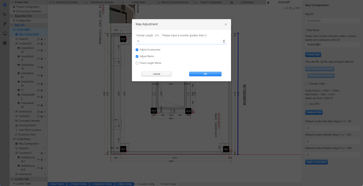

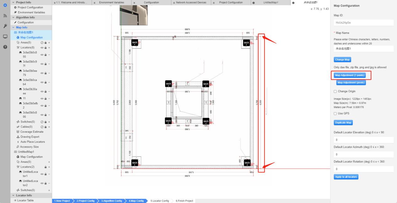

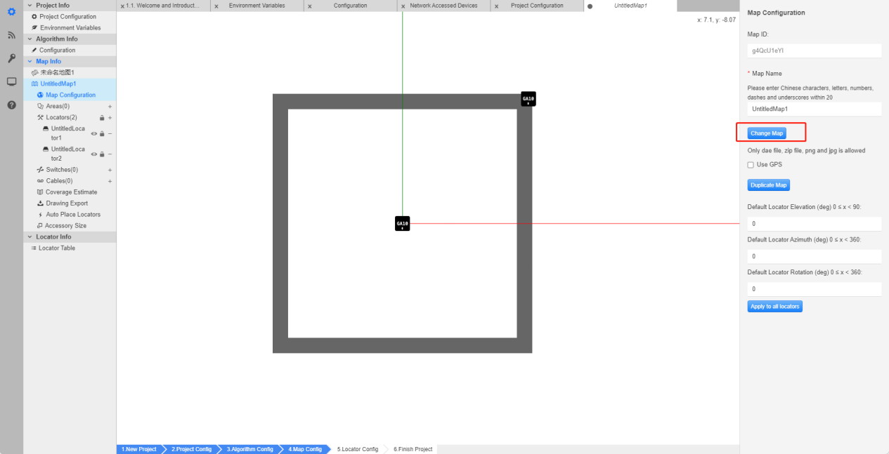

c) Map Configuration- Load Map
In the Project Info - Map Info - Map Configuration, click Change Map to add the required map, the scale must be consistent.
d) Map Configuration- Map Calibration

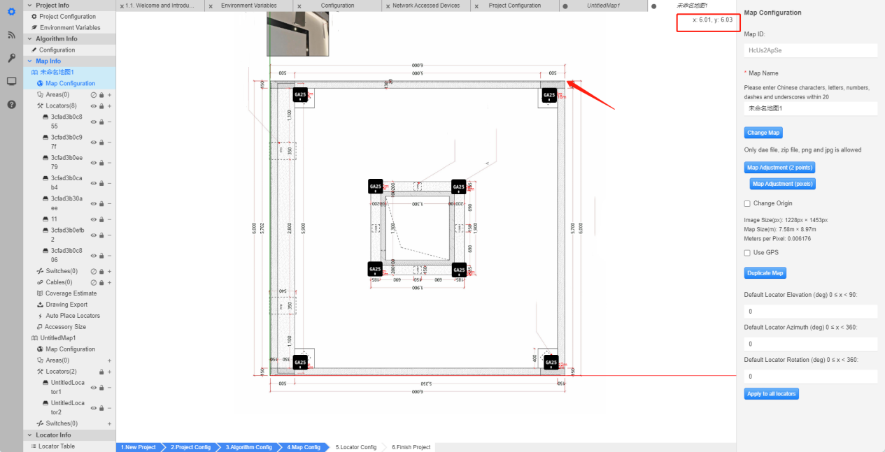

After changing the map, user needs to perform Map calibration:
Click Map Adjustment (2 Points) , select the 2 Points, and mark the two selected points in the figure below, then the Map Adjustment window pops up– Actual Length, Enter the actual distance, and check lock the marking length.
As shown in the picture below, move the mouse to the arrow to view the coordinates.
At this time, user can confirm that the map data is correct. The eg.map size is 6m x 6m.

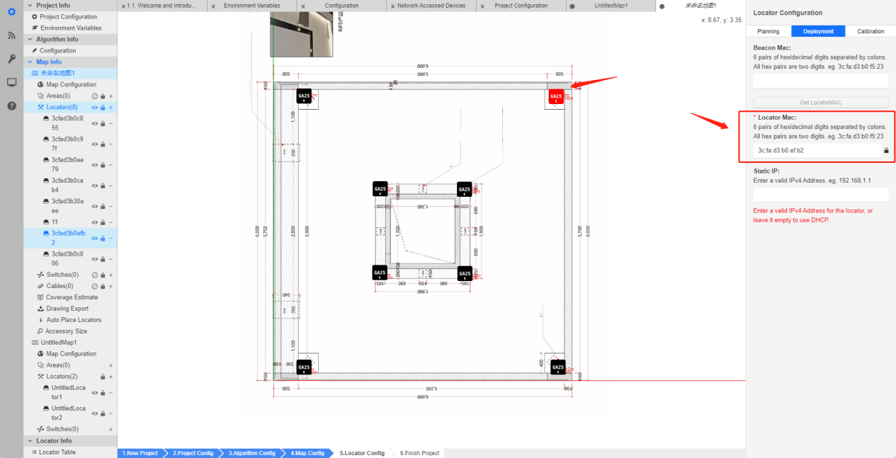

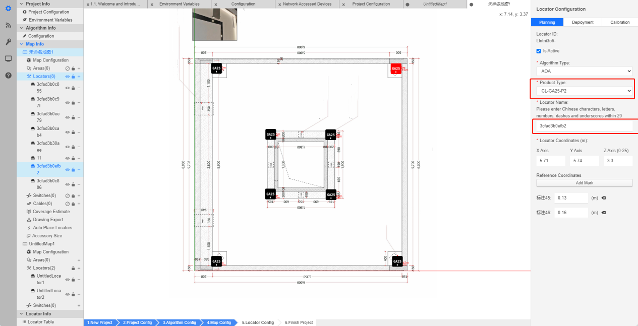

In the Base Station Configuration - Planning, choose Product Type & Base station Name. For naming the base station, it’s better to use MAC address of the base station. Fill in the coordinates of the base station (in meters) as appropriate.
In the Base Station Configuration - Deployment - Locator MAC. Please write the mac address of the base station. It must be consistent with the actual placement. Otherwise, the beacon position will be inaccurate after operation.

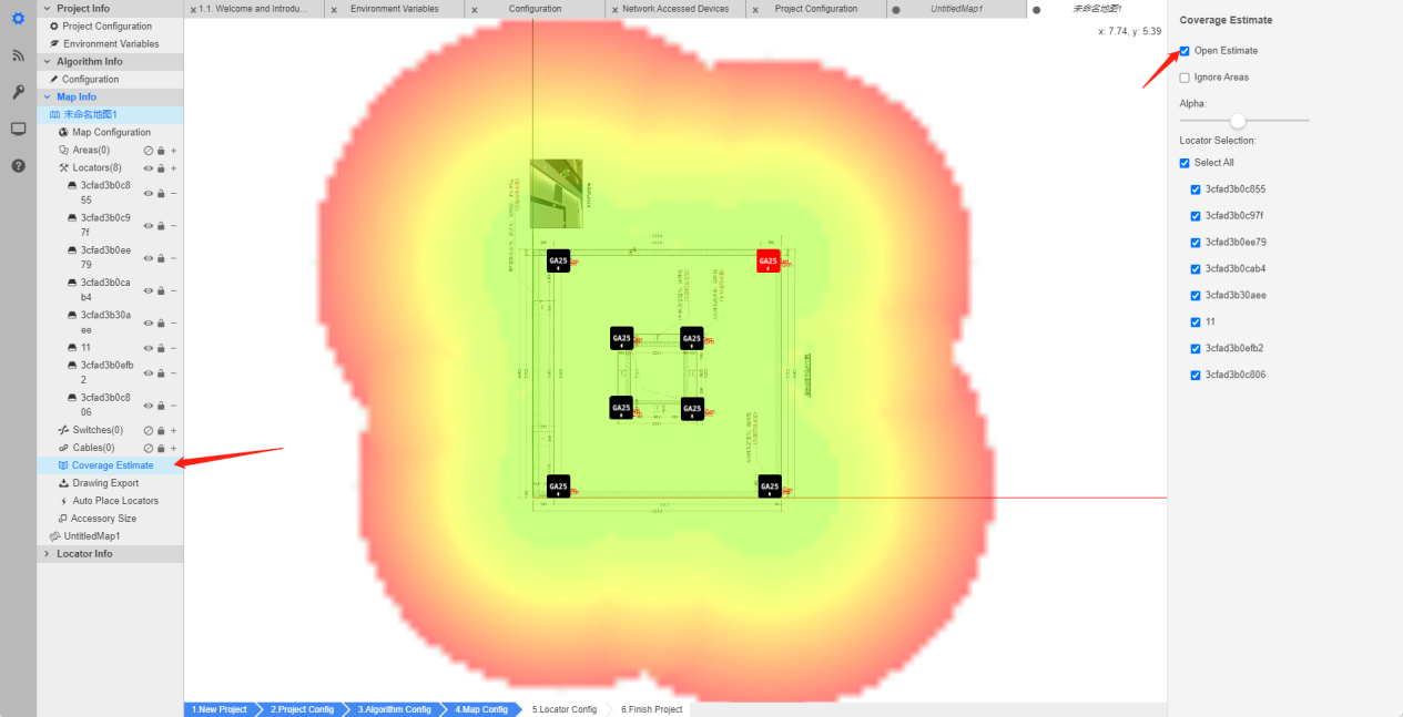

f) Simulation Test
After all settings are completed, in the Project Info - Map Info - Coverage Estimate, select Open Estimate to view the coverage after placement.

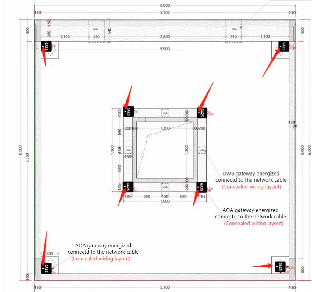

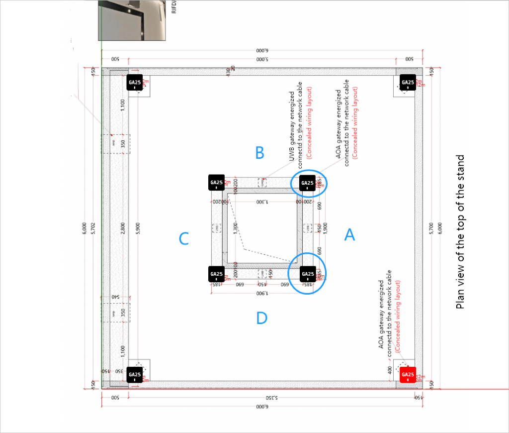

Equipment placement
On the map, each base station will have a point, which is the light on the base station, so the actual placement needs to be based on the actual direction of the map.
Avoid installing in a blocked location.
As shown in the diagram provided, the points on the base station are all facing door D. Therefore, when we stand facing door A, all the lights on the base station are all placed towards left.

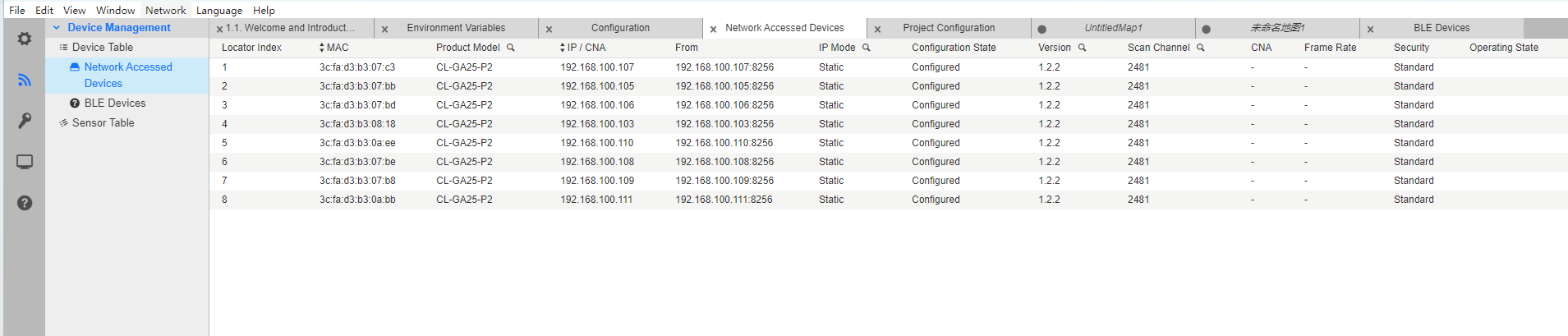

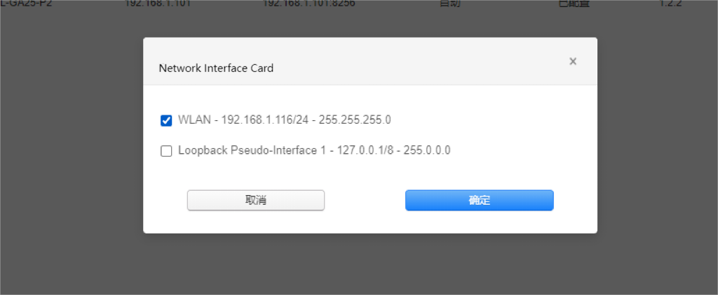

a) Network Accessed Devices View
In the Device Management - Network Accessed Devices , the base stations and beacons recognized in the LAN could be viewed.
If there is no data, please select Network--NIC--WLAN, and then right-click to refresh.
b) Device Scanning Channel Configuration
The default channel is 2481. User can right-click the base station and beacon to change the channel used, and configure it to Bluetooth channel 2402.

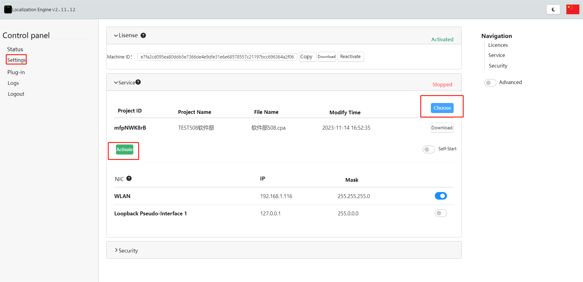

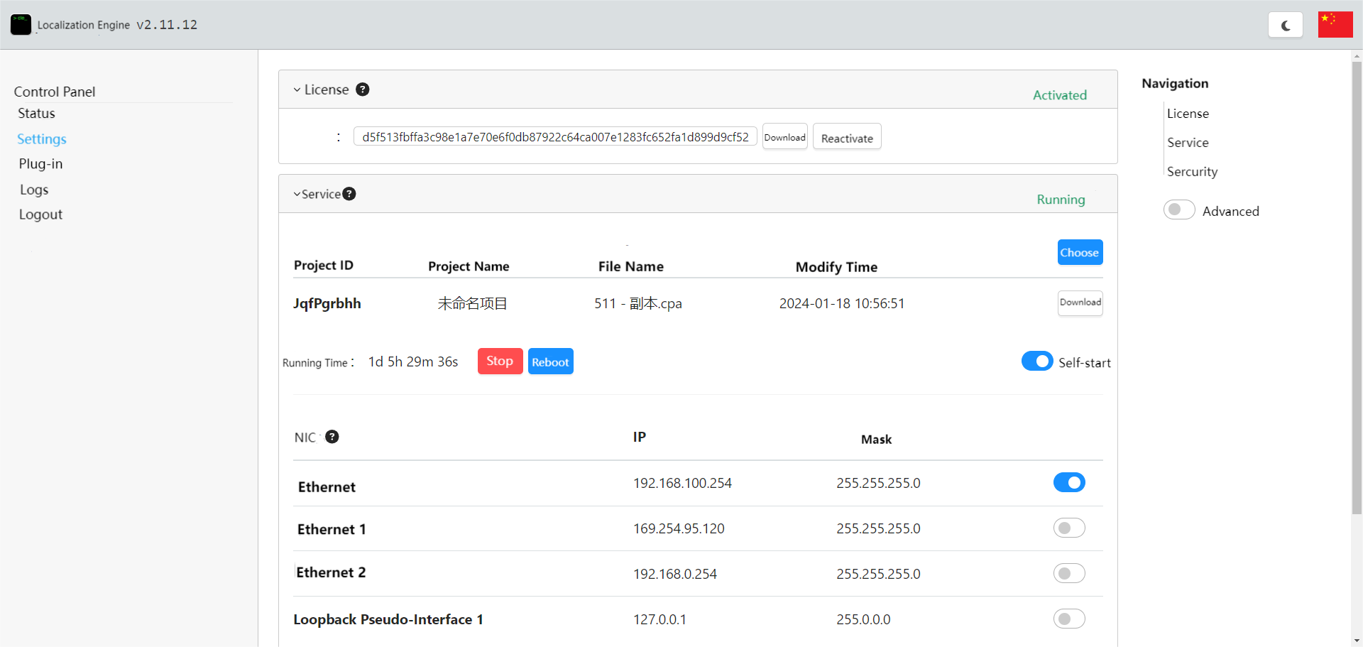

Enter 127.0.0.1:33333 in the browser, go to Positioning Engine - Settings - Services pages, Select the saved .cpa file, then click Start.

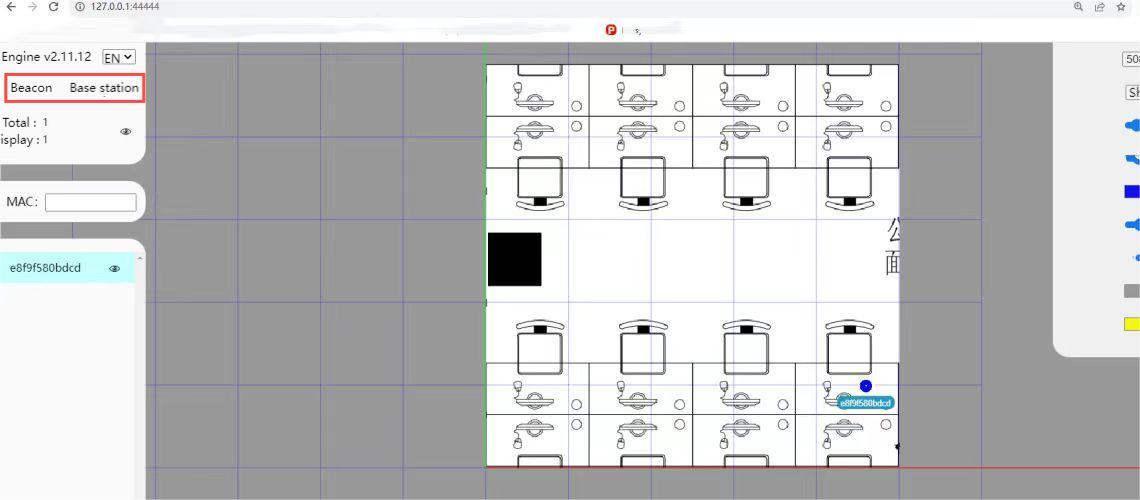

b) Real-time track view
After startup, click on real-time positioning to view the trajectory. Click on the beacon or base station to view the data of the beacon or base station.

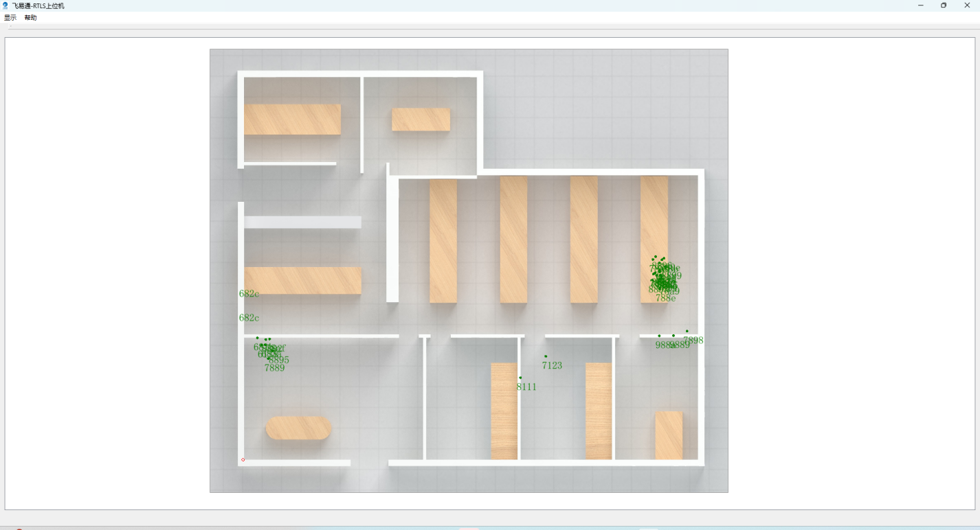

The host computer interface displays
The default display in the RTLS Upper Computer software interface is: Base Station List & Label List . The right sidebar is Parameter Setting toolbar, including system configuration, base map layout, and grid settings. The center of the interface is the actual site map and positioning point display.

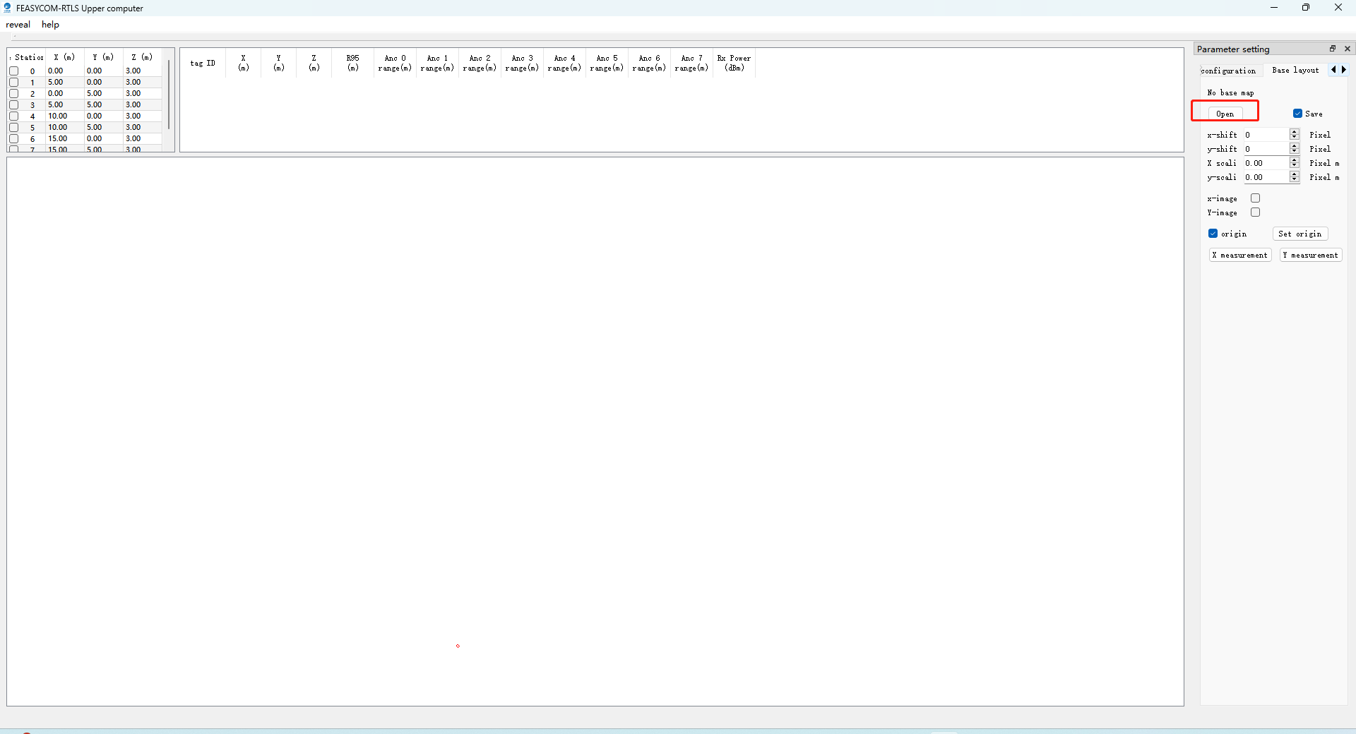

a) Basemap Settings
In the Parameter Settings - Base Layout, click Open to open the site layout image. Adjust the image zoom and offset according to the image pixels, so that the positioning points are accurately displayed on the map. If there is no basemap, user can turn on the fence mode.

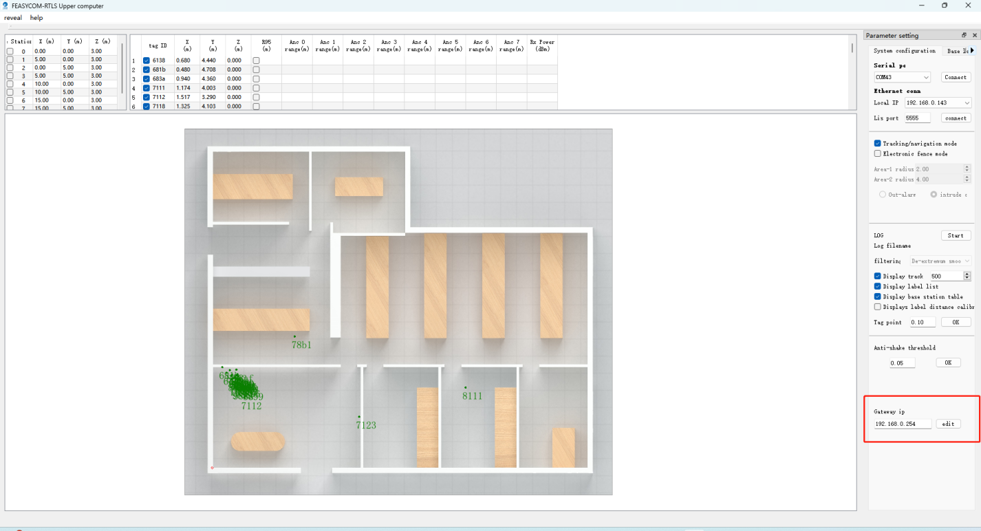

b) Positioning
In the Parameter Settings - System Configuration function column, fill in the IPv4 address of the computer with the AoA software (CSS) installed in the Gateway–IP section, and then click Modify.
Depending on the ip address segment 0 or 100 of the computer used, select the URL to fill in the gateway IP of RTLS. As shown in the image:

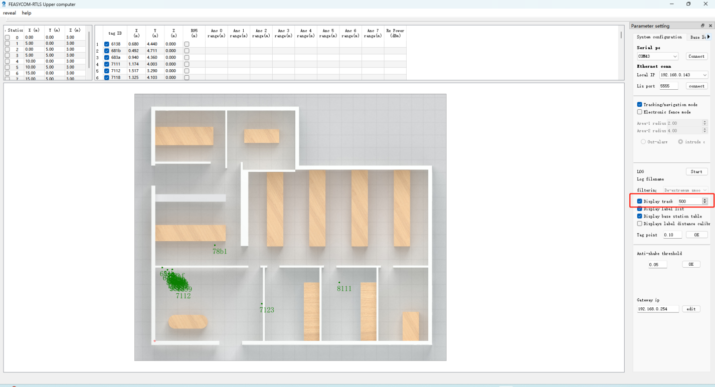

c) Trajectory
The RTLS upper computer can open the trajectory and modify the trajectory length;
In the Parameter Settings - System Configuration function column, check Display Track and fill in the numbers to set the trajectory length, upper limit is 500. As shown in the figure:

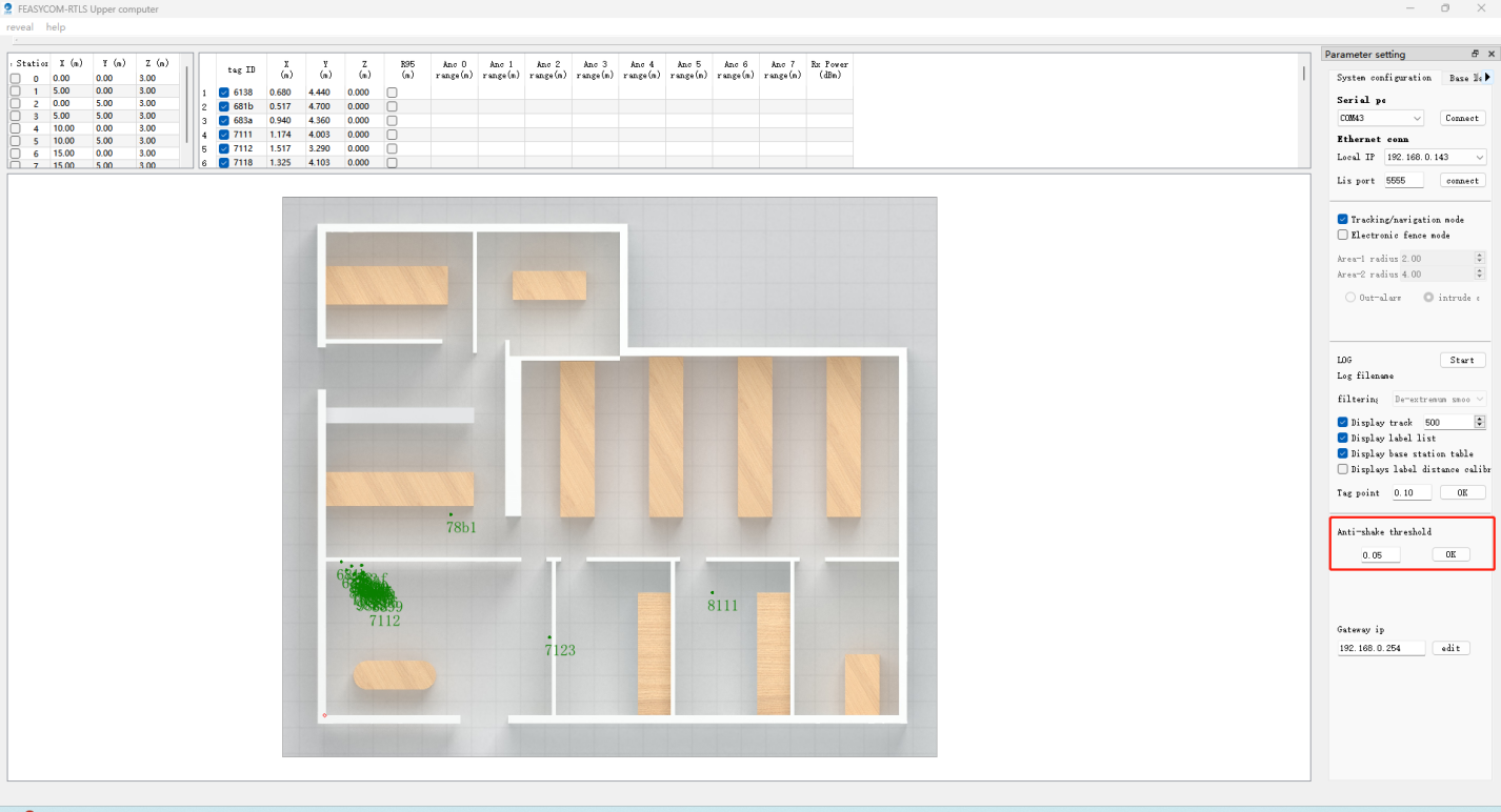

d) Anti-shack
RTLS upper computer supports anti-shake adjustment parameters (default 0.05m),
In Parameter Setting - System Configuration - Anti-Shake Threshold item, user can adjust the flutter of the positioning point. The larger the value, the smaller the fluctuation.

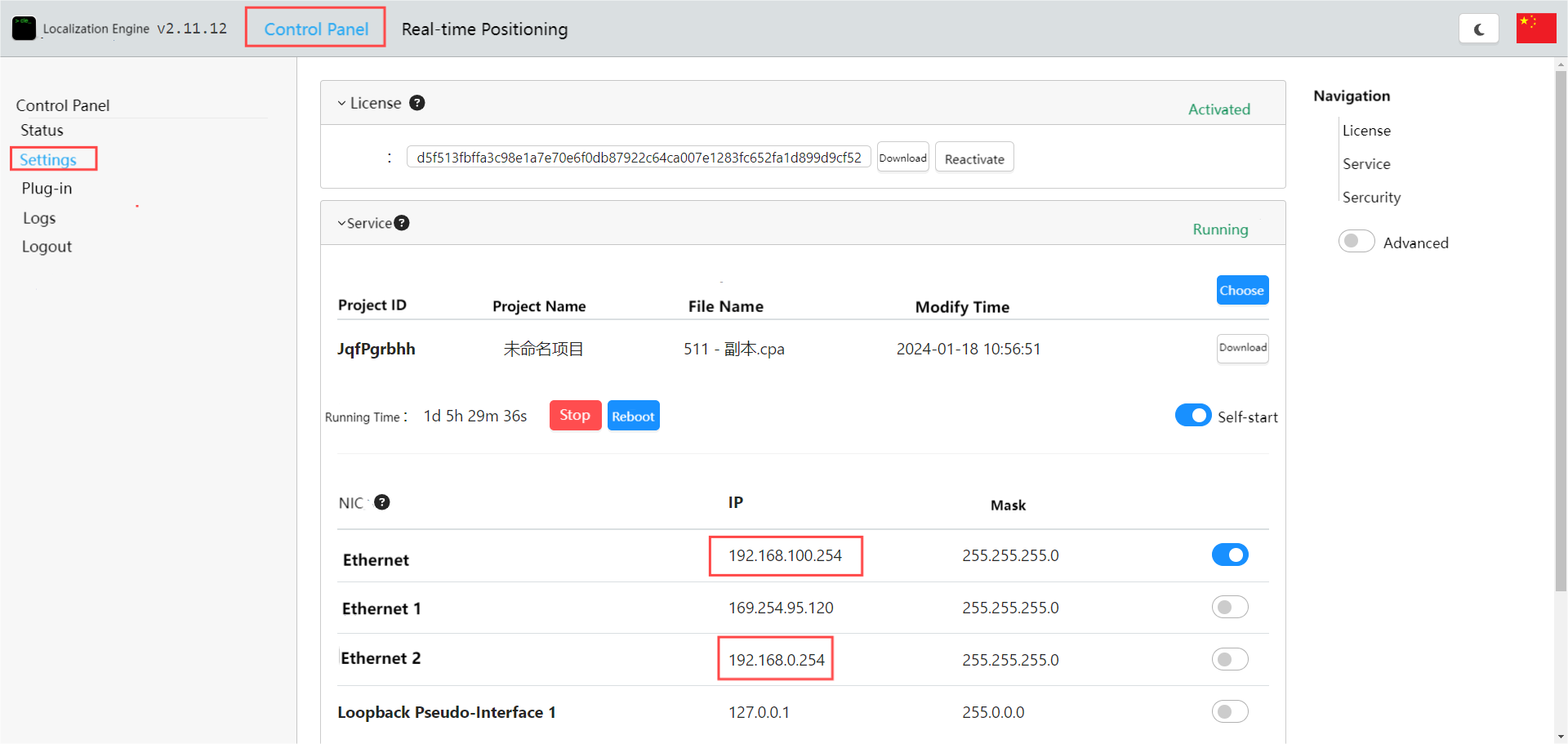

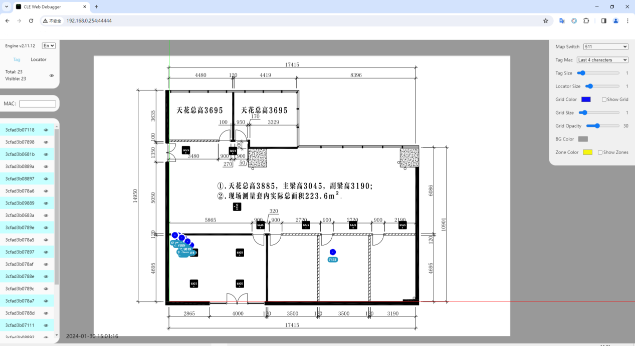

CLE DashBoard Operating Instructions
CLE DashBoard Access
For example, if the IP address of the server/PC that starts the CLE Engine is 192.168.0.254, user can use Chrome to open http://192.168.0.254:44444 on other PCs in the LAN. In this way, it’s easy to access the CLE Dashboard in the LAN.

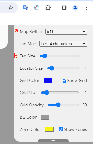

Adjuste Tag Display Size
After entering the CLE Dashboard interface, in the upper right corner of the page:

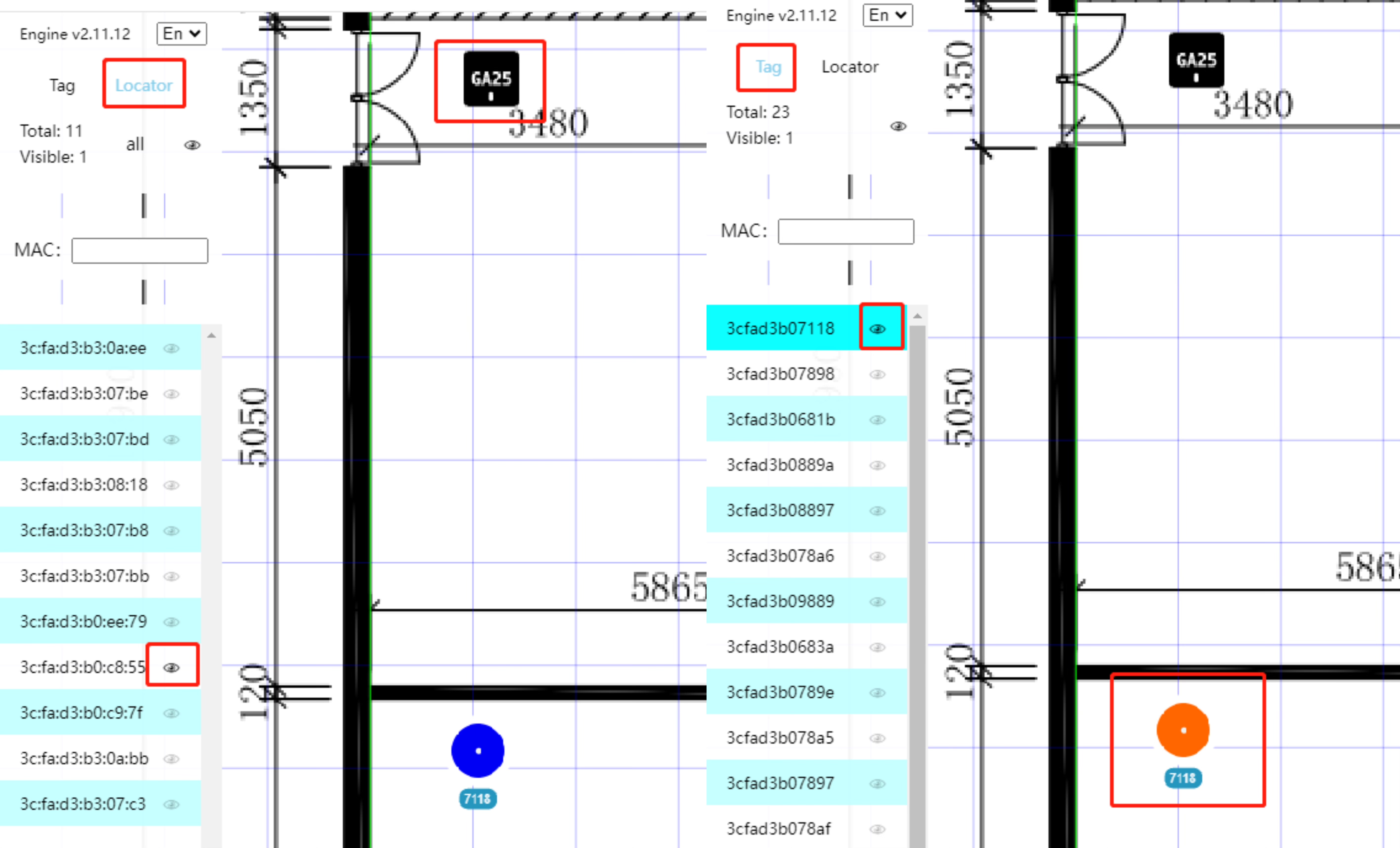

Tag/gateway display
After entering the CLE Dashboard interface, on the left side of the page: click the small eye icon to switch the corresponding tag/gateway display status.

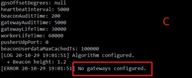

Q: Enter http://localhost:44444/ and the browser shows that this site cannot be accessed

Q: CLE Dashboard page–No beacon/The beacon has not been founded
If the map imported in CCS is a 3D map in dae/zip format, please check whether the 3D map contains height information during modeling. If it does, please flatten the z-axis or delete the height.
Please check whether the beacon is turned on. Press it once to see if the indicator light is on. If the light is on, it means it is turned on. If it is not turned on, please press and hold to turn it on.

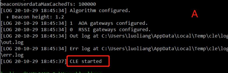

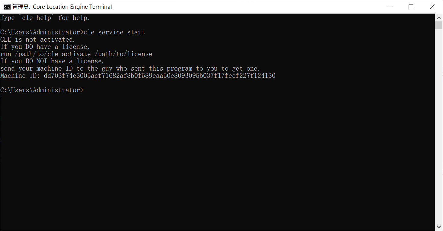

Please stop the cle engine service: cle service stop, use CCS to open and scan the beacon, then check whether the tag is online and whether the channel is the same as the gateway. If the channel is different, please change the tag to the same channel as the gateway.
