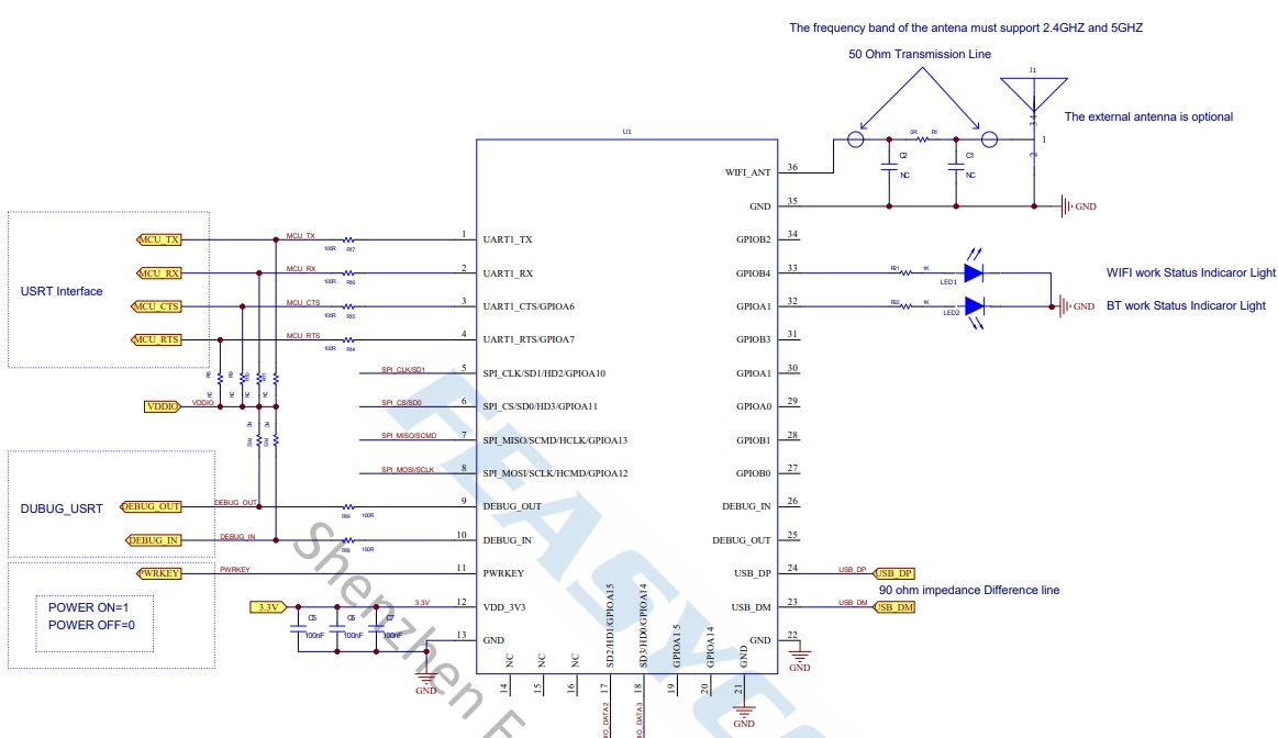

Hardware Design Notes
  • Simple module testing only needs to connect VDD/GND/UART_RX/UART_TX
  • The programming manual provides only a simple description of the IO port. For more detailed instructions and precautions, please refer to the design document
  • After drawing the schematic, please send it to Feiyitong for review to avoid the Bluetooth or Wi-Fi distance is not optimal

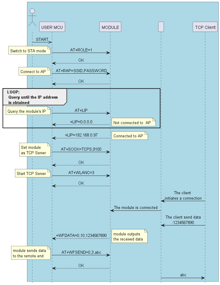

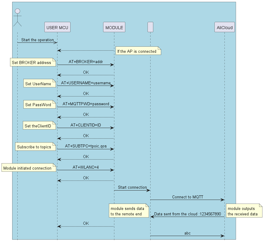

Supports the Wi-Fi protocol
  • TCP (Transmisson Control Protocol)
  • UDP (USER Datagram Protocol)
  • HTTP (Hypertext Transfer Protocol)
  • HTTPS (Hypertext Transfer Protocol Secure)
  • MQTT (Message Queuing Telemetry Transport)
  • SSL (Secure Socket Layer)

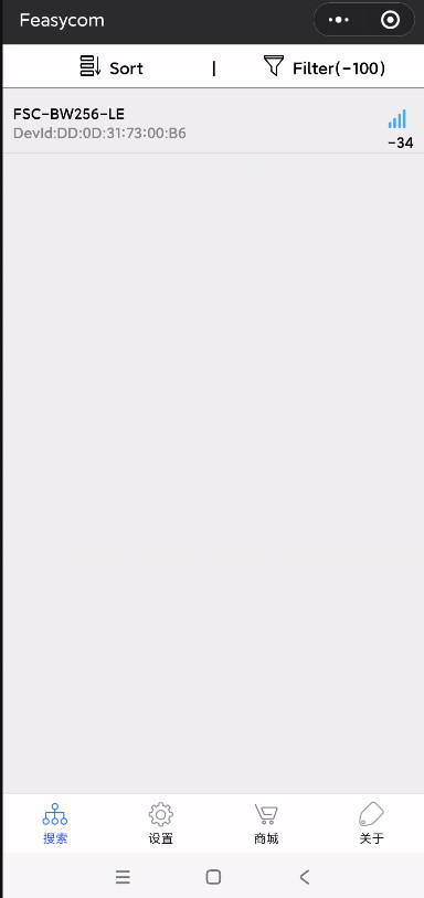

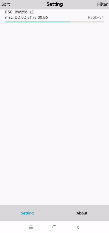

Bluetooth default Settings
BLE Name
FSC-BW256B-LE
BLE Mode
LE-Peripheral

Commands Table
Specification
Applies to the entire document
  • {} : Content between {} is optional
  • << : Content behind << represents a COMMAND from Host
  • >> : Content behind >> represents a RESPONSE/EVENT to Host
Instruction format
AT+Command{=Param1{,Param2{,Param3…}}}<CR><LF>
  • All commands start with “AT”, end with <CR><LF>
  • <CR> means “carriage return”, corresponds to hex value 0x0D
  • <LF> means “line feed”, corresponds to hex value 0x0A
  • If Command has Parameter, Parameter follows behind ‘=’
  • If Command has multiple Parameters, Parameter must be separated by ‘,’
  • If Command has Response, Response starts with <CR><LF>, ends with <CR><LF>
  • Module will always report command’s execution result by using OK for success or ERR<code> for failure

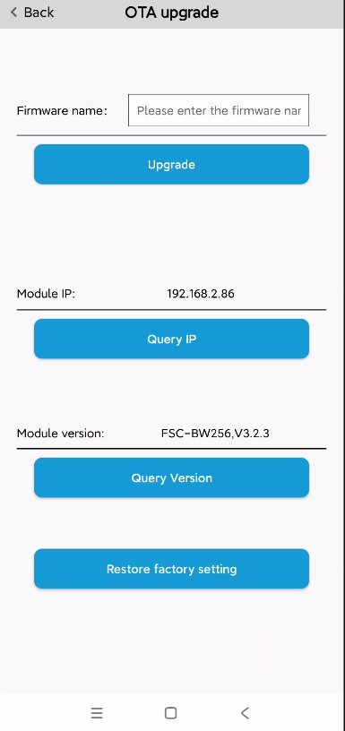

AT+REBOOT - Software Reset
AT+REBOOT
The module releases all connections to the remote device and then restarts
<< AT+REBOOT
>> OK
AT+RESTORE - Restore Factory Setting
AT+RESTORE
Module restore all factory settings then reboot
<< AT+RESTORE
>> OK

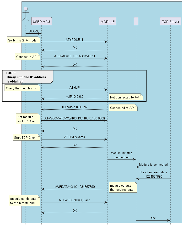

Wi-Fi Command
AT+ROLE - Read/Write Wi-Fi Mode
AT+ROLE{=Param}
Param
1: STA mode
2: AP mode
+ROLE=Param
Module will reboot after setting
Read Current Wi-Fi Mode

1. This command needs to be sent in STA mode or coexistence mode, that is, +ROLE=1 or 3
2. The module uses WPA2 encryption to connect to the hotspot by default
3. To connect to the hotspot whose encryption mode is OPEN, set the first parameter, for example
AT+RAP=Feasycom
4. Send AT+RAP to query the hotspot name
Indicates the hot spot whose name is test and password is 12345678
<< AT+RAP=test,12345678
>> OK
Queries the current hotspot
<< AT+RAP
>> +RAP=test,12345678
>> OK

AT+LIP - Read Current Local IP Address
AT+LIP
+LIP=Param
Param
IP address
When the module successfully connects to the hotspot, it will get an IP address, otherwise “0.0.0.0” is returned
Example
Queries the IP address of the current module
<< AT+LIP
<< +LIP=192.168.1.100
>> OK

AT+WLANC - Start SOCKET/MQTT/WEBSOCKET
AT+WLANC=Param
Param
3:Enable TCP/UDP/SSL
4:Connect to MQTT or cloud platform
5:Starts the WEBSOCKET
This command can only be used after the SOCKET or MQTT configuration is completed
TCP/UDP Command

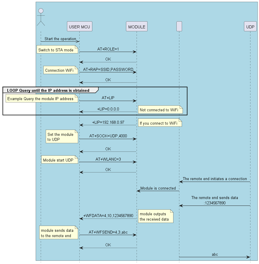

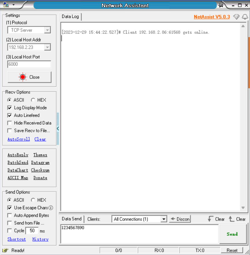

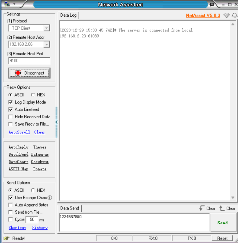

AT+SOCK - Read/Write SOCKET
AT+SOCK{=Param1,Param2,Param3,Param4} | Param4}
Param1
Protocol Type(TCPS,TCPC,UDP,SSL)
Param2
Port of Module
Param3
Remote Address
Param4
Remote Port
+SOCK=Param1, Param2, Param3, Param4
The TCP SERVER is enabled after power on, default port is 9100
Param3 and Param4 can be omitted if module works as a TCP Server or a UDP
Read SOCKET Configuration
<< AT+SOCK
>> +SOCK=TCPS,9100,0.0.0.0,0
>> OK
Module works as TCP Server, local port is 8080
<< AT+SOCK=TCPS,8080
>> OK
Module works as TCP client, local port is 8080,remote server address is “192.168.0.224”,remote server port is 6000
<< AT+SOCK=TCPC,8080,192.168.0.224,6000
>> OK
Module works as UDP,local port is 4000
<< AT+SOCK=UDP,4000
>> OK
AT+MAXCON - Queries and sets the maximum number of Clients allowed to connect in TCP Server mode.
AT+MAXCON=Param
Param
Maximum number of Clients allowed (default 3, range 1~6)
This command setting affects the ID setting of the AT+WFSEND send and the ID on the +WFDATA return
Send the maximum connect number is 3
<< AT+MAXCON=3
>> OK
Queries the maximum number of connections to a TCP server
<< AT+MAXCON
>> MAXCON=3
>> OK
AT+WFSEND - Sends SOCKET data to the remote device
AT+WFSEND=Param1,Param2,Param3
Param1
Indicates the ID of the TCP/UDP connection
Param2
Send data length (not more than 1460 bytes)
Param3
Sends data content
The overall length of the instruction does not exceed 2k bytes
When the module functions as the TCP server, it can be connected by a maximum of three remote clients by default. The ids of the three remote clients are 0, 1, and 2 respectively;
When a module functions as a TCP client, the communication ID is 3 by default;
When UDP is enabled on the module, the communication ID is 4 by default.
Sends data to the TCP Client
<< AT+WFSEND=0,3,123
>> OK
Sends data to the TCP Server
<< AT+WFSEND=3,3,123
>> OK
Sends data to UDP
<< AT+WFSEND=4,3,123
>> OK

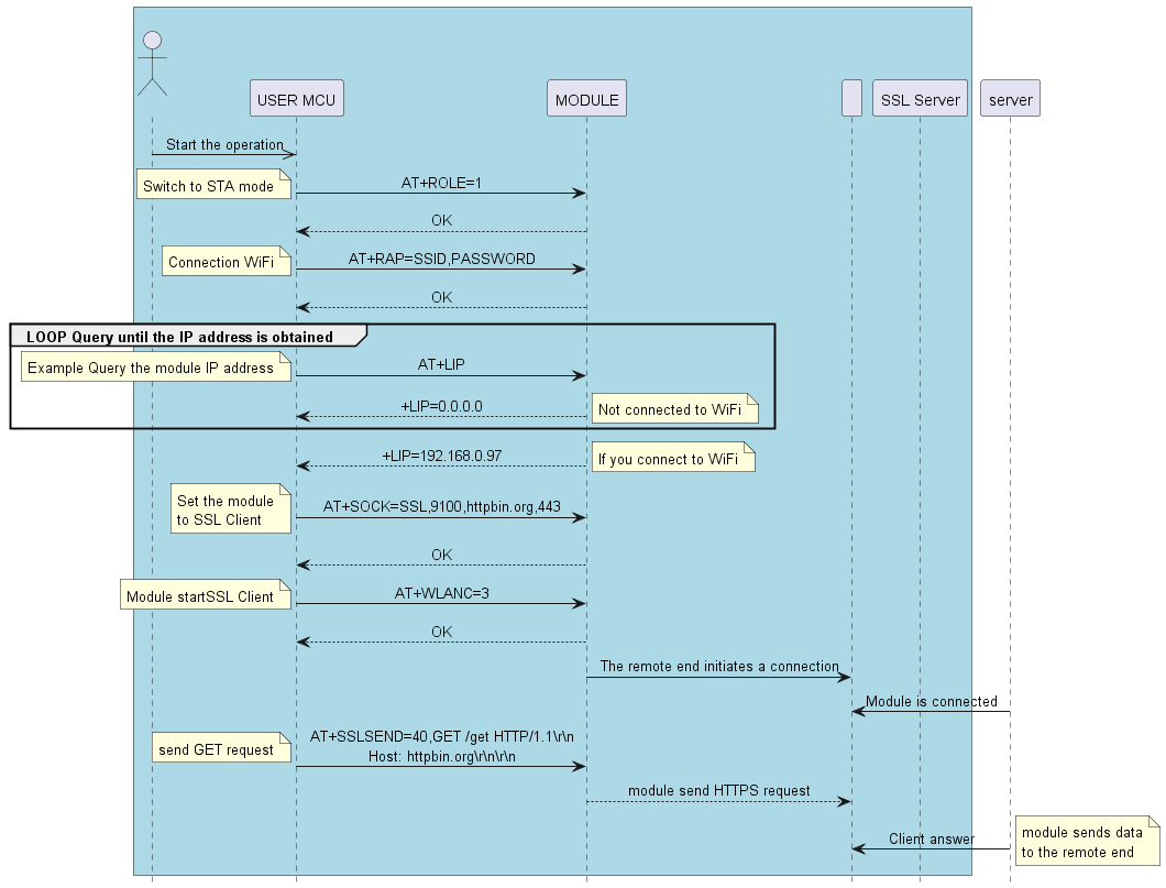

AT+SSLSEND - Send SSL data to the remote server
AT+SSLSEND=Param1,Param2
Param1
Send Data Length
Param2
Send Data Content
The length of the instruction does not exceed 2k bytes
After connecting to httpbin.org, get data via GET method
<< AT+SSLSEND=40,GET /get HTTP/1.1\r\nHost: httpbin.org\r\n\r\n
>> (return page content)

MQTT Command
AT+BROKER - Read/Write MQTT broker
AT+BROKER{=Param}
Param
MQTT server address
+BROKER=Param
“gpssensor.ddns.net” is available for testing MQTT
Read MQTT broker
<< AT+BROKER
>> +BROKER=gpssensor.ddns.net
>> OK
Write MQTT broker
<< AT+BROKER=gpssensor.ddns.net
>> OK
AT+CLIENTID - Read/Write MQTT Client ID
AT+CLIENTID{=Param}
Param
MQTT Client ID
+CLIENTID=Param
Read MQTT Client ID
<< AT+CLIENTID
>> +CLIENTID=user
>> OK
<< AT+CLIENTID=447a74ab3e60494e8c97dad36b00399b
>> OK
AT+USERNAME - Read/Write MQTT USERNAME
AT+USERNAME{=Param}
Param
MQTT USERNAME
+USERNAME=Param
Read MQTT USERNAME
<< AT+USERNAME
>> +USERNAME=admin
>> OK
Write MQTT USERNAME
<< AT+USERNAME=admin
>> OK
AT+MQTTPWD - Read/Write MQTT password
AT+MQTTPWD{=Param}
Param
MQTT MQTTPWD
+MQTTPWD=Param
Read MQTT password
<< AT+MQTTPWD
>> +MQTTPWD=12345678
>> OK
Write MQTT password
<< AT+MQTTPWD=12345678
>> OK
AT+SUBTPC - Read/Subscribe MQTT Topic
AT+SUBTPC{=Param1,Param2}
Param1
Topic
Param2
QOS, only can be 0,1,2
+SUBTPC=Param1,Param2
Read MQTT TOPIC
<< AT+SUBTPC
>> +SUBTPC=/fsc/bw236/get,0
>> OK
Write MQTT TOPIC
<< AT+SUBTPC=/fsc/bw236/test,2
>> OK
  • This command returns an error if you repeatedly subscribe to the TOPIC with the same name
  • Currently, you can subscribe to a maximum of 5 different topics. If you do not meet the usage requirements, you are advised to use wildcard characters in actual use
AT+UNSUBTPC - Unsubscribe Specify MQTT Topic
AT+UNSUBTPC=Param
Param
Specify the topic to be unsubscribed
There is no need to specify a QoS value when unsubscribes
<< AT+UNSUBTPC=/fsc/bw236/get
>> OK
AT+UNSUBALL - Unsubscribe from all MQTT topics
AT+UNSUBALL
<< AT+UNSUBALL
>> OK
AT+MQTTSEND - Send MQTT Data
AT+MQTTSEND=Param1,Param2,Param3,Param4
Param1
Publish Topic
Param2
QOS(0,1,2)
Param3
Payload length
Param4
Payload
<< AT+MQTTSEND=fsc/bw236/get,0,3,abc
>> OK
AT+MQTTMODE - Read/Write MQTT Mode
AT+MQTTMODE{=Param}
Param
0: Connect to general MQTT Server(default)
1: Connect to Ali Cloud Platform
2: Connect to QCloud Platform(Tencent)
Module connects to different cloud platforms by switching MQTT modes
<< AT+MQTTMODE
>> +MQTTMODE=0
>> OK
AT+MQTTPORT - Read/Write MQTT Port
AT+MQTTPORT{=Param}
Param
MQTT port, default is 1883

AT+OTA - Remote OTA
AT+OTA=Param
Param
Name of the firmware to be upgraded
The firmware name is provided by feasycom engineering or technical support team members.
The module will return $OTA=1 after a successful upgrade
<< AT+OTA=Feasycom_V426
>> OK
>> $OTA=1
  • Do not operate other commands or functions during the upgrade. Otherwise, the upgrade may fail or cause unexpected situations

TCP Server Application
box  #LightBlue
actor “ ” as person
participant “USER MCU” as mcu
participant MODULE as module
participant " " as nu
participant "TCP Client" as client
person ->> mcu: START
mcu -> module: AT+ROLE=1
note left
    Switch to STA mode
end note
module --> mcu: OK
mcu -> module: AT+RAP=SSID,PASSWORD
note left
    Connect to AP
end note
module --> mcu: OK
group LOOP:\n Query until the IP address\n is obtained
mcu -> module: AT+LIP
note left
    Query the module's IP
end note
module --> mcu: +LIP=0.0.0.0
note right
    Not connected to  AP
end note
end
module --> mcu: +LIP=192.168.0.97
note right
    Connected to AP
end note
mcu -> module: AT+SOCK=TCPS,9100
note left
    Set module
    as TCP Server
end note
module --> mcu: OK
mcu -> module: AT+WLANC=3
note left
    Start TCP Server
end note
module --> mcu: OK
client -> nu: The client \ninitiates a connection
nu -> module: The module is connected
client -> nu: The client send data\n:1234567890
module --> mcu: +WFDATA=0,10,1234567890
note right
    module outputs
    the received data
end note
mcu -> module: AT+WFSEND=0,3,abc
note left
    module sends data
    to the remote end
end note
module --> mcu: OK
nu -> client: abc
1、Switch to STA mode
Send:<<AT+ROLE=1
Response:>> OK
2、Connect to AP
Send:<< AT+RAP=ssid,password
Response: > OK
3. Query module IP address:
Send:<< AT+LIP
Response:>> +LIP=192.168.0.97
>> OK
4、Set the module to TCP server and port number to 9100
Send:<< AT+SOCK=TCPS,9100
Response:>> OK
5、Module create TCP server
Send:<< AT+WLANC=3
Response:>> OK
6、The PC and the module are connected to the same hotspot. Use the network debugging tool on the PC to connect to the TCP client
Connector module
_images/TCP_Server%E8%BF%9E%E6%8E%A5.jpg
7、Receive data
<< +WFDATA=0,10,1234567890
<< +WFDATA=1,10,1234567890
<< +WFDATA=2,10,1234567890
8、Send data
Send:<< AT+WFSEND=0,3,abc
Response:<< OK
  • Note: To use transparent data transmission, send AT+TPMODE=1 before setting the Wi-Fi mode
TCP Client Application
box  #LightBlue
actor “ ” as person
participant "TCP Server" as server
note left
    Switch to STA mode
end note
module --> mcu: OK
note left
    Connect to AP
end note
module --> mcu: OK
note left
end note
note right
    Not connected to AP
end note
end
note right
    Connected to AP
end note
mcu -> module: AT+SOCK=TCPC,9100,192,168.0.100,6000
note left
    Set module
    as TCP Client
end note
module --> mcu: OK
note left
    Start TCP Client
end note
module --> mcu: OK
module-> nu: Module initiates \nconnection
server -> nu: Module is connected
server -> nu: The client send data\n:1234567890
module --> mcu: +WFDATA=3,10,1234567890
note right
    module outputs
    the received data
end note
mcu -> module: AT+WFSEND=3,3,abc
note left
    module sends data
    to the remote end
end note
module --> mcu: OK
nu -> server: abc
1. Switch to STA mode
Send:<< AT+ROLE=1
Response:>> OK
2、Connect to AP
Response:>> OK
3、Query the module IP address
Send:<< AT+LIP
>> OK
4、PC and module connected to the same hotspot, using the network debugging tool on the PC,
Create a TCP server, for example, the IP address is 192.168.0.79 and the port number is 8080
5、Set the module as TCP client and configure the remote IP address and port number
Send:<< AT+SOCK=TCPC,9100,192.168.0.79,8080
Response:>> OK
6、The module functions as a TCP client to initiate a connection to the remote end
Send:<< AT+WLANC=3
Response:>> OK
_images/TCP_Client%E8%BF%9E%E6%8E%A5.jpg
7、Received data
Send:<< +WFDATA=3,10,1234567890
Response:<< OK
UDP application
box  #LightBlue
actor “ ” as person
participant "UDP" as udp
person ->> mcu: Start the operation
note left
    Switch to STA mode
end note
module --> mcu: OK
note left
    Connection WiFi
end note
module --> mcu: OK
group LOOP Query until the IP address is obtained
note left
    Example Query the module IP address
end note
note right
    Not connected to WiFi
end note
end
note right
    If you connect to WiFi
end note
mcu -> module: AT+SOCK=UDP,4000
note left
    Set the module
    to UDP
end note
module --> mcu: OK
note left
    Module start UDP
end note
module --> mcu: OK
udp -> nu: The remote end initiates a connection
nu -> module: Module is connected
udp -> nu: The remote end sends data\n:1234567890
module --> mcu: +WFDATA=4,10,1234567890
note right
    module outputs
    the received data
end note
mcu -> module: AT+WFSEND=4,3,abc
note left
    module sends data
    to the remote end
end note
module --> mcu: OK
nu -> udp: abc
Send:<< AT+ROLE=1
Respond:>> OK
2、Connect to AP
Respond:>> OK
3、Query the IP address to check whether AP is connected
Send:<< AT+LIP
Respond:>> +LIP=192.168.0.97 >> OK
4、Configure the module as UDP
Send:<< AT+SOCK=UDP,4000
Respond:>> OK
5、The module enables the UDP Server
Send:<< AT+WLANC=3
Respond:>> OK
6.The PC and the module are connected to the same hotspot. On the PC, use the network debugging tool to open a UDP
Client, the target IP address is 192.168.0.97, and the target port number is 4000.
7、Received data
<< +WFDATA=4,10,1234567890
8. Send data
Send:<< AT+WFSEND=4,3,abc
Respond:<< OK
SSL Client Application
box  #LightBlue
actor “ ” as person
participant "SSL Server" as udp
note left
    Switch to STA mode
end note
module --> mcu: OK
note left
    Connection WiFi
end note
module --> mcu: OK
note left
end note
note right
end note
end
note right
end note
mcu -> module: AT+SOCK=SSL,9100,httpbin.org,443
note left
    Set the module
    to SSL Client
end note
module --> mcu: OK
note left
    Module startSSL Client
end note
module --> mcu: OK
module-> nu: The remote end initiates a connection
mcu -> module: AT+SSLSEND=40,GET /get HTTP/1.1\\r\\n\nHost: httpbin.org\\r\\n\\r\\n
note left
        send GET request
end note
module --> nu: module send HTTPS request
server -> nu: Client answer
note right
    module sends data
    to the remote end
end note
Send:<< AT+ROLE=1
Respond:>> OK
2、Connect to AP
Respond:>> OK
Send:<< AT+LIP
4. Set the module as SSL client and configure the remote server and port number.
Send:<< AT+SOCK=SSL,9100,httpbin.org,443
Response:>> OK
5. Module initiates connection to remote as SSL client
Send:<< AT+WLANC=3
Response:>> OK
6. Send a related request, such as a GET request
Send:<< AT+SSLSEND=40,GET /get HTTP/1.1\r\nHost: httpbin.org\r\n\r\n
7、Received data
<< +SSLDATA=Detailed Data
MQTT Application
box  #LightBlue
actor “ ” as person
participant "AliCloud" as cloud
module --> mcu:
note right
    If the AP is connected
end note
mcu -> module: AT+BROKER=addr
note left
    Set BROKER address
end note
module --> mcu: OK
mcu -> module: AT+USERNAME=username
note left
    Set UserName
end note
module --> mcu: OK
mcu -> module: AT+MQTTPWD=password
note left
    Set PassWord
end note
module --> mcu: OK
mcu -> module: AT+CLIENTID=ID
note left
    Set theClientID
end note
module --> mcu: OK
mcu -> module: AT+SUBTPC=tpoic,qos
note left
    Subscribe to topics
end note
module --> mcu: OK
mcu -> module: AT+WLANC=4
note left
    Module initiated connection
end note
module --> mcu: OK
module -> nu: Start connection
nu -> cloud: Connect to MQTT
cloud -> nu: Data sent from the cloud :1234567890
note right
    module outputs
    the received data
end note
note left
    module sends data
    to the remote end
end note
module --> mcu: OK
nu -> cloud: abc
Send:<< AT+ROLE=1
Response:>> OK
2、Connect to AP
Response:>> OK
3、Example Query the module IP address
Send:<< AT+LIP
Response:>> +LIP=192.168.0.87
>> +LIP=192.168.0.87
4、Set BROKER address
Send:<< AT+BROKER=gpssensor.ddns.net
Response:>> OK
5、Set User Name
Send:<< AT+USERNAME=admin
Response:>> OK
6. Set Password
Send:<< AT+MQTTPWD=12345678
Response:>> OK
7. Subscribe to topics
Send:<< AT+SUBTPC=user/get
Response:>> OK
8、 Connect MQTT
Send:<< AT+WLANC=4
Response:>> OK
9. Receive data from the cloud platform
1234567890
10.Send data to the cloud platform
Send:<< AT+MQTTSEND=/user/post,0,3,abc
Response:>> OK

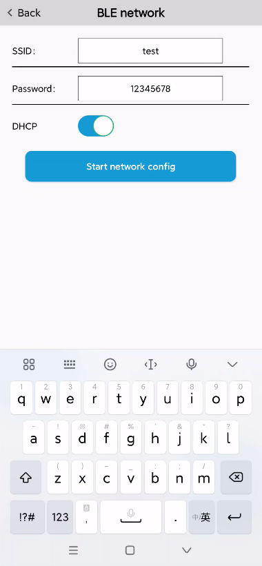

OTA by FeasyWiFi APP
Specific Instruction Process Description
1、Download FeasyWiFi APP from APP STORE or GOOGLE PLAY
2、Enter the APP interface , search and connect to the target module
_images/FeasyWiFi%E6%90%9C%E7%B4%A2%E6%98%BE%E7%A4%BA.jpg

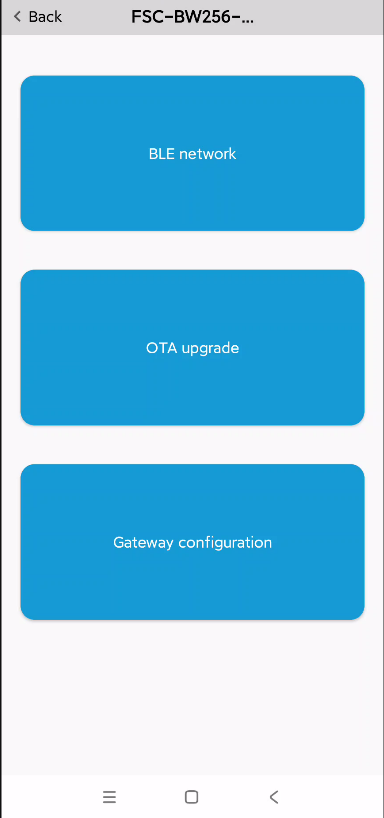

3、After the correct connection, it will jump to the following interface, click the Bluetooth network first
_images/FeasyWiFi%E8%BF%9E%E6%8E%A5%E7%95%8C%E9%9D%A2.jpg
4、On the Bluetooth distribution screen, enter the hotspot name and password, and click Start
_images/FeasyWiFi%E9%85%8D%E7%BD%91%E7%95%8C%E9%9D%A2.jpg
5、After the network is configured successfully, return to the previous page and select OTA upgrade. You can query the IP address and enter the firmware to be upgraded
_images/FeasyWiFi_OTA.jpg
  • The hotspot needs to support access to the Internet.

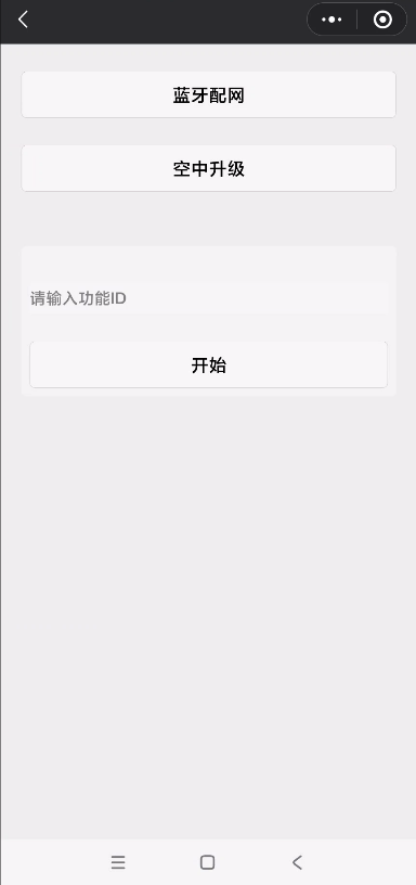

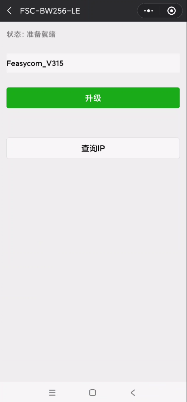

Wechat mini program distribution network and OTA usage instructions
Specific process description
1、Wechat search open the small program “Bluetooth serial port” small program, the interface is as follows, click the setting button below
_images/%E5%B0%8F%E7%A8%8B%E5%BA%8F%E6%90%9C%E7%B4%A2%E7%95%8C%E9%9D%A2.jpg

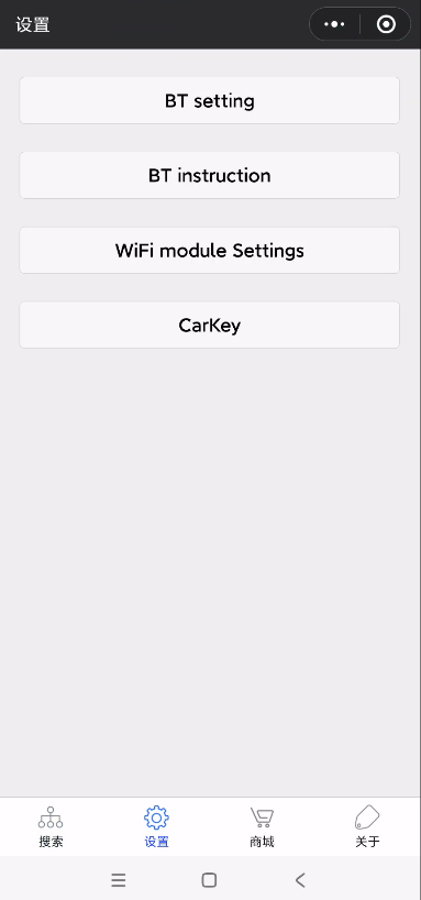

2、The setting interface is as follows: Click WiFi module setting (the Bluetooth command tool is used to send air commands, that is, to send AT commands in Bluetooth mode to configure the module)
_images/%E5%B0%8F%E7%A8%8B%E5%BA%8F%E8%AE%BE%E7%BD%AE%E7%95%8C%E9%9D%A2.jpg
3、Bluetooth networking first
_images/%E5%B0%8F%E7%A8%8B%E5%BA%8F%E8%93%9D%E7%89%99%E9%85%8D%E7%BD%91.jpg

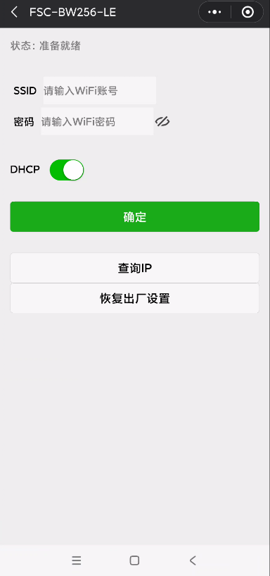

4、Connect the device that needs to be upgraded by Bluetooth, enter the distribution network interface, enter the hotspot and password to be connected, and click OK
_images/%E5%B0%8F%E7%A8%8B%E5%BA%8F%E9%85%8D%E7%BD%91%E7%95%8C%E9%9D%A2.jpg
5、After the network distribution is successful, return to the previous interface, select in-flight upgrade, enter the firmware to be upgraded, click OK, and wait until the upgrade is complete
_images/%E5%B0%8F%E7%A8%8B%E5%BA%8F_OTA.jpg
