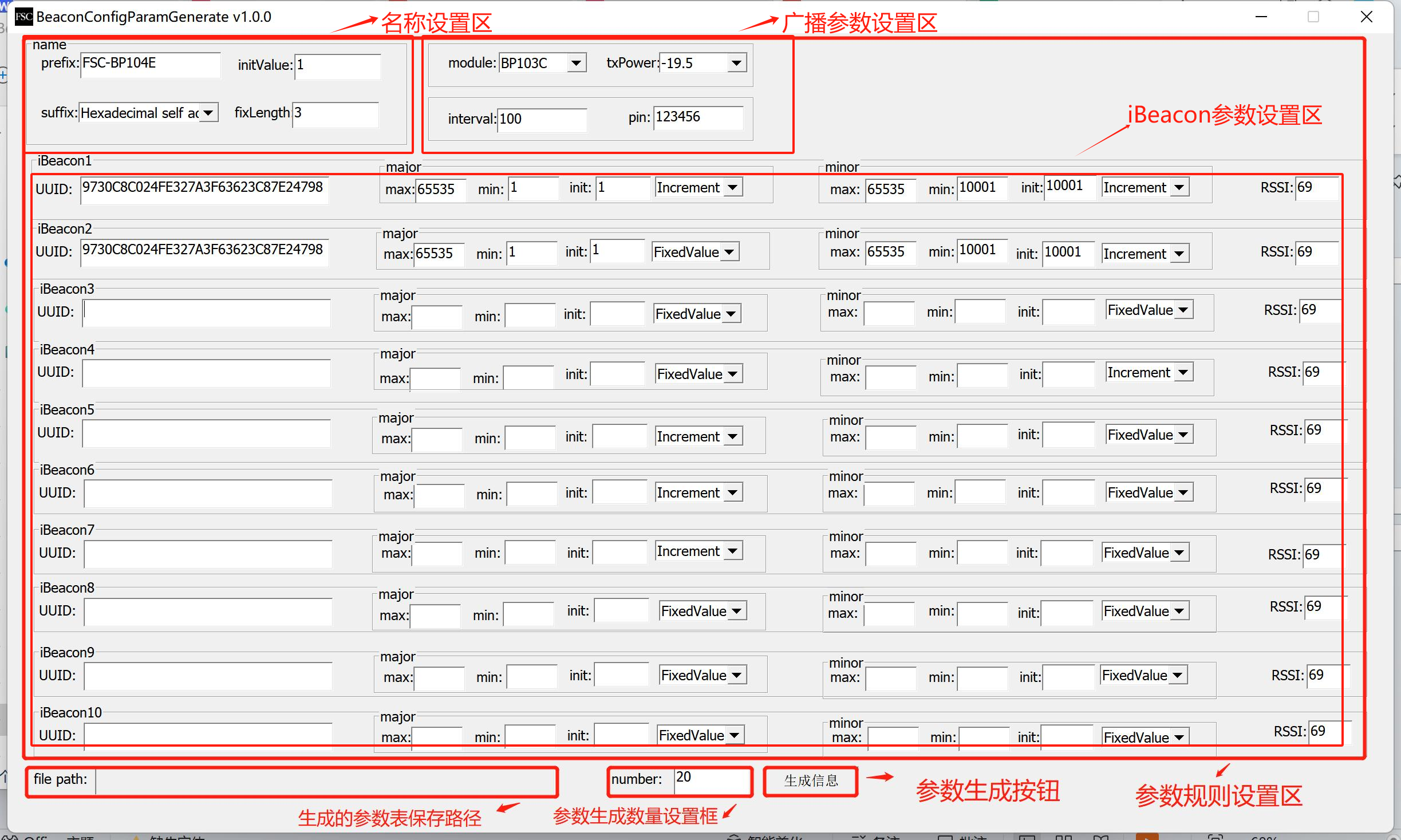

UI
The interface is intuitive and easy to use, allowing users to easily set parameters and generate configurations.

What Information is Included in Beacon Parameters?
  • Name: The name of the Beacon, used to identify and distinguish different Beacon devices.
  • Txpower: The signal transmission power of the Beacon device, measured in dBm.
  • Interval: The time interval for the Beacon to broadcast signals, measured in milliseconds (ms). This parameter determines the frequency of Beacon signal broadcasts. A shorter interval can increase signal coverage but will consume more battery power.
  • Pin: The PIN code used for connection.
  • UUID: A globally unique identifier used to distinguish different Beacon networks or applications.
  • Major: Used to distinguish regions or categories under the same UUID.
  • Minor: Used to further refine the classification of Major and identify more specific locations or items.
  • Rssi: A 1-byte value representing the average signal strength received from the advertising device at a distance of 1 meter, with a value range from 0 to -127.

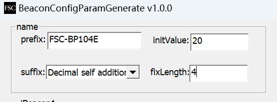

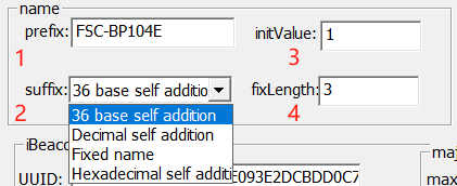

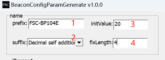

Custom Device Name Generation
Generation Rules:
  1. Fixed name prefix.
  2. Name suffix generation rules: Decimal auto-increment, Hexadecimal auto-increment, Base36 auto-increment.
  3. Initial value of the name suffix.
  4. Required number of digits for the suffix.

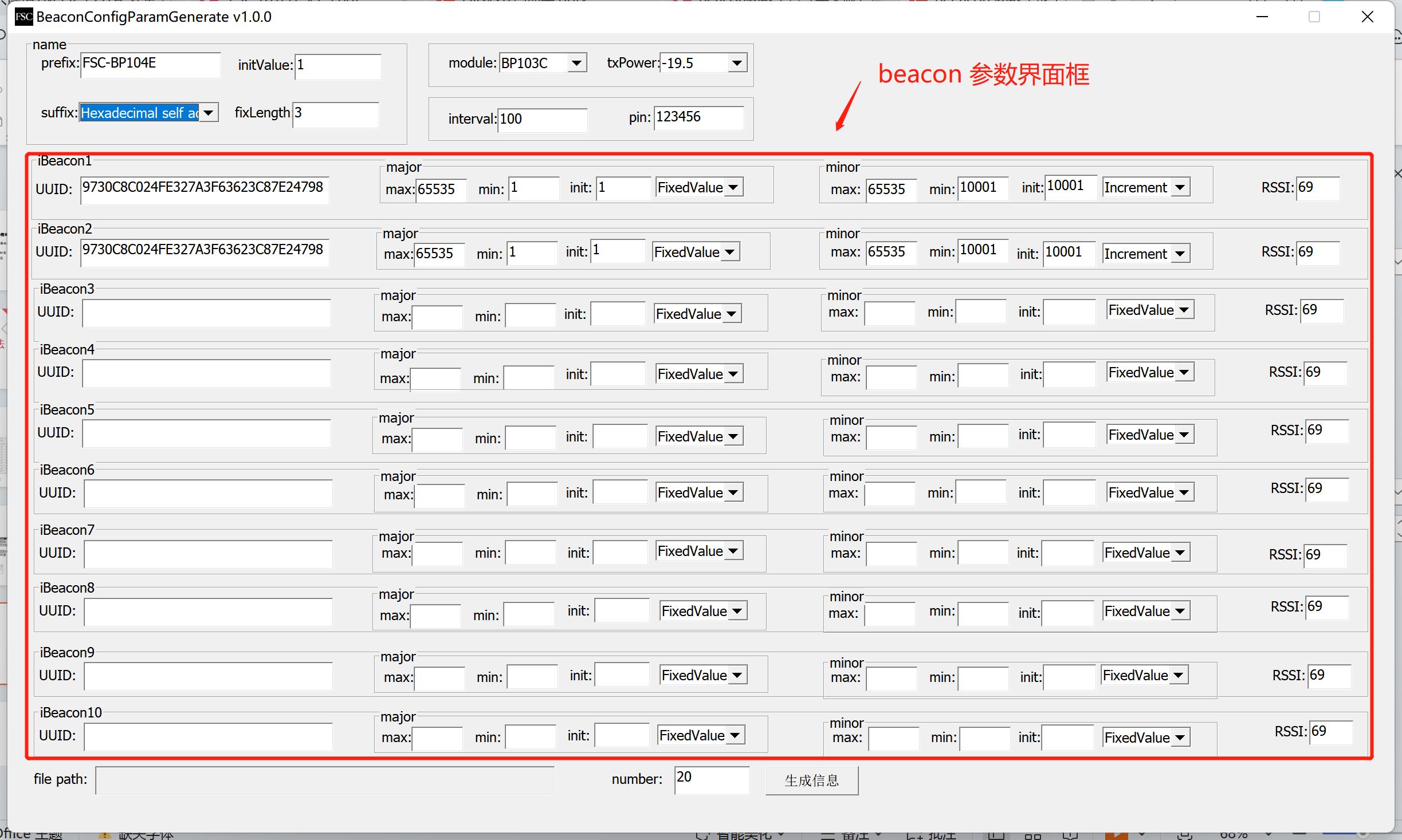

Generating iBeacon Parameters
  1. UUID generation rule: Fixed UUID
  2. major&minor generation rules:
    • FixedValue (Fixed Value)
    • Increment (Auto-increment)
  3. max: Maximum value
  4. min: Minimum value
  5. int: Initial value
  6. rssi generation rule: Fixed rssi

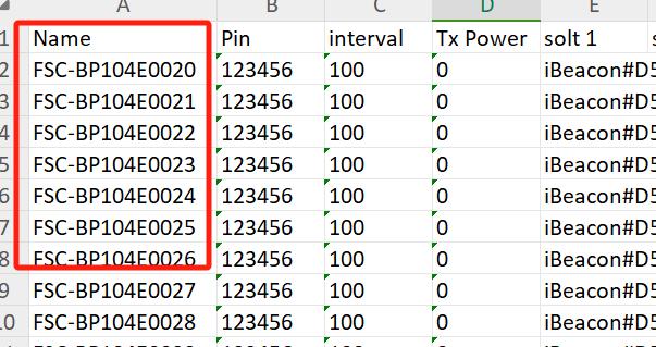

There are 1000 modules, with names ranging from FSC-BP104E0020 to FSC-BP104E1019. Examples are listed as follows:
FSC-BP104E0020 FSC-BP104E0021 … FSC-BP104E1018 FSC-BP104E1019
Requirement Analysis
According to the naming rules, the customer’s requirement can be parsed into two parts for the module names: a fixed prefix “FSC-BP104E” and a variable 4-digit suffix. The suffix starts with an initial value of 20 and increments in decimal format. The name suffix must be 4 digits long, with leading zeros added if it has fewer than 4 digits.
Tool Configuration
Parameter Generation

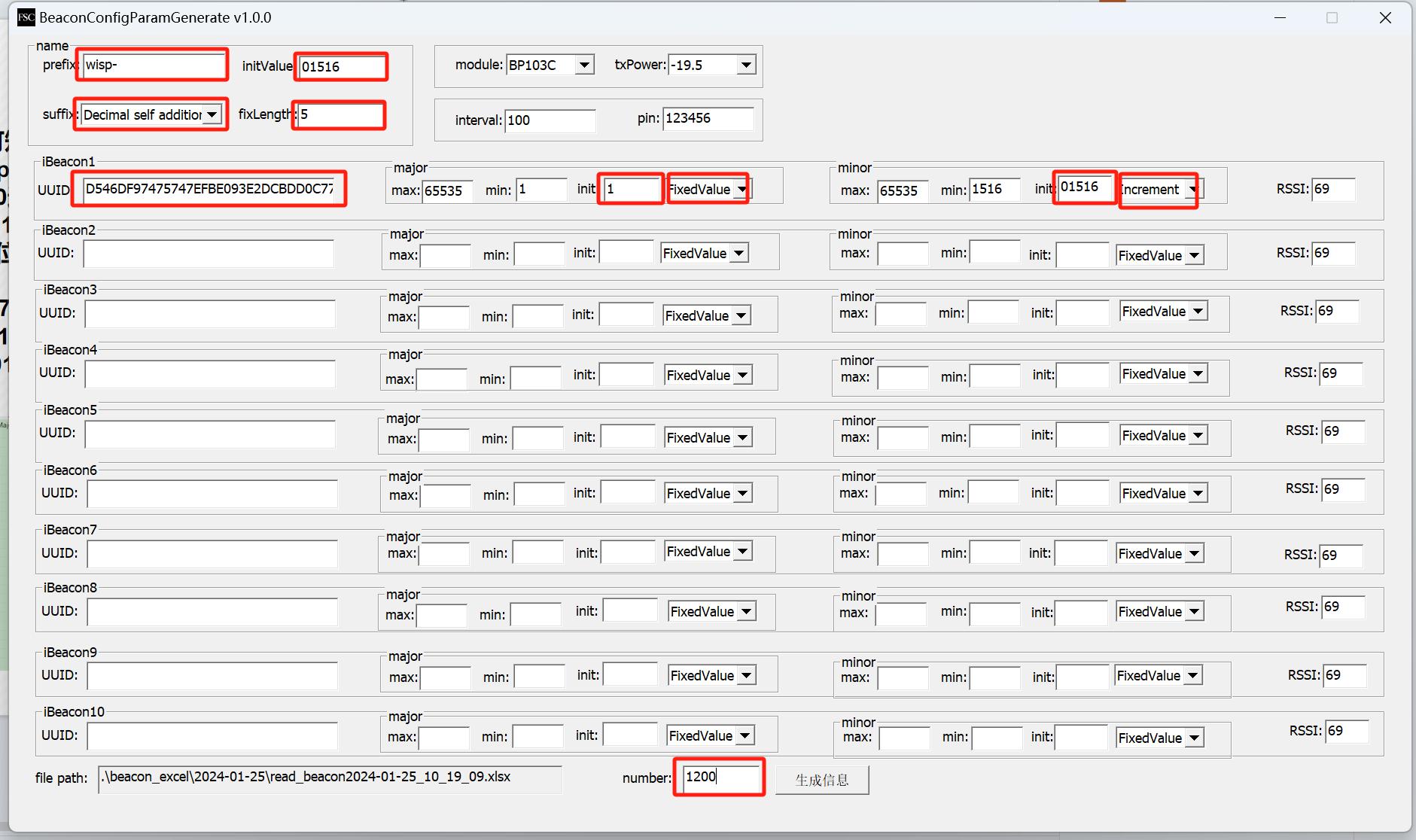

Case 2

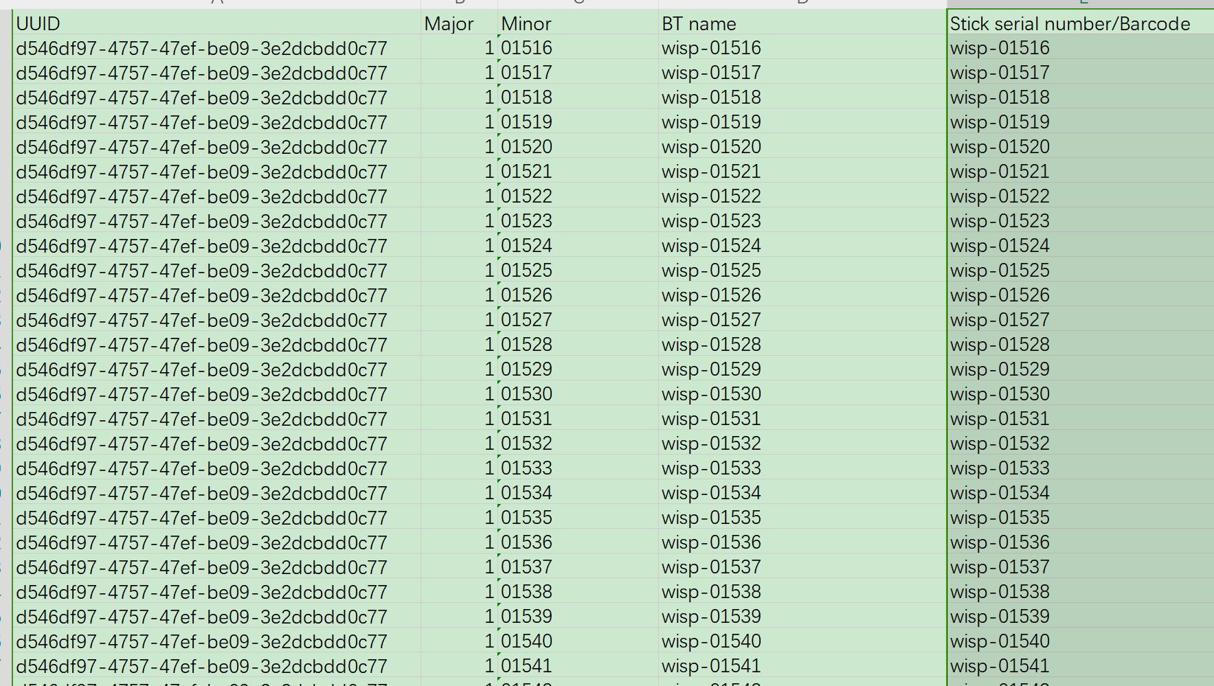

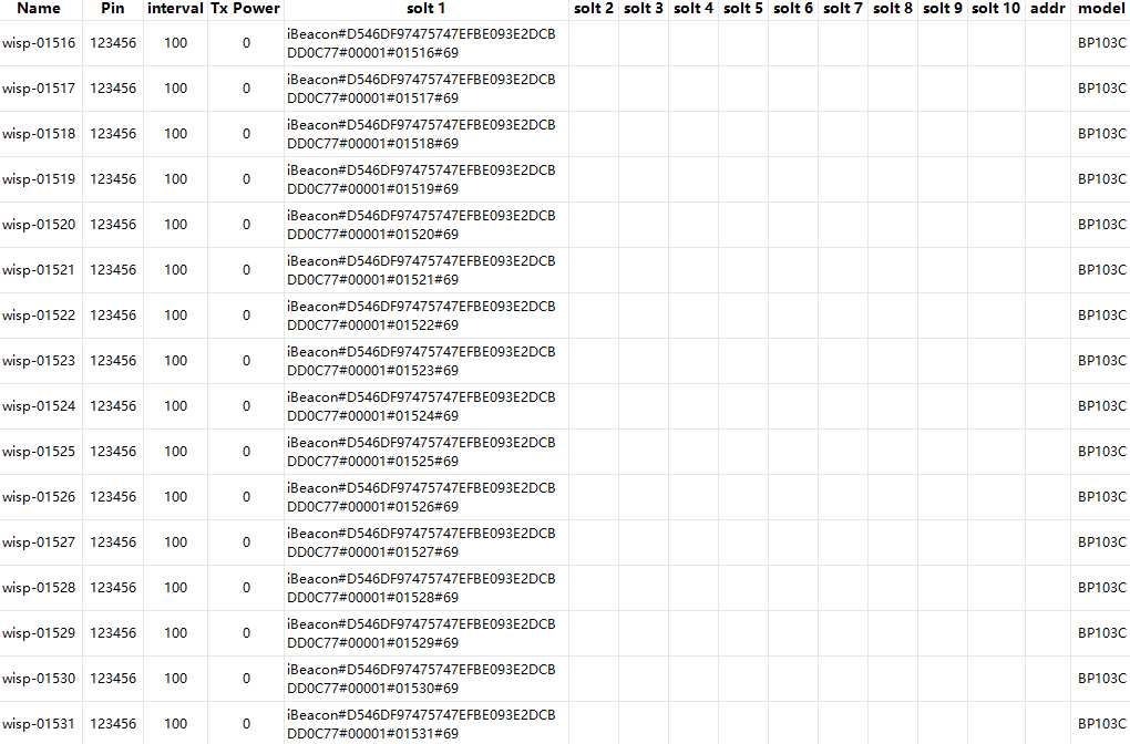

Case Requirements
  • Name prefix: wisp-
  • Suffix rules: Decimal auto-increment, initial value is 01516, retain 5 digits.
  • UUID: D546DF97475747EFBE093E2DCBDD0C77
  • Major: Fixed value 1.
  • Minor: Initial value is 01516, auto-increment, quantity is 1200.
Tool Configuration
