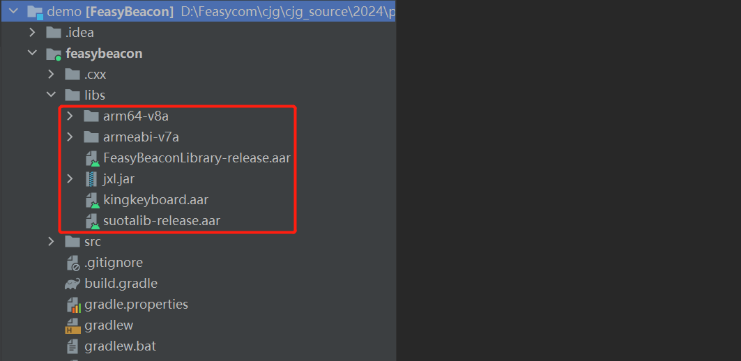

Quick Integration (Android)
Integrate the SDK
  • If you haven’t installed Android Studio yet, please visit the Android Studio
Create an Android Project
  • Create a new project in Android Studio.
Place FeasyBeaconLibrary-release.aar, suotalib-release.aar, and so libraries in the project’s libs directory
Config build.gradle
  dependencies {
    implementation fileTree(include: ['*.jar','*.aar'], dir: 'libs')
