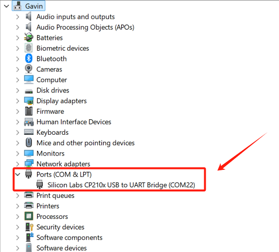

1.Connect the FSC-DB005-BT826F to the PC via USB. The PC will automatically recognize the serial port and create a virtual COM port.
pc_com_port

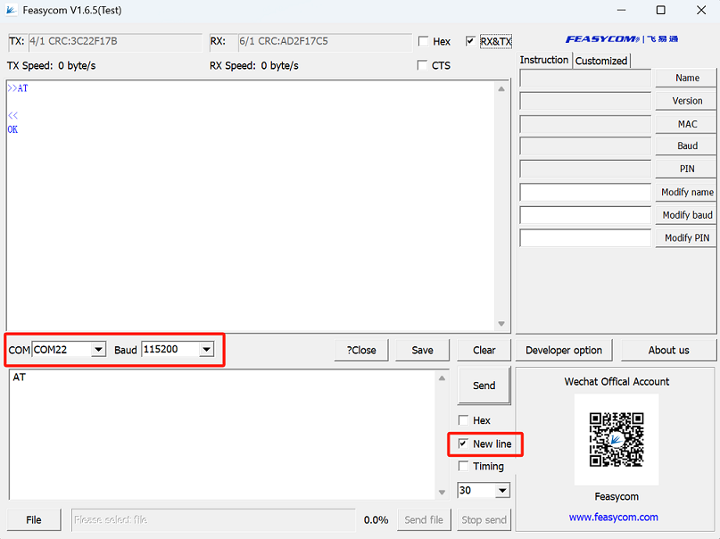

at
Communication Test
For more AT commands, please refer to FSC-BT826x General Dual-Mode Data AT Command Set .
Send:     <<AT\r\n
Response: >>r\nOK\r\n                 //Successfully connected.
Example: Read Local BR/EDR Bluetooth Name
Send:     <<AT+NAME\r\n
Response: >>\r\n+NAME=FSC-BT826F-xxxx\r\n   //Example, please refer to the actual reading
Response: >>\r\nOK\r\n
Example: Read Local BLE Name
Send:     <<AT+LENAME\r\n
Response: >>\r\n+NAME=FSC-BT826F-LE-xxxx\r\n   //Example, please refer to the actual reading
Example: Read Current Firmware Version
Send:     <<AT+VER\r\n
Response: >>\r\n+VER=1.0.0,FSC-BT826F\r\n    //Example, please refer to the actual reading
