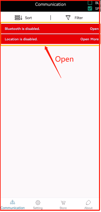

The phone needs to turn on Bluetooth & Location , otherwise FeasyBlue will not be able to scan nearby Bluetooth devices. Take Android as an example:
figure (Click to enlarge)

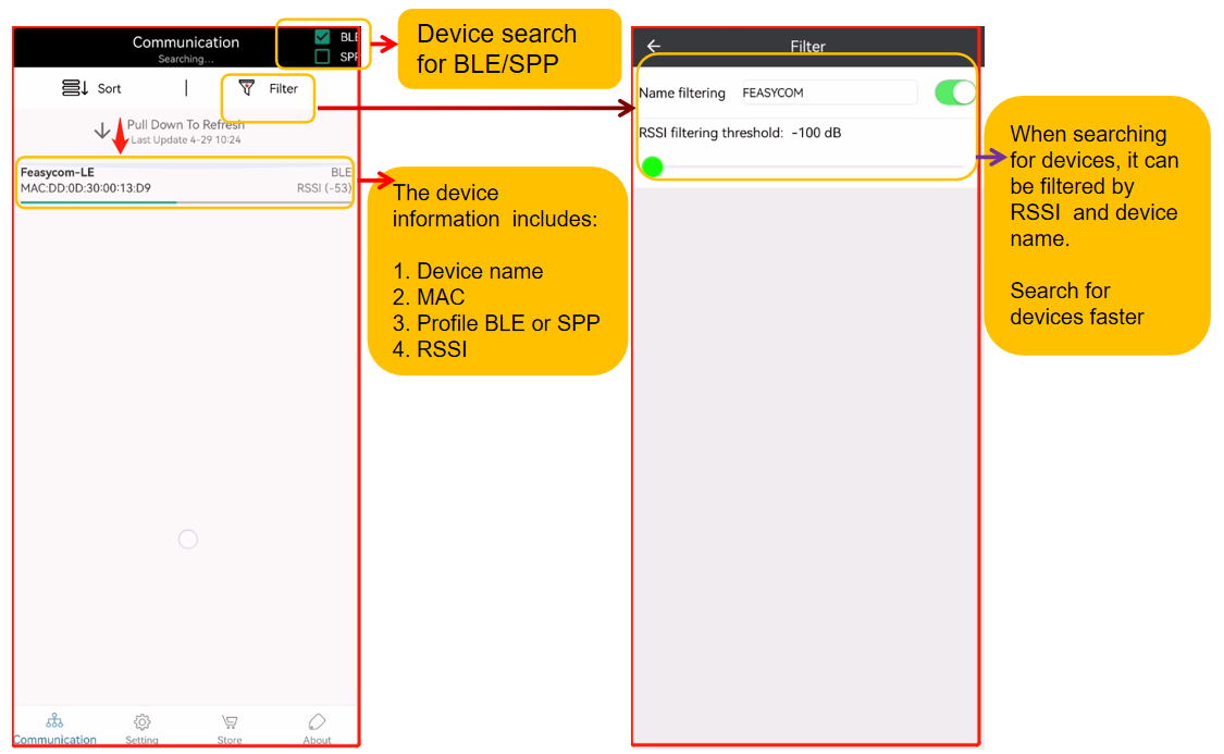

Quickly search devices

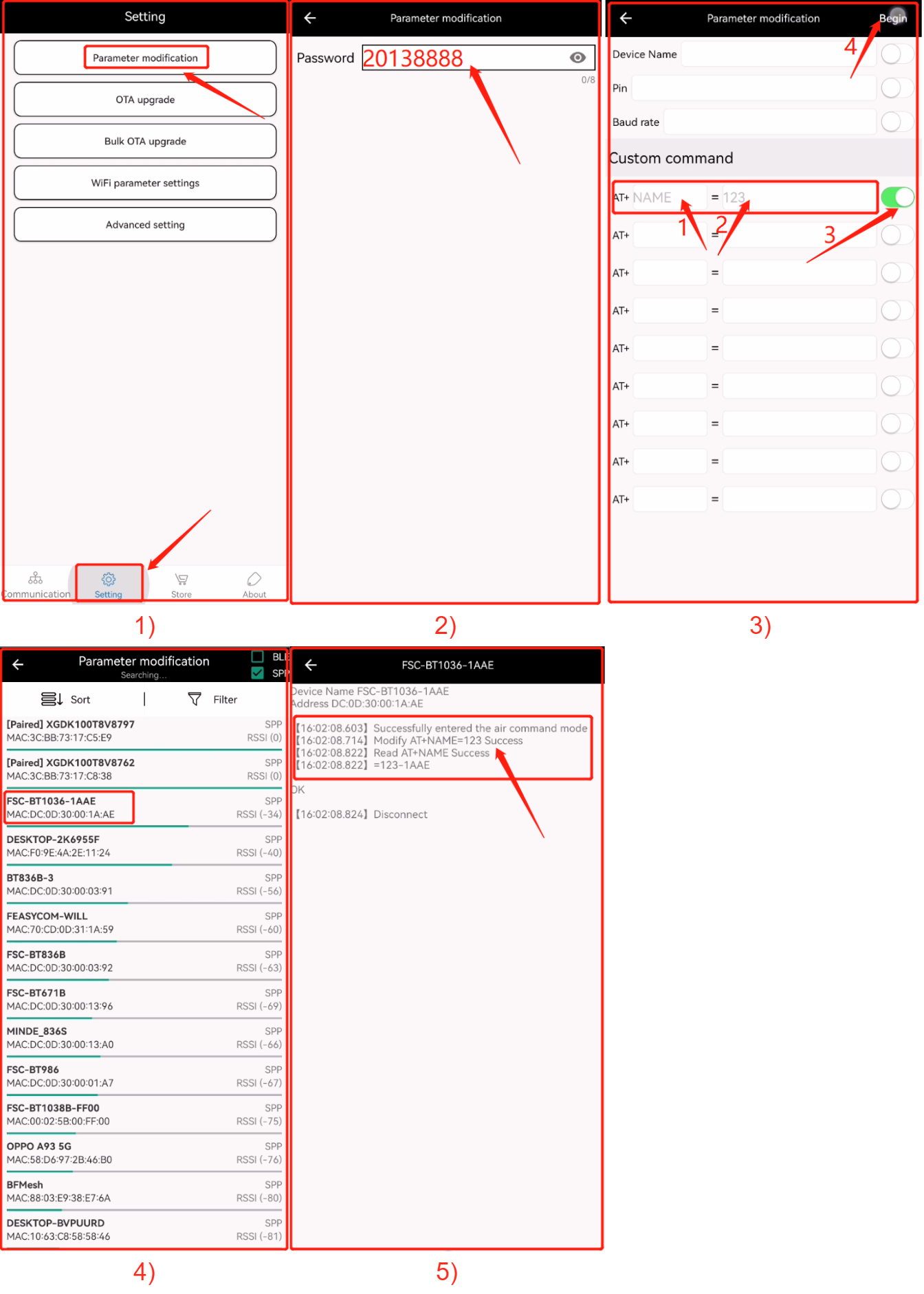

Parameter modification
FeasyBlue already supports air command mode, which supports the use of AT commands to read and configure parameters of the module.
  1. Open FeasyBlue, select “ Settings “ - “ Parameter Modification “ .
  2. Input password 20138888 .
  3. Parameter modification
    Example: Change module’s BR/EDR local name to “ABC”: Enter AT+NAME=123 in the custom comand , select this item, and Begin
  4. Select the device
  5. Enter air command mode, parameter modification is successful

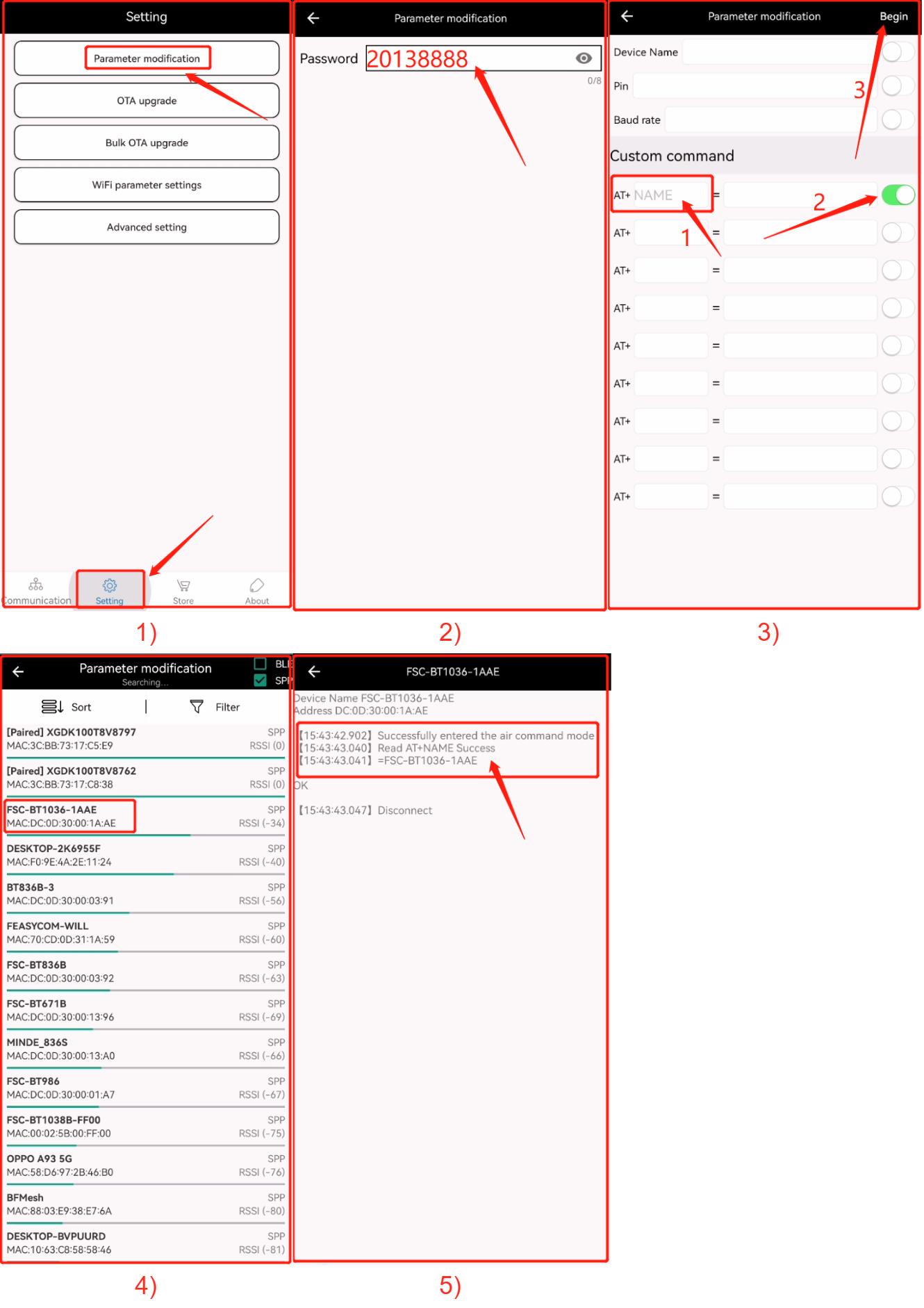

Read configuration parameter
    Example: Read current BR/EDR local name: Enter AT+NAME in the custom comand , select this item, and Begin
  5. Enter air command mode, parameter reading is successful

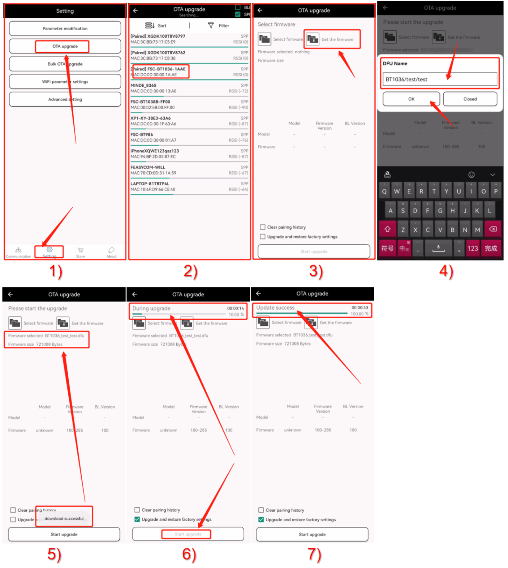

FeasyBlue already supports over-the-air upgrade function that can update the firmware of Bluetooth devices through Bluetooth data transmission.
Input DFU name, get the firmware remotely and OTA
  1. Open FeasyBlue, Select “ Setting “ - “ OTA uupgrade “;
  2. Select the Bluetooth device to be upgraded;
    Tips: You can specify the device name through the “ Filter “ function, or set the Rssi value to quickly find the device.
  3. Click “Get Firmware” and enter the complete upgrade path in the pop-up “DFU name” window;
  4. Enter the “Upgrade Path” and click “OK” when the input is complete.
  5. After the firmware is obtained successfully, the downloaded firmware name will be displayed in “ Firmware Selected “ and “ Download Successful “ will be prompted. Then click “ Start Upgrade “ to start the upgrade;
  6. To enter the upgrade mode, the Bluetooth of the mobile phone needs to be connected and paired with the Bluetooth module. When the system “Bluetooth Pairing Request” appears, please click “Pair”, otherwise it will result in the inability to enter the upgrade mode;
  7. Start the upgrade, the firmware enters “upgrading”, and the upgrade progress bar is displayed;
  8. When the interface progress bar displays “100%” and “Upgrade successful”, OTA is completed.

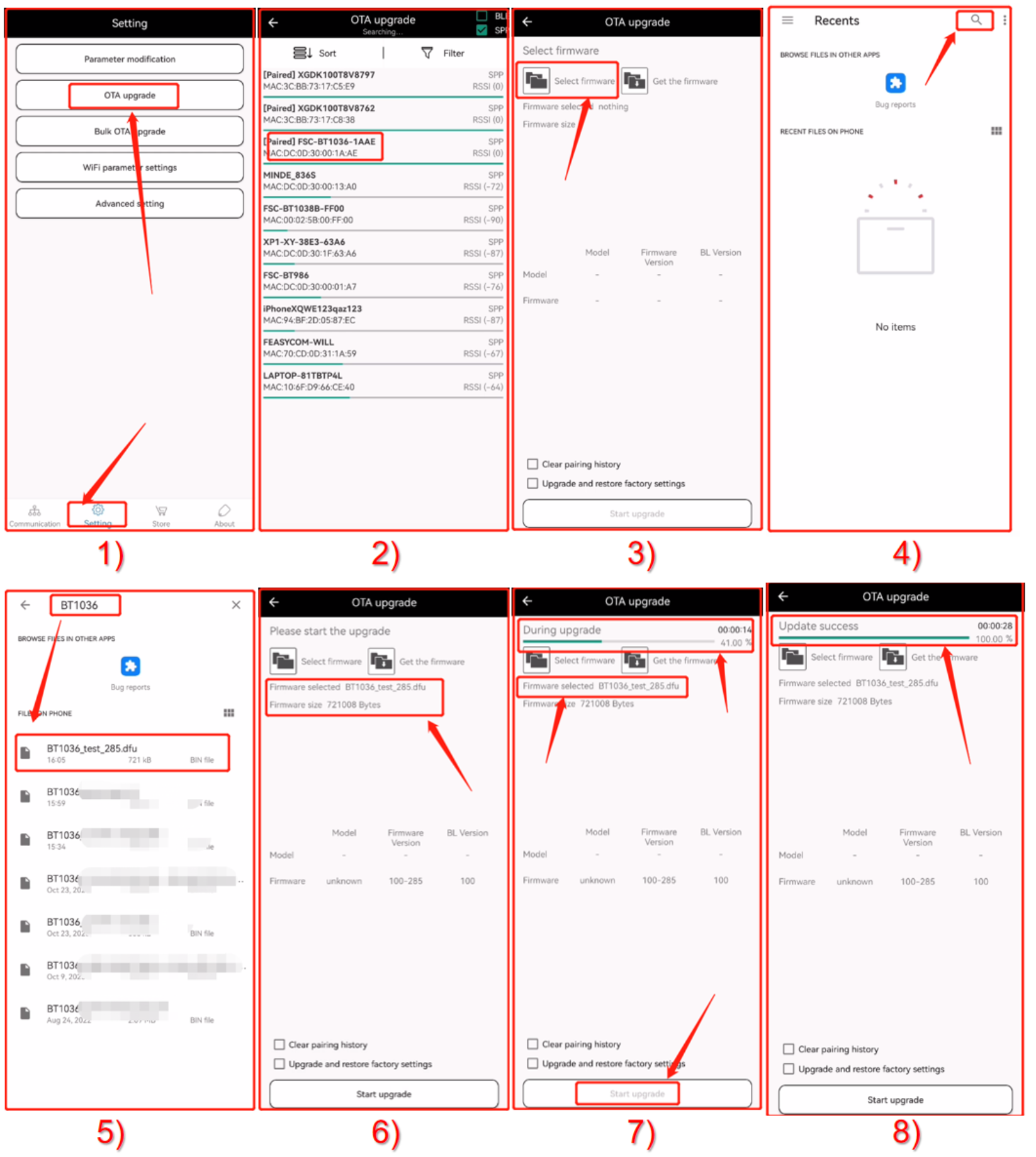

Select local firmware file and OTA
  3. Click “ Select Firmware “ ;
  4. select local firmware file;
  5. Click “ Start Upgrade “ ;

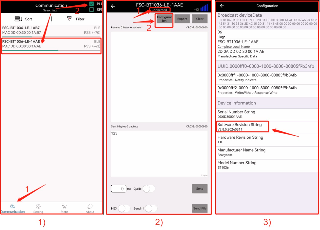

Via configure parameters for BLE
  1. Open FeasyBlue, Select “ Communication “ - “ BLE “;
  2. Search and connect device, When it shows that it is connected, click Configuration .
  3. In the configuration , you can obtain firmware version.
