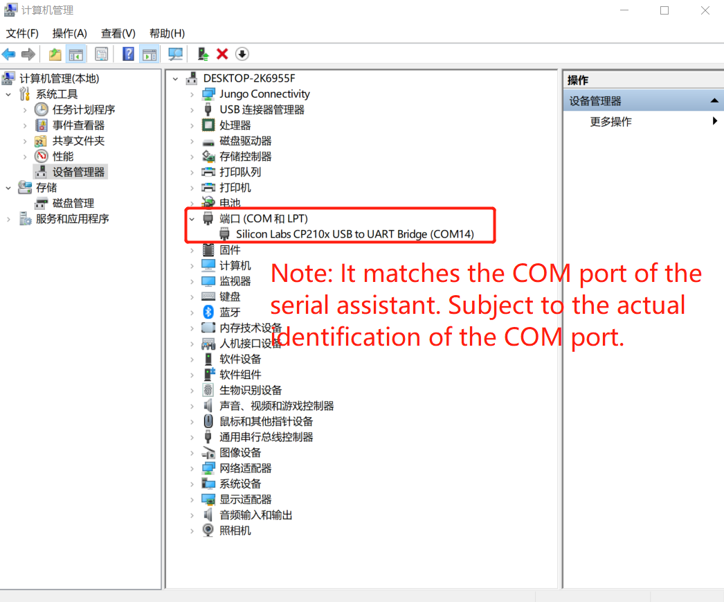

Serial driver and COM recognition
  1. Connect the USB port of the Feasycom development board, such as FSC-DB005/DB006/DB008/DB200/othe, to the USB port of the computer, the LED indicator light flashes slowly (general program), and the module is searchable and connectable (when the Bluetooth module and other Bluetooth devices establish a Bluetooth connection successfully, the LED will be on normally);
  2. Before development, debugging and use, you need to let the PC recognize the COM port of the device, that is, you need to install the driver. After the driver is successfully installed, you can view it in the PC device manager.
figure (Click to enlarge)

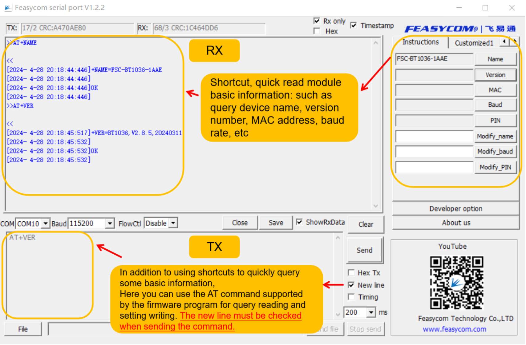

2、Send AT command
