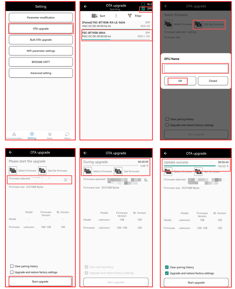

1.Run the FeasyBlue App, select Setting - OTA Upgrade to enter the OTA Upgrade function section. After entering, it will redirect to the device search interface where you can select the Bluetooth device to be upgraded.
2.Scan and select the Bluetooth devices that need to be upgraded. After selecting the device, you will enter the Firmware Loading interface to load the firmware upgrade file.
3.There are two ways to load the firmware upgrade file:
  • Select firmware: Choose to load the firmware upgrade file stored locally on the phone (the firmware upgrade file is provided by Feasycom).
  • Get the firmware: By entering the DFU name, the corresponding firmware upgrade file can be downloaded and imported from the Feasycom cloud server via the network (the DFU name is provided by Feasycom).
4.After successfully loading the firmware file, click the Start Upgrade button. The message “Upgrading” and the upgrade progress will be displayed, indicating that the upgrade mode has been successfully entered and the upgrade is in progress.
5.Wait for the upgrade progress bar to complete and display “Upgrade Completed”, then the upgrade is considered complete.
