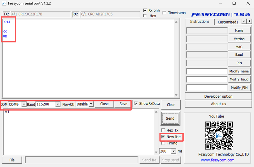

1.Connect FSC-DB200-BT1058 to PC via USB To Type-C cable, switch the UART/USB toggle to UART, press the USB/battery power option button to switch to USB power supply, Press and hold the ON/OFF button for 2-3 seconds to turn on the device, and the PC will automatically recognize the serial port and generate a virtual COMx port.
Communication test
For more AT commands, please refer to FSC-BT1058 General Audio AT Commands Set .
Send:     >>AT\r\n
Response: <<r\nOK\r\n                 //Successfully connected.
Send:     >>AT+NAME\r\n
Response: <<\r\n+NAME=FSC-BT1058-0043\r\n         //Example, please refer to the actual reading
Response: <<\r\nOK\r\n
