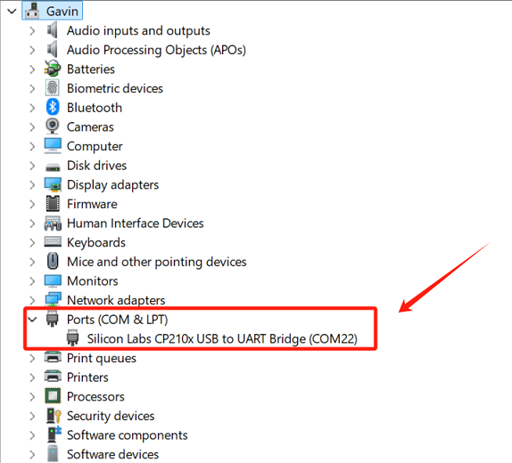

1.Connect the FSC-DB005-BT9101AI to the PC via USB. The PC will automatically recognize the serial port and generate a virtual COM port.

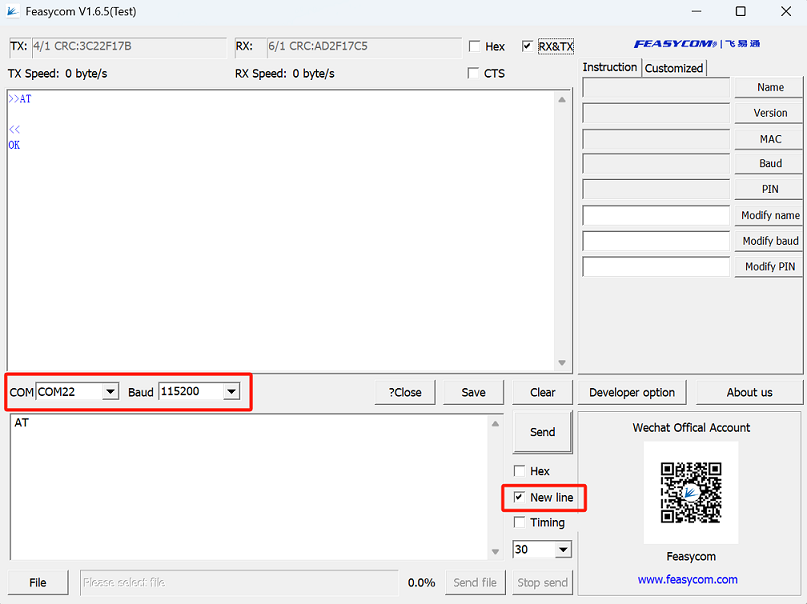

Communication Test
For more AT commands, please refer to FSC-BT910x General Dual-Mode Data AT Command Set .
send:     >>AT\r\n
response: <<\r\nOK\r\n   //Successfully connected.
