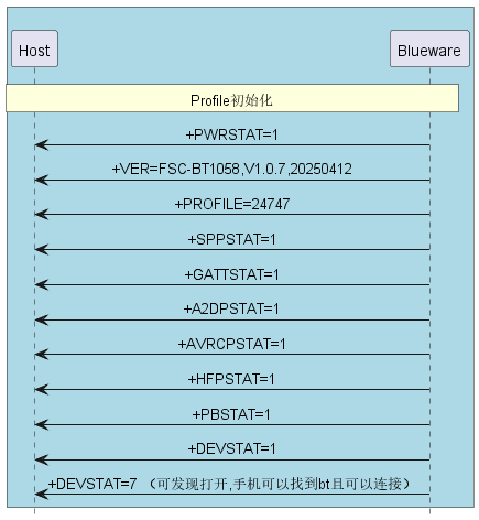

Profile初始化
下图展示了Profile初始化:
box  #LightBlue
participant Blueware as bt
rnote over host, bt: Profile初始化
bt -> host: +PWRSTAT=1
bt -> host: +VER=FSC-BT1058,V1.0.7,20250412
bt -> host: +PROFILE=24747
bt -> host: +SPPSTAT=1
bt -> host: +GATTSTAT=1
bt -> host: +A2DPSTAT=1
bt -> host: +AVRCPSTAT=1
bt -> host: +HFPSTAT=1
bt -> host: +PBSTAT=1
bt -> host: +DEVSTAT=1
bt -> host: +DEVSTAT=7 (可发现打开,手机可以找到bt且可以连接)

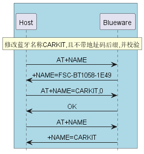

修改参数
下图展示修改设备名为CARKIT的过程:
box  #LightBlue
rnote over host, bt: 修改蓝牙名称CARKIT,且不带地址码后缀,并校验
host -> bt: AT+NAME
bt -> host: +NAME=FSC-BT1058-1E49
host -> bt: AT+NAME=CARKIT,0
bt -> host: OK
host -> bt: AT+NAME
bt -> host: +NAME=CARKIT
MCU 修改任何参数前,建议先查询再修改最后校验。MCU 修改设备名为 CARKIT 参考代码示例如下:
 1void change_name(void)
 2{
 3    uart_send("AT+NAME\r\n");
 4    if(uart_read("+NAME",name_buf))
 5    {
 6        if(memcmp(name_buf,"CARKIT",6))
 7        {
 8            uart_send("AT+NAME=CARKIT,0\r\n");      //defalut disable MAC address suffix
 9            uart_send("AT+NAME\r\n"); // read bt name
10            if(uart_read("+NAME",name_buf))
11            {
12                if(memcmp(name_buf,"CARKIT",6))
13                {
14                    //change name fail
15                }
16                else
17                {
18                    //change name success
19                }
20            }
21        }
22    }
23}

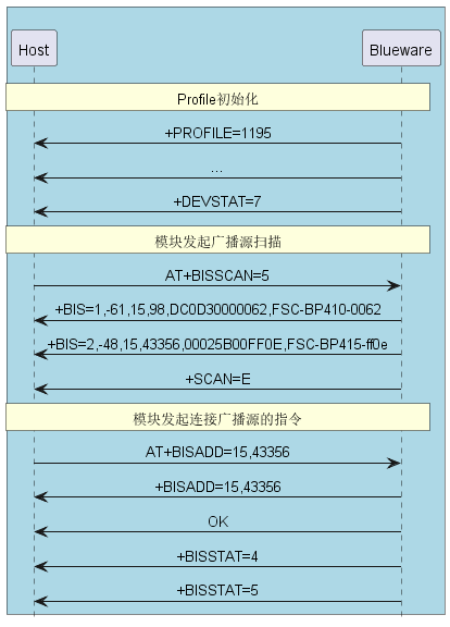

LE Audio Broadcast 扫描连接
box  #LightBlue
bt -> host: +PROFILE=1195
bt -> host: ...
rnote over host, bt: 模块发起广播源扫描
host -> bt: AT+BISSCAN=5
bt -> host: +BIS=1,-61,15,98,DC0D30000062,FSC-BP410-0062
bt -> host: +BIS=2,-48,15,43356,00025B00FF0E,FSC-BP415-ff0e
bt -> host: +SCAN=E
rnote over host, bt: 模块发起连接广播源的指令
host -> bt: AT+BISADD=15,43356
bt -> host: +BISADD=15,43356
bt -> host: OK
bt -> host: +BISSTAT=4
bt -> host: +BISSTAT=5

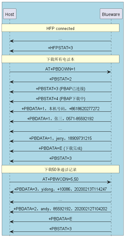

Phonebook下载
box  #LightBlue
rnote over host, bt: HFP connected
bt -> host: ...
bt -> host: +HFPSTAT=3
rnote over host, bt: 下载所有电话本
host -> bt: AT+PBDOWN=1
bt -> host: +PBSTAT=2
bt -> host: +PBSTAT=3 (PBAP已连接)
bt -> host: +PBSTAT=4 (PBAP下载中)
bt -> host: +PBDATA=1,本机号码,+8618620277272
bt -> host: +PBDATA=1,张三,0571-85592192
bt -> host: ...
bt -> host: +PBDATA=1,jerry,18909731215
bt -> host: +PBDATA=E (下载完成)
rnote over host, bt: 下载50条通话记录
host -> bt: AT+PBWODN=5,50
bt -> host: +PBDATA=3,yidong,+10086,20200213T114247
bt -> host: ...
bt -> host: +PBDATA=2,andy,85592192,20200212T104202

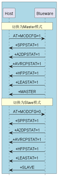

设备模式切换
box  #LightBlue
rnote over host, bt:切换为Master模式
host -> bt: AT+MODCFG=1
bt -> host: +LEASTAT=1
bt -> host: +MASTER
rnote over host, bt:切换为Slave模式
host -> bt: AT+MODCFG=0
bt -> host: +SLAVE

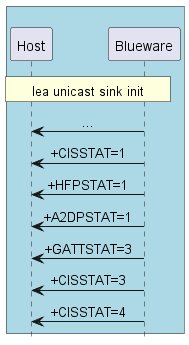

LEA中Unicast作为sink交互
box  #LightBlue
rnote over host, bt:lea unicast sink init
bt -> host: ...
bt -> host: +CISSTAT=1
bt -> host: +GATTSTAT=3
bt -> host: +CISSTAT=3
bt -> host: +CISSTAT=4
