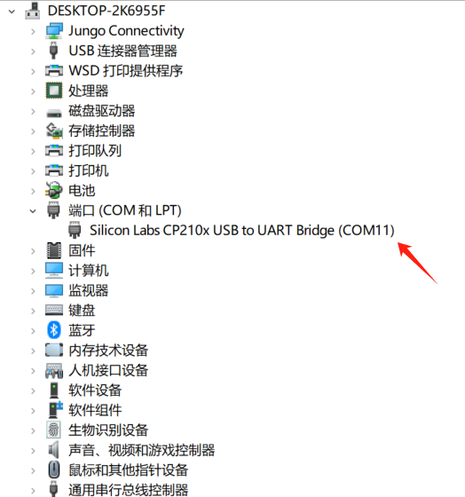

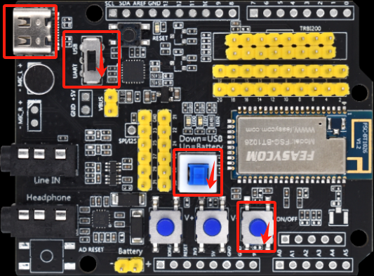

  1. Connect FSC-DB200-BT1026C to PC via USB To Type-C cable, switch the UART/USB toggle to UART,Press the USB/battery power option button to switch to USB power supply, Press and hold the ON/OFF button for 3 seconds to turn on the device, and the PC will automatically recognize the serial port and generate a virtual COMx port.

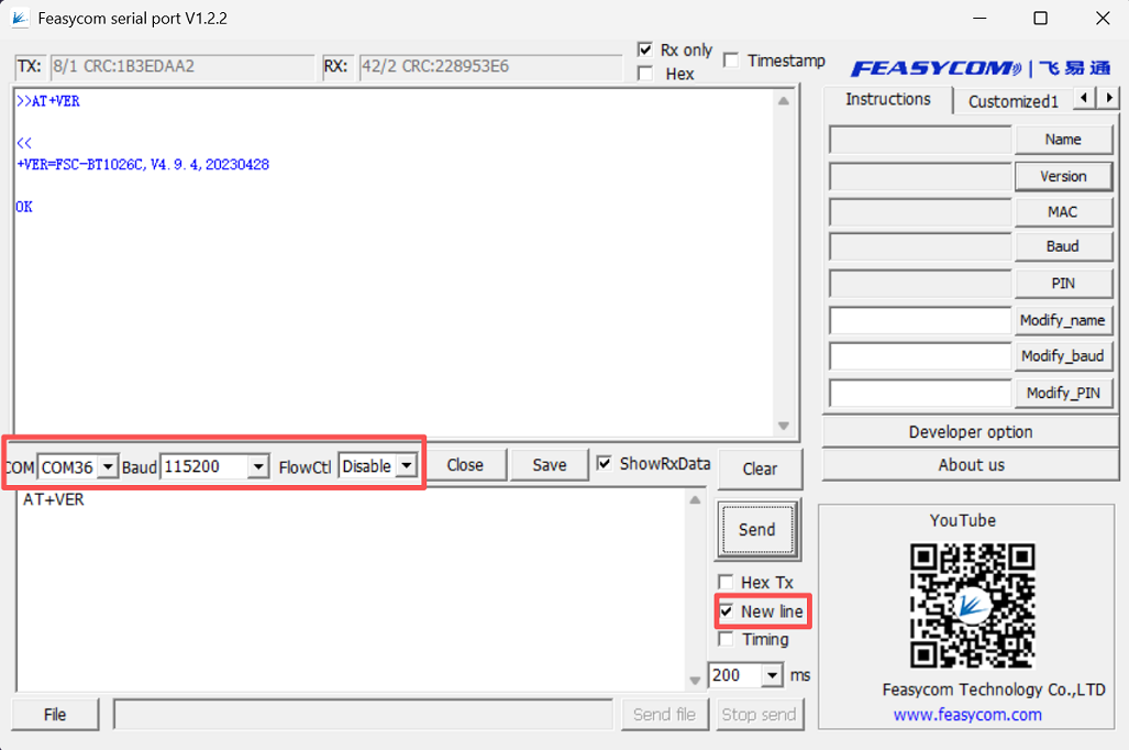

  1. Run the Feasycom Serial Port Tool on the PC, set the correct COM and Baud, and check the New Line.

Send:     >>AT\r\n
Response: <<\r\nOK\r\n    //Successfully connected.
Send:     >>AT+NAME\r\n
Response: <<\r\n+NAME=FSC-BT1026C\r\n       //Example, please refer to the actual reading
Send:     >>AT+LENAME\r\n
Response: <<\r\n+LENAME=FSC-BT1026C-LE\r\n     //Example, please refer to the actual reading
AT+VER - Read the Current Firmware Version
Send:     >>AT+VER\r\n
Response: <<\r\n+VER=FSC-BT1026C,V4.9.4\r\n   //Example, please refer to the actual reading result
