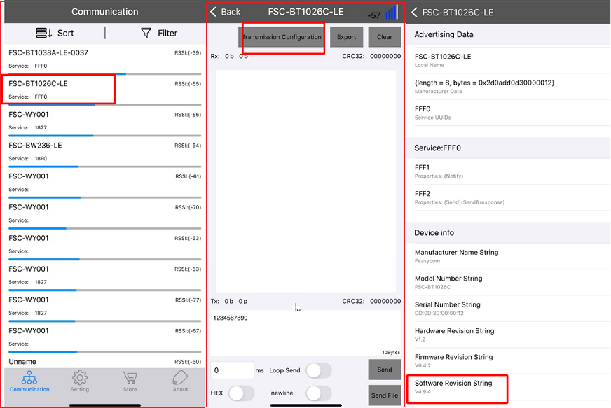

Obtain Firmware Version
FeasyBlue APP
After establishing BLE connection with the FSC-BT1026x through FeasyBlue APP, check the firmware version information on the Transmission Configuration function interface.
Warning:The profile of the Bluetooth module needs to enable BLE (GATT) function
