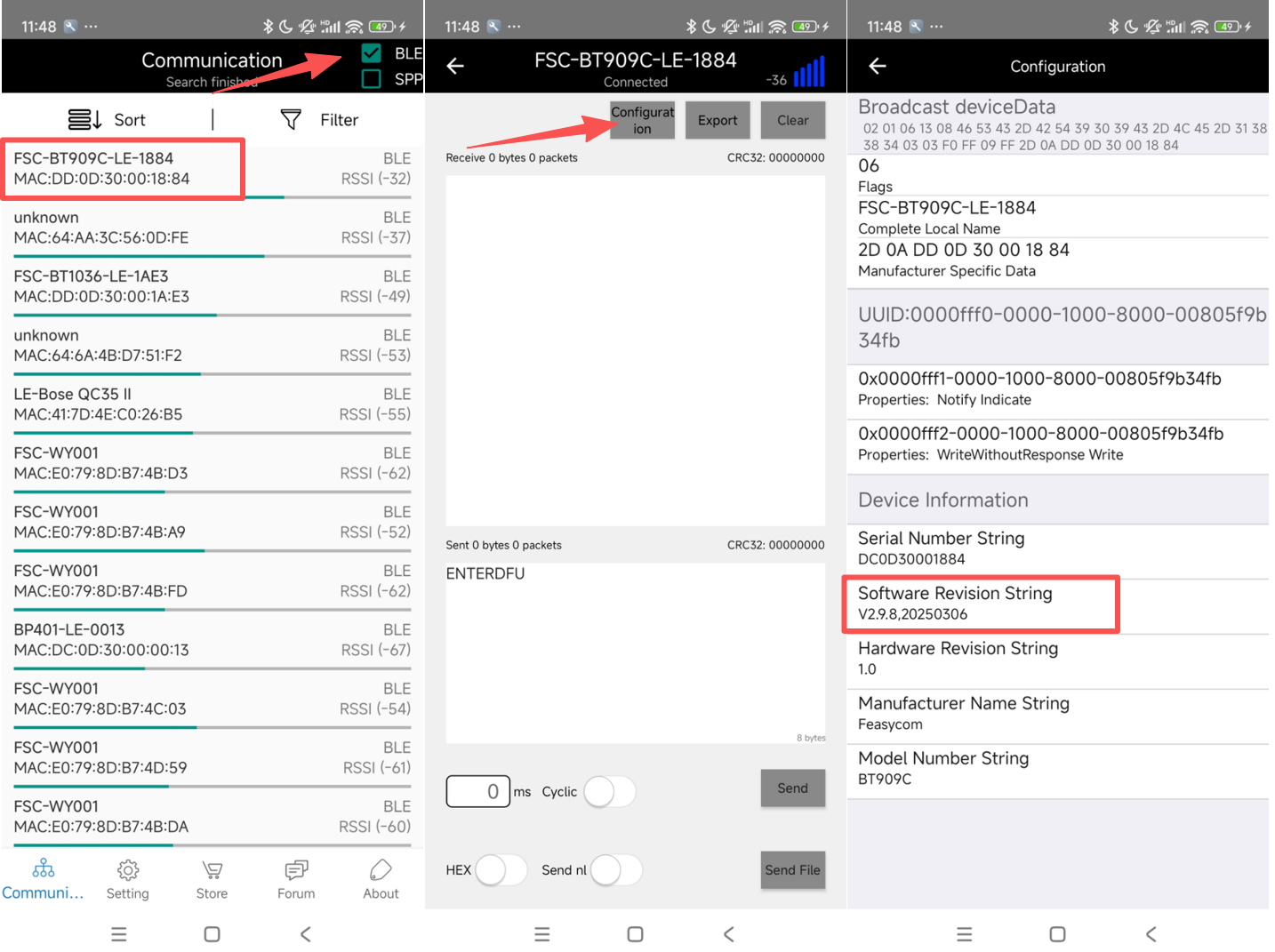

Obtain Firmware Version
FeasyBlue App
After establishing BLE connection between the FeasyBlue App and the FSC-BT909C , check the firmware version information on the Configuration page.
The profile of the Bluetooth module needs to enable the BLE (GATT) profile.
