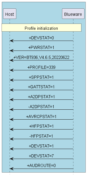

Profile Initialization
Module Profile initialization, examples:
box  #LightBlue
participant Blueware as bt
rnote over host, bt: Profile initialization
bt -> host: +DEVSTAT=0
bt -> host: +PWRSTAT=1
bt -> host: +VER=BT936,V4.6.5,20220622
bt -> host: +PROFILE=339
bt -> host: +SPPSTAT=1
bt -> host: +GATTSTAT=1
bt -> host: +A2DPSTAT=1
bt -> host: -A2DPSTAT=1
bt -> host: +AVRCPSTAT=1
bt -> host: +HFPSTAT=1
bt -> host: -HFPSTAT=1
bt -> host: +DEVSTAT=1
bt -> host: +DEVSTAT=7
bt -> host: +AUDROUTE=0

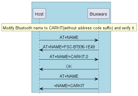

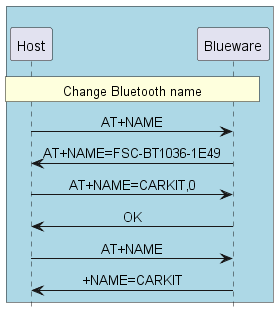

Modify Bluetooth Name
Modify Name. Examples of AT command operations and response events are as follows:
box  #LightBlue
rnote over host, bt: Modify Bluetooth name to CARKIT(without address code suffix) and verify it.
host -> bt: AT+NAME
bt -> host: AT+NAME=FSC-BT936-1E49
host -> bt: AT+NAME=CARKIT,0
bt -> host: OK
host -> bt: AT+NAME
bt -> host: +NAME=CARKIT
Before the MCU modifies any parameters, it is recommended to first query, then modify, and finally verify. For the MCU to modify the device name to CARKIT, the reference code example is as follows:
void change_name(void)
    uart_send("AT+NAME\r\n");
    if(uart_read("+NAME",name_buf))
        if(memcmp(name_buf,"CARKIT",6))
            uart_send("AT+NAME=CARKIT,0\r\n");  //defalut disable MAC address suffix
            uart_send("AT+NAME\r\n"); // read bt name
                    //change name fail
                else
                    //change name success

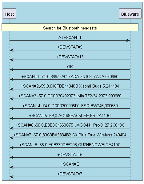

Search for Bluetooth headsets
box  #LightBlue
rnote over host, bt: Search for Bluetooth headsets
host -> bt: AT+SCAN=1
bt -> host: +DEVSTAT=5
bt -> host: +DEVSTAT=13
bt -> host: OK
bt -> host: +SCAN=1,-71,0,86677A027ADA,ZN108_7ADA,040680
bt -> host: +SCAN=2,-59,0,648FDB44048B,Xiaomi Buds 5,244404
bt -> host: +SCAN=3,-57,0,DC0D30402073,iMin TF2-34 2073,000680
bt -> host: +SCAN=4,-74,0,DC0D300005D1,FSC-BW246,000680
bt -> host: +SCAN=5,-69,0,AC198EAC5DFE,FR,2A410C
bt -> host: +SCAN=6,-66,0,E0D8C4660C75,JMGO-N1 Pro-0127,2C043C
bt -> host: +SCAN=7,-67,0,80C3BA3834B2,CX Plus True Wireless,240404
bt -> host: +SCAN=8,-55,0,A0B339DB5208,QUZHENGWEI,2A410C
bt -> host: +SCAN=E

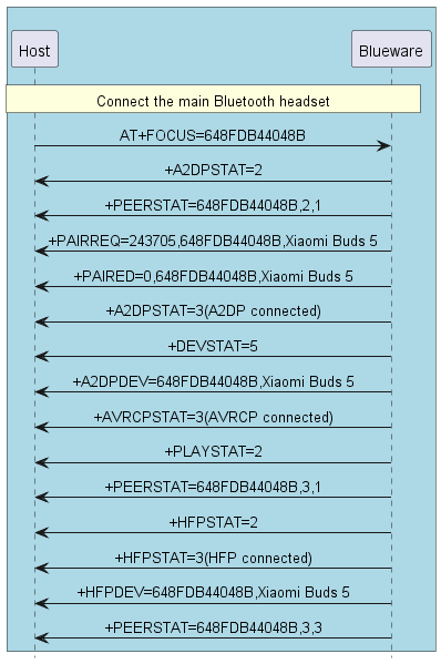

Connect the main Bluetooth headset
box  #LightBlue
rnote over host, bt: Connect the main Bluetooth headset
host -> bt: AT+FOCUS=648FDB44048B
bt -> host: +A2DPSTAT=2
bt -> host: +PEERSTAT=648FDB44048B,2,1
bt -> host: +PAIRREQ=243705,648FDB44048B,Xiaomi Buds 5
bt -> host: +PAIRED=0,648FDB44048B,Xiaomi Buds 5
bt -> host: +A2DPSTAT=3(A2DP connected)
bt -> host: +A2DPDEV=648FDB44048B,Xiaomi Buds 5
bt -> host: +AVRCPSTAT=3(AVRCP connected)
bt -> host: +PLAYSTAT=2
bt -> host: +PEERSTAT=648FDB44048B,3,1
bt -> host: +HFPSTAT=2
bt -> host: +HFPSTAT=3(HFP connected)
bt -> host: +HFPDEV=648FDB44048B,Xiaomi Buds 5
bt -> host: +PEERSTAT=648FDB44048B,3,3

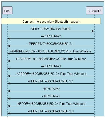

Connect the secondary Bluetooth headset
box  #LightBlue
rnote over host, bt: Connect the secondary Bluetooth headset
host -> bt: AT+FOCUS=,80C3BA3834B2
bt -> host: -A2DPSTAT=2
bt -> host: -PEERSTAT=80C3BA3834B2,2,1
bt -> host: +PAIRREQ=616247,80C3BA3834B2,CX Plus True Wireless
bt -> host: +PAIRED=0,80C3BA3834B2,CX Plus True Wireless
bt -> host: -A2DPSTAT=3
bt -> host: -A2DPDEV=80C3BA3834B2,CX Plus True Wireless
bt -> host: -PEERSTAT=80C3BA3834B2,3,1
bt -> host: -HFPSTAT=2
bt -> host: -HFPSTAT=3
bt -> host: -HFPDEV=80C3BA3834B2,CX Plus True Wireless
bt -> host: -PEERSTAT=80C3BA3834B2,3,3

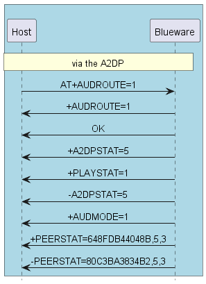

Transmit audio to the main and secondary Bluetooth headsets via the A2DP
box  #LightBlue
rnote over host, bt: via the A2DP
host -> bt: AT+AUDROUTE=1
bt -> host: +AUDROUTE=1
bt -> host: OK
bt -> host: +A2DPSTAT=5
bt -> host: +PLAYSTAT=1
bt -> host: -A2DPSTAT=5
bt -> host: +AUDMODE=1
bt -> host: +PEERSTAT=648FDB44048B,5,3
bt -> host: -PEERSTAT=80C3BA3834B2,5,3

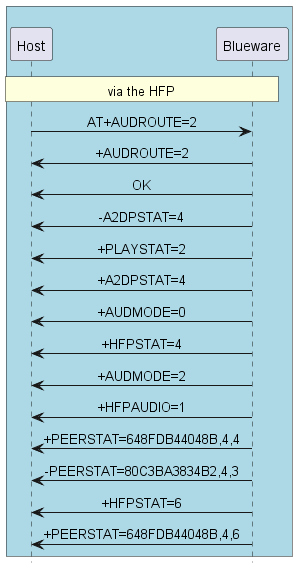

Transmit audio to the main Bluetooth headset via the HFP
box  #LightBlue
rnote over host, bt: via the HFP
host -> bt: AT+AUDROUTE=2
bt -> host: +AUDROUTE=2
bt -> host: OK
bt -> host: -A2DPSTAT=4
bt -> host: +A2DPSTAT=4
bt -> host: +AUDMODE=0
bt -> host: +HFPSTAT=4
bt -> host: +AUDMODE=2
bt -> host: +HFPAUDIO=1
bt -> host: +PEERSTAT=648FDB44048B,4,4
bt -> host: -PEERSTAT=80C3BA3834B2,4,3
bt -> host: +HFPSTAT=6
bt -> host: +PEERSTAT=648FDB44048B,4,6

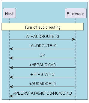

Turn off audio routing
box  #LightBlue
rnote over host, bt: Turn off audio routing
host -> bt: AT+AUDROUTE=0
bt -> host: OK
bt -> host: +HFPAUDIO=0
bt -> host: +PEERSTAT=648FDB44048B,4,3

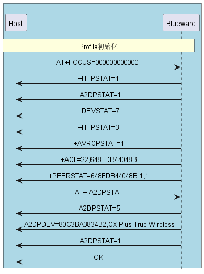

Two headsets have been connected,disconnect the main Bluetooth headset.
box  #LightBlue
rnote over host, bt: Profile初始化
host -> bt: AT+FOCUS=000000000000,
bt -> host: +ACL=22,648FDB44048B
bt -> host: +PEERSTAT=648FDB44048B,1,1
host -> bt: AT+-A2DPSTAT
bt -> host: OK

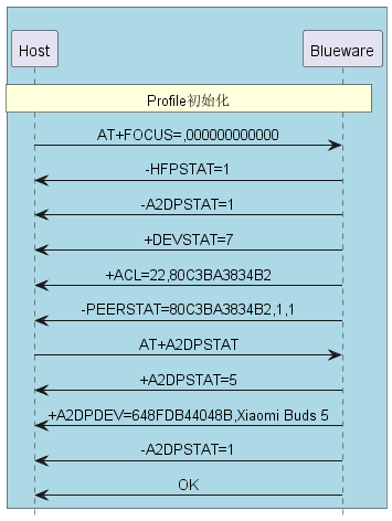

Two headsets have been connected,disconnect the secondary Bluetooth headset.
box  #LightBlue
host -> bt: AT+FOCUS=,000000000000
bt -> host: +ACL=22,80C3BA3834B2
bt -> host: -PEERSTAT=80C3BA3834B2,1,1
host -> bt: AT+A2DPSTAT
bt -> host: OK
