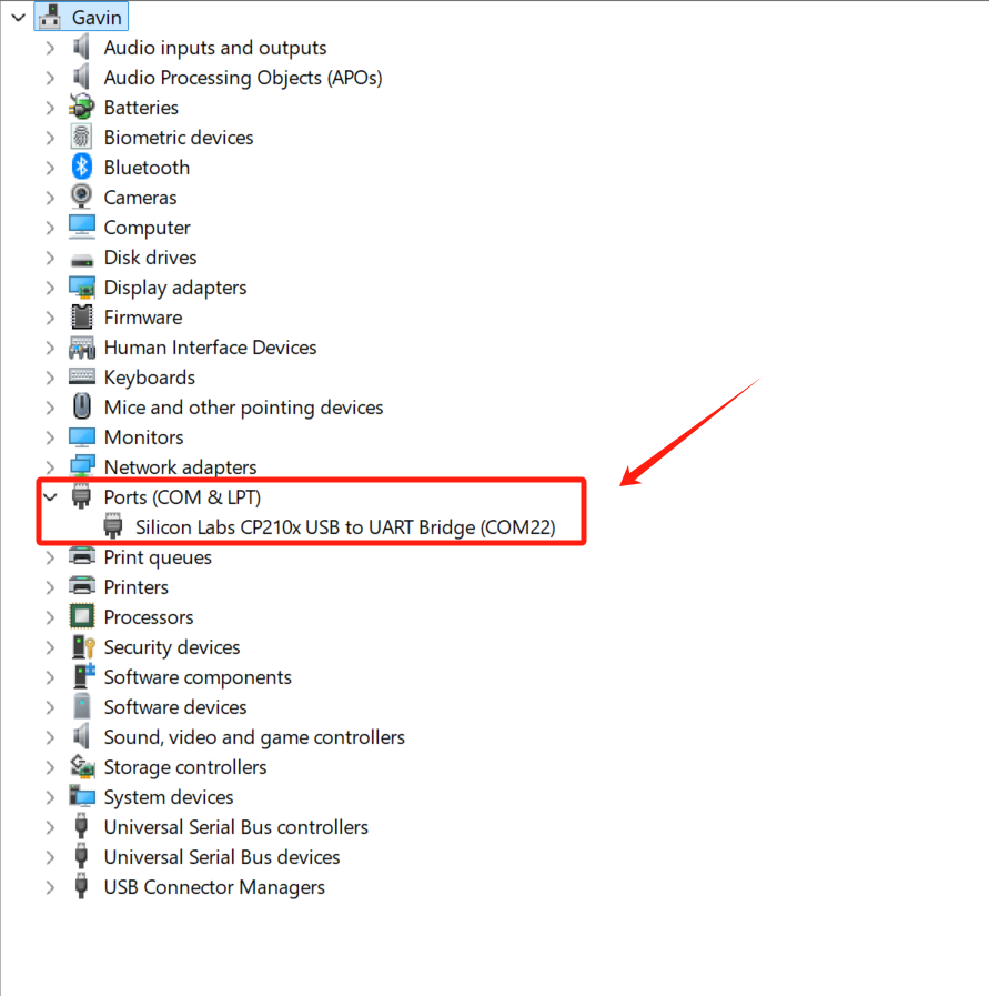

  • UART Configuration : 115200/8/N/1
1.Connect the FSC-DB008-BT936B to the PC via a USB-to-Type-C data cable. The PC will automatically recognize the serial port and generate a virtual COMx port.

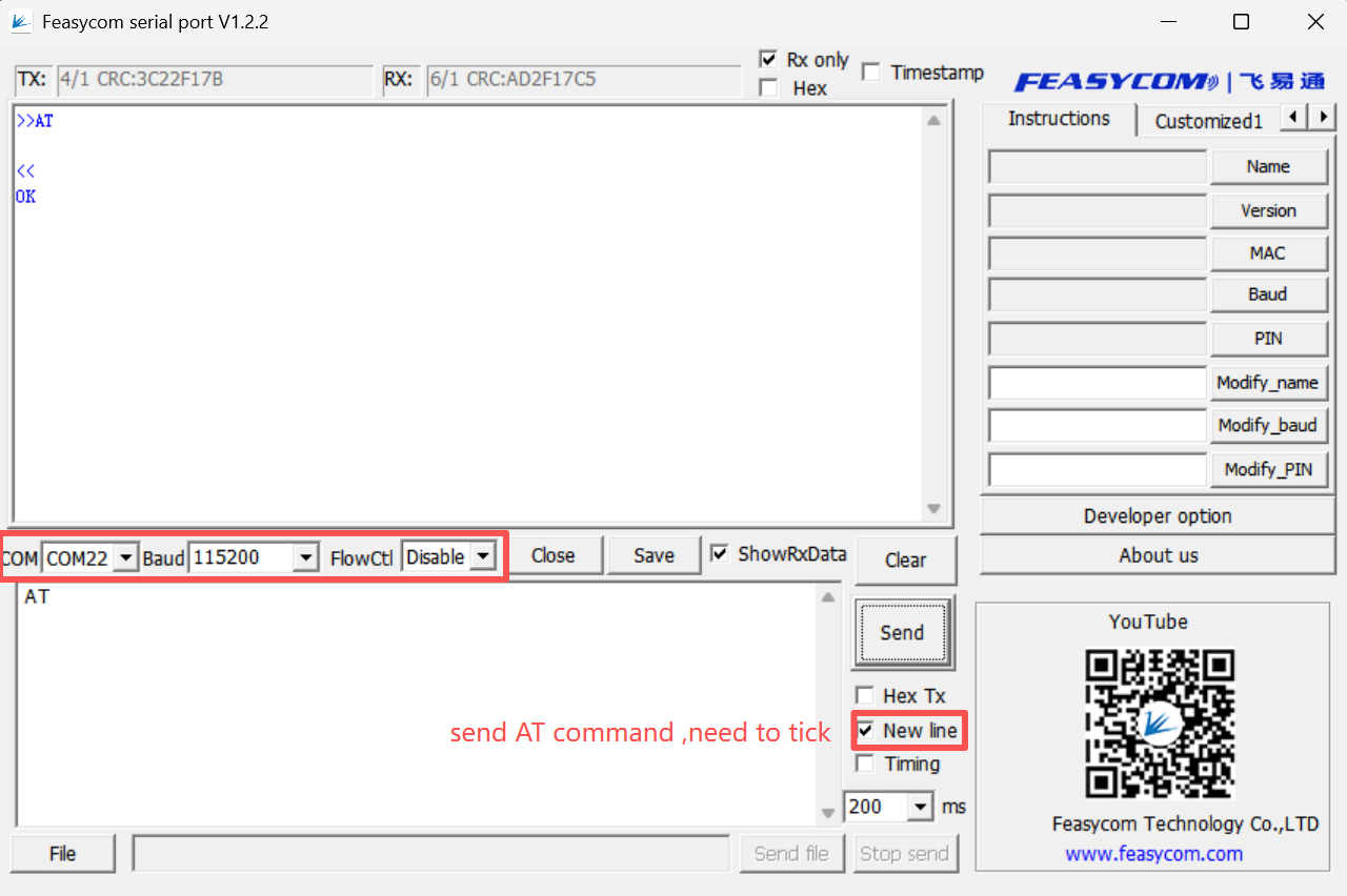

Communication Test
For more AT commands, please refer to FSC-BT936B General Audio AT Command Set .
 Send:    >>AT\r\n
 Response:<<\r\nOK\r\n
Send:     <<AT+NAME\r\n
Response: >>\r\n+NAME=FSC-BT936-0D15\r\n   //Example, please refer to the actual reading
Response: >>\r\nOK\r\n
Send:     <<AT+LENAME\r\n
Response: >>\r\n+LENAME=FSC-BT936-LE-0D15\r\n   //Example, please refer to the actual reading
AT+VER - Read the Current Firmware Version
Send:     <<AT+VER\r\n
Response: >>\r\n+VER=BT936,V4.6.5\r\n    //Example, please refer to the actual reading
