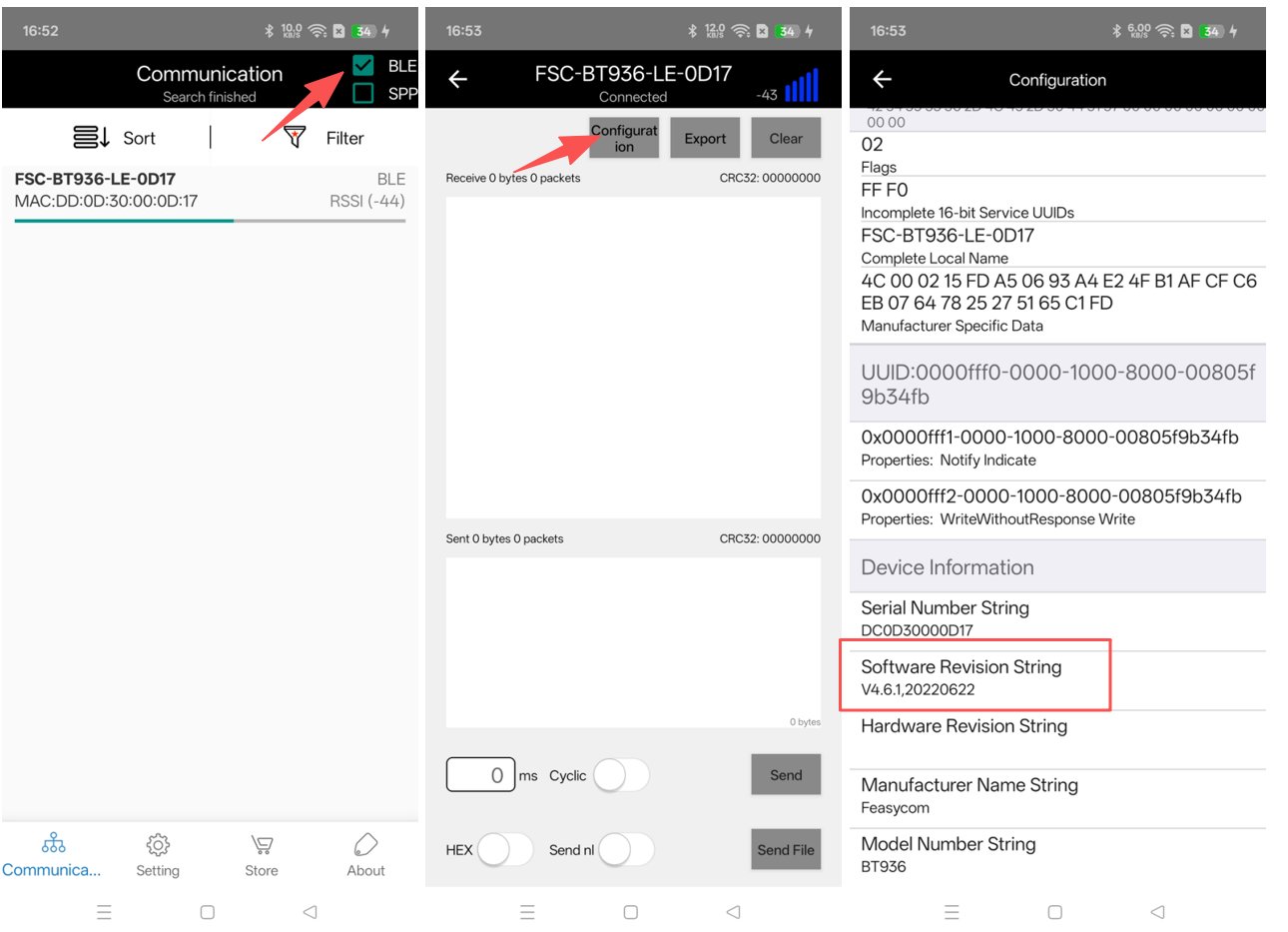

Currently, there are two ways to obtain the firmware version information of FSC-BT936B, as following:
FeasyBlue App
After establishing a BLE connection between the FeasyBlue App and the FSC-BT936B modules, check the firmware version information on the Configuration function page.
The profile of the Bluetooth module needs to enable the BLE (GATT) function
