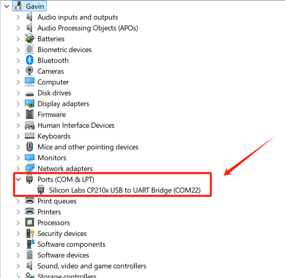

1.Connect the FSC-DB200-BT936E to the PC via a USB-to-Type-C data cable. The PC will automatically recognize the serial port and generate a virtual COMx port. As shown in the diagram below:
db200-bt936e-on-pc

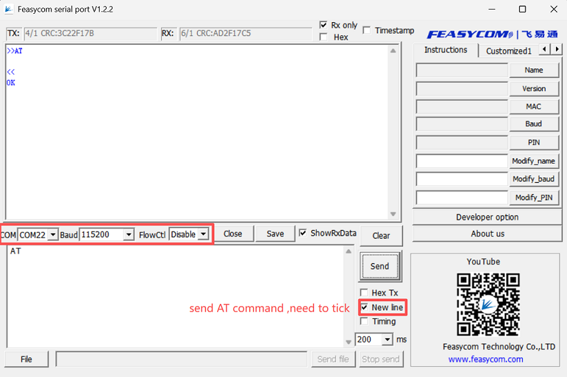

db200-bt936e-on-at
Communication Test
For more AT commands, please refer to FSC-BT936E General Audio AT Command Set .
 Send:    >>AT\r\n
 Response:<<\r\nOK\r\n
Send:     <<AT+NAME\r\n
Response: >>\r\n+NAME=FSC-BT936E-1B43\r\n   //Example, please refer to the actual reading
Response: >>\r\nOK\r\n
Send:     <<AT+LENAME\r\n
Response: >>\r\n+LENAME=FSC-BT936E-LE-0D15\r\n   //Example, please refer to the actual reading
AT+VER - Read the Current Firmware Version
Send:     <<AT+VER\r\n
Response: >>\r\n+VER=BT936E,V2.3.9,20250917\r\n    //Example, please refer to the actual reading
