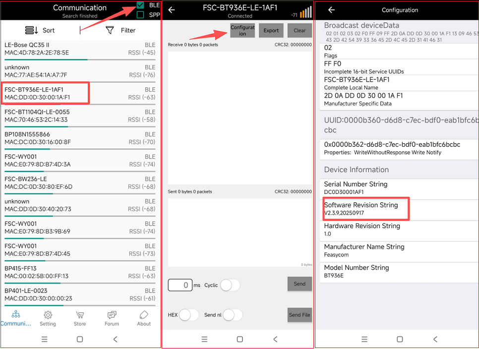

Currently, there are two ways to obtain the firmware version information of FSC-BT936E , as follows:
FeasyBlue App
After establishing a BLE connection between the mobile app FeasyBlue and the FSC-BT936E series modules, check the firmware version information on the Transmission Configuration function interface.
The profile of the Bluetooth module needs to enable the BLE (GATT) function
