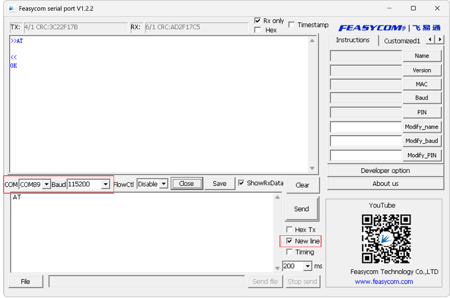

1.Connect the FSC-DB005-BT618x Quick Development Kit to the PC via USB. The PC will automatically recognize the serial port and generate a virtual COMx port.
bt618x
2.Run the Feasycom Serial Port Tool on the PC, set the correct COM and Baud, and check the New Line opti.
bt618x
UART Communication Test
The following lists a few basic general AT command test examples.
For more commands, please refer to FSC-BT618x General BLE Data AT Command Set .
send:     >>AT\r\n
response: <<\r\nOK\r\n    //Successfully connected.
AT+NAME - Read/Write Bluetooth Name
Example:Read Bluetooth name
send:     <<AT+NAME\r\n
response: >>\r\n+NAME=FSC-BT618\r\n     //Default, please refer to the actual reading result
response: >>\r\nOK\r\n
Send:    <<AT+VER\r\n
Response:>>\r\n+VER=1.0.0,FSC-BT618\r\n       //Example, please refer to the actual reading result
