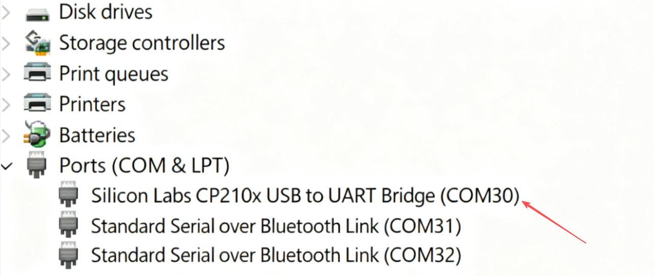

1.Connect FSC-DB200-BT1036C to PC via USB To Type-C cable, switch the UART/USB toggle to UART,Press the USB/battery power option button to switch to USB power supply, and the PC will automatically recognize the serial port and generate a virtual COMx port.
