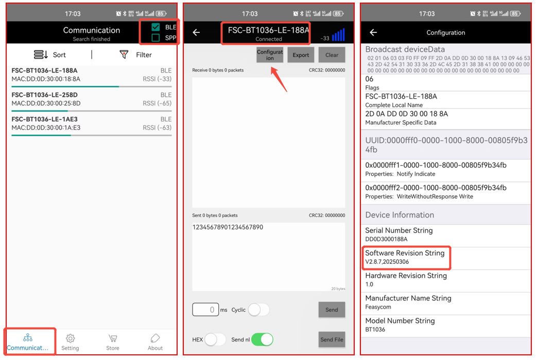

Obtain Firmware Version
FeasyBlue App
After establishing BLE connection with the FSC-BT1036x through FeasyBlue APP, check the firmware version information on the Configuration function interface.
**Warning:**The profile of the Bluetooth module needs to enable BLE (GATT) function
