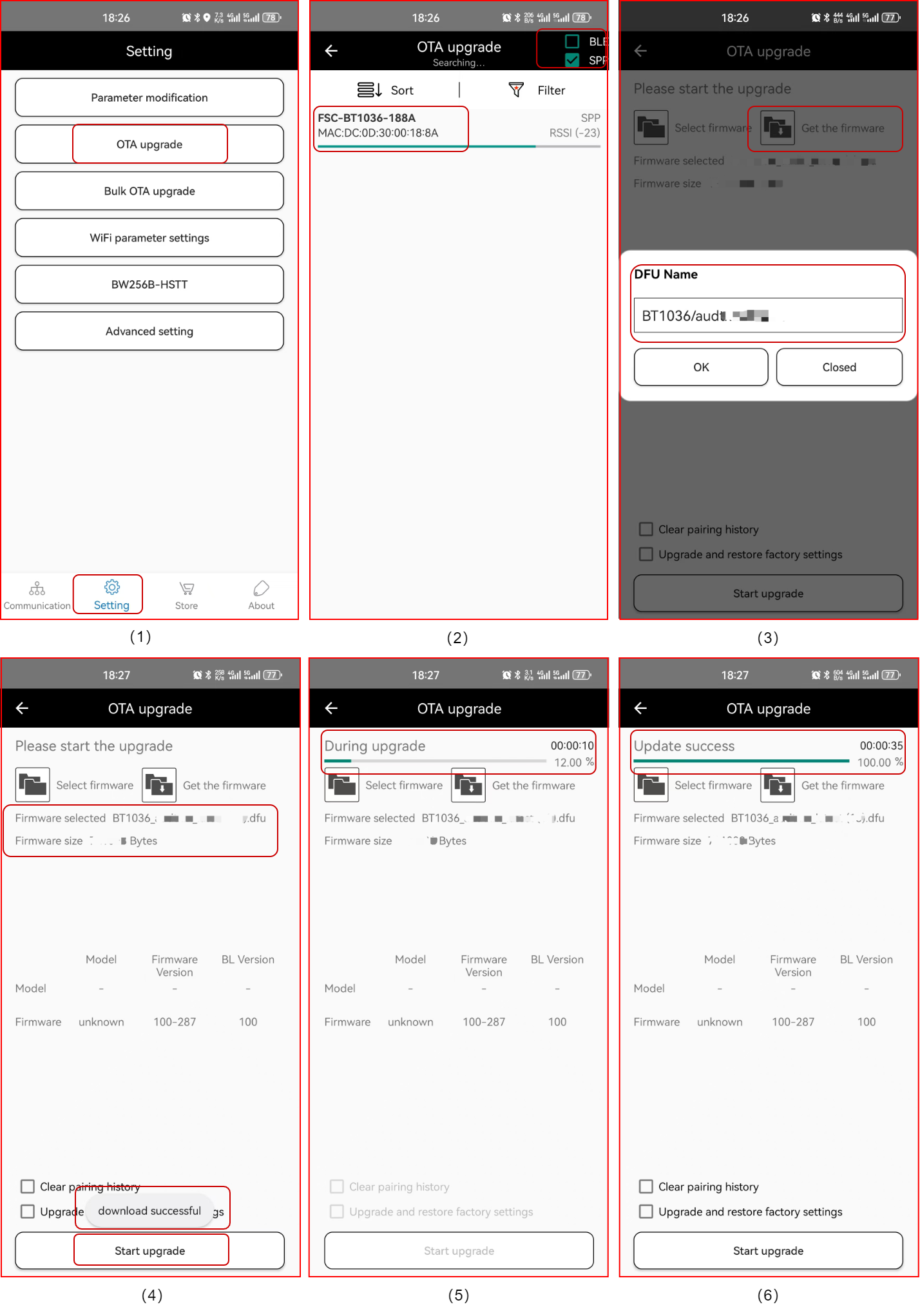

OTA upgrade
App Download
User Guide
1.Run the FeasyBlue App, select Setting - OTA Upgrade to enter the OTA Upgrade function page. After entering, it will redirect to the device search page where you can select the Bluetooth device to be upgraded.
2.Scan and select the Bluetooth devices that need to be upgraded. After selecting the device, you will enter the Firmware Loading interface to load the firmware update file.
3.There are two ways to load the firmware update file:
  • Select firmware: Choose to load the firmware update file stored locally on the phone (the firmware update file is provided by Feasycom).
  • Get the firmware: By entering the DFU name, the corresponding firmware update file can be downloaded and imported from the Feasycom cloud server via the network (the DFU name is provided by Feasycom).
4.After successfully loading the firmware update file, click the Start Upgrade button. The message “Upgrading” and the upgrade progress will be displayed, indicating that the upgrade mode has been successfully entered and the upgrade is in progress.
5.Wait for the upgrade progress bar to complete and display “Upgrade Completed”, then the upgrade is considered complete.

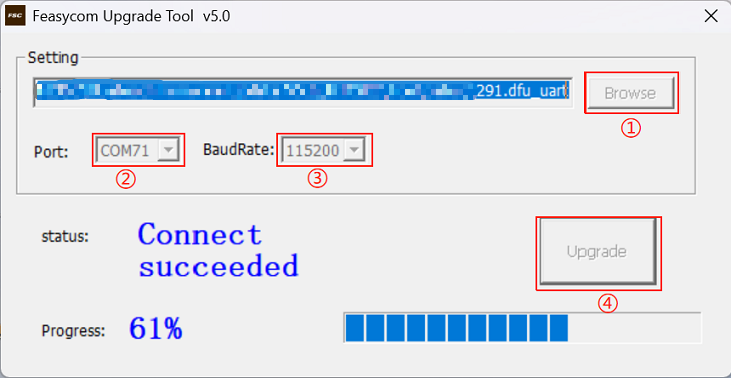

Tool
User Guide
1.Open the Feasycom UART Upgrade Tool 5.0, then click Browse to select the .duf_uart format firmware upgrade file stored on the local PC, and load the firmware file;
2.After loading the firmware file, select the corresponding COMx port for the Port project, and choose the current baud rate of the module in the BaudRate item (the default baud rate for the general program is 115200). Make sure that the configuration selection is correct.
3.Click on Upgrade, and the Status will be Connect Successed. The Progress section will display the progress information, indicating that the upgrade mode has been entered and the upgrade process has begun.
4.When the Status becomes Update Successed and the Progress reaches 100%, the firmware upgrade is complete.
