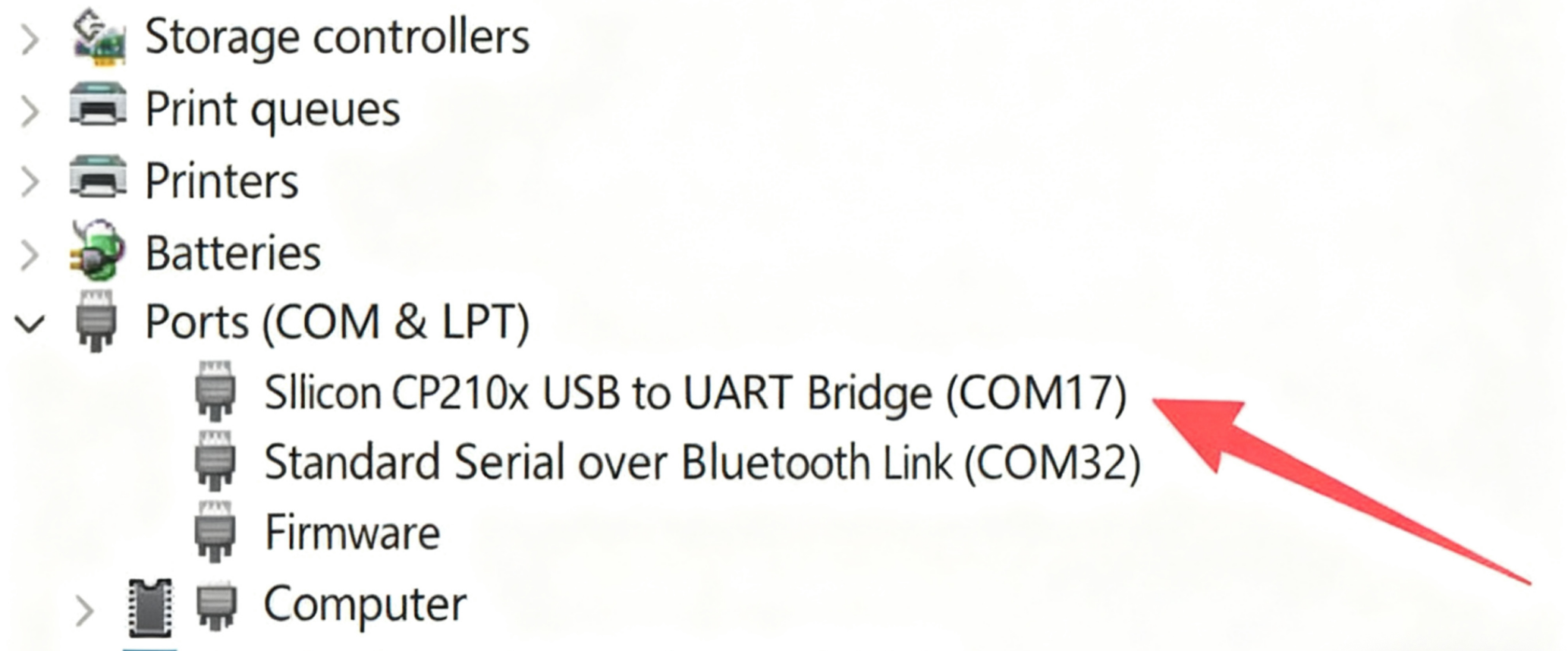

Connect FSC-DB200-BT1038x to PC via USB To Type-C cable, switch the UART/USB toggle to UART, press the USB/battery power option button to switch to USB power supply, Press and hold the ON/OFF button for 2-3 seconds to turn on the device, and the PC will automatically recognize the serial port and generate a virtual COMx port.
