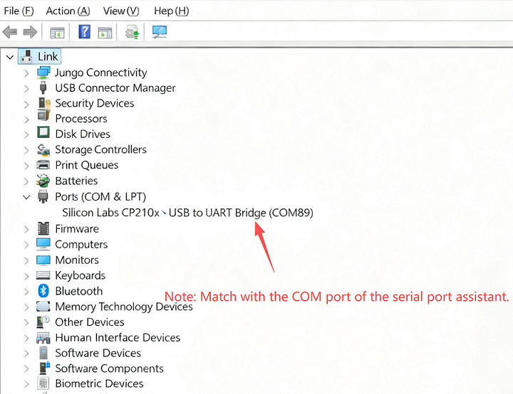

1.On the premise of ensuring compliance with the aforementioned UART connection requirements, set up the hardware testing environment with the PC. Upon completion, the PC will automatically recognize the device and virtualize a COM port.

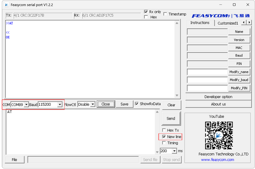

2.Run the Feasycom Serial Port Tool on the PC, set the correct COM and Baud, and check the New Line opti.

The following lists a few basic general AT command test examples.
For more commands, please refer to FSC-BT3431 General BLE Data AT Command Set .
send:     >>AT\r\n
response: <<\r\nOK\r\n    //Successfully connected.
AT+NAME - Read/Write Bluetooth Name
Example:Read Bluetooth name
send:     <<AT+NAME\r\n
response: >>\r\n+NAME=FSC-BT3431\r\n           //Default, please refer to the actual reading result
response: >>\r\nOK\r\n
Send:    <<AT+VER\r\n
Response:>>\r\n+VER=1.0.0,FSC-BT3431\r\n   //Example, please refer to the actual reading result
