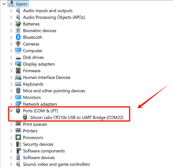

1.Connect the FSC-DB006-BT630x Quick Development Kit to the PC via USB. The PC will automatically recognize the serial port and generate a virtual COMx port.

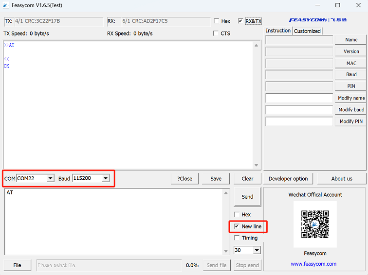

Communication Test
The following lists a few basic general AT command test examples.
For more commands, please refer to FSC-BT630x General Data AT Command Set .
send:     <<AT\r\n
response: >>\r\nOK\r\n            //Successfully connected.
AT+NAME - Read/Write Bluetooth Name
Example:Read Bluetooth name
send:     <<AT+NAME\r\n
response: >>\r\n+NAME=Feasycom\r\n          //Default, please refer to the actual reading result
