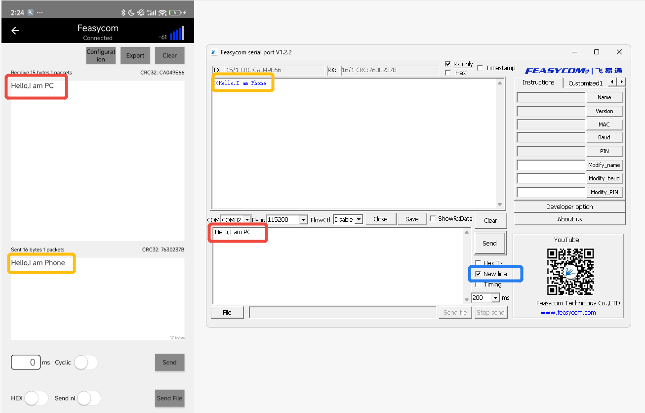

Module to Phone Application
1.Module Side: After power-on, the module will continuously send broadcast packet data.
2.Mobile Phone Side: Open the [FeasyBlue App] , scan for broadcast packets of nearby Bluetooth BLE devices, find the target Bluetooth module, and establish a connection.
3.After successful connection, the status pin of the module will pull up the level, indicating that the connection has been established.
4.After successful connection, in the transparent transmission mode, the module will automatically transmit the serial port data it receives to the remote end (mobile phone side) via air.
../_images/bt691-data-bt-app.png

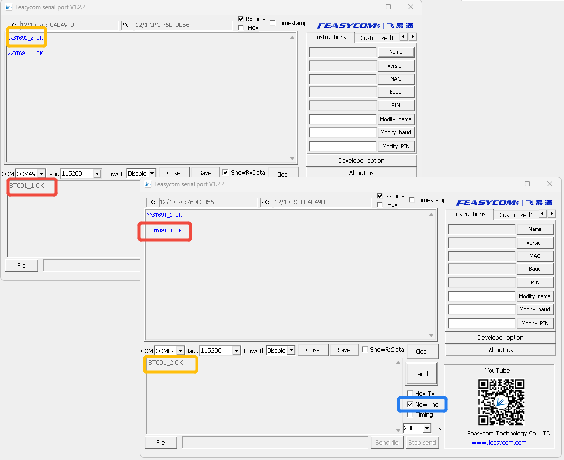

Module to Module Application
Demonstration of BLE communication data transparent transmission between FSC-BT691(Master) and FSC-BT3431(Slave) Bluetooth modules, as follows:
1.Scan for nearby BLE devices
FSC-BT691(Master) scans for nearby Bluetooth BLE devices:
1Send:<<AT+SCAN=1                // Scan nearby Bluetooth BLE devices
2Response:>>OK
3     >>+SCAN={                   //Scan Started
4     >>+SCAN=0,DC0D30000A09,-84,8,Feasycom      // FSC-BT691(Slave)
5     >>+SCAN=1,DD0D3040201C,-86,13,FSC-BW256B-LE
6     >>+SCAN=0,E0798DB74D3C,-93,9,FSC-WY001
7     >>+SCAN=1,DC0DAA7E5CBF,-86,10,FSC-BP106G
8     >>+SCAN=1,559F3B6E9D2F,-85,15,LAPTOP-81TBTP4L
9     >>+SCAN=}                  //Scan Completed
2.Establish BLE connection request
FSC-BT691(Master) establishe BLE protocol connection with FSC-BT691(slave) via the AT+LECCONN command as follows:
1Send:     <<AT+LECCONN=DC0D30000A090     // Establish BLE connection request
2Response: >>OK
Warning
AT+LECCONN=Target Bluetooth MAC address + 1-bit address type.
How to obtain the address type:
Use AT+SCAN=1 for scanning. The first parameter in the return result is the address type, as in the following example:
1 //The address type is the first parameter, which is "0".
2
3 Response: >>+SCAN=0,DC0D30000A09,-84,8,Feasycom
3.BLE Connection Established Successfully
In throughput mode, after the Bluetooth connection is successfully established, the serial port cannot receive event response indicators. The current connection status can be determined by the level state of Pin18 of FSC-BT691, as detailed below:
High Level (H): Indicates Bluetooth is successfully connected.
Low Level (L) : Indicates Bluetooth is not connected or the connection has been disconnected.
4.Send Data
The throughput mode of the general data transmission firmware is enabled by default. After BLE connection is successfully established, data can be sent directly without the need to send data via AT commands:
../_images/bt691-data-bt-bt.png

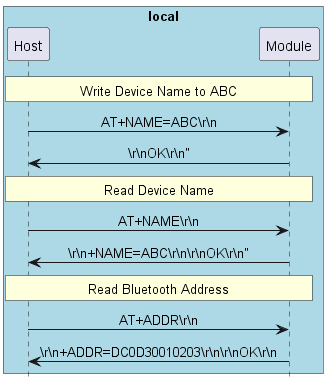

Read/Write Module Default Parameters
When Bluetooth is not connected, the module parses UART data as AT commands. The host can query and modify the module’s default parameters. The following example demonstrates:
  1. Write Device Name : ABC
  2. Read Device Name
  3. Read Bluetooth Address
rnote over host, bt: Write Device Name to ABC
rnote over host, bt: Read Device Name
rnote over host, bt: Read Bluetooth Address

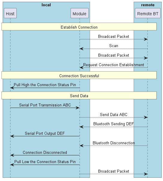

Data Transmission Flow
1.When the module is powered on, it continuously sends broadcast data outward. A remote Bluetooth device (e.g., a mobile phone) can obtain the broadcast packet by searching and initiate a connection request to the module.
2.After the connection is successfully established, the module will pull high the connection status pin to notify the host that the Bluetooth connection has been successfully established.
3.The host can send data to the remote Bluetooth device via the Bluetooth module, and the remote Bluetooth device can also send data to the host.
rnote over host, remote: Establish Connection
        bt --> remote: Broadcast Packet
        bt <-- remote: Scan
        bt <-- remote: Request Connection Establishment
rnote over host, remote: Connection Successful
host <- bt: Pull High the Connection Status Pin
rnote over host, remote: Send Data
host -> bt: Serial Port Transmission ABC
        bt --> remote: Send Data ABC
        bt <-- remote: Bluetooth Sending DEF
host <- bt: Serial Port Output DEF
        bt <-- remote: Bluetooth Disconnection
host <- bt: Connection Disconnected
host <- bt: Pull Low the Connection Status Pin

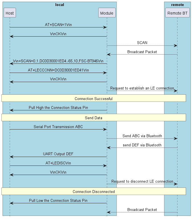

Module Acts as Master to Connect to Remote Device
The module can act as master device to connect to remote slave devices.
The host can send AT commands to control the module to perform scanning, connection, and disconnection operations. The following shows the process of connecting to other devices:
participant "Remote BT" as remote
host -> bt: AT+SCAN=1\\r\\n
host <- bt: \\r\\nOK\\r\\n
        bt --> remote: SCAN
        bt <-- remote: Broadcast Packet
        bt --> remote: Request to establish an LE connection
        bt --> remote: Send ABC via Bluetooth
        bt <-- remote: send DEF via Bluetooth
host <- bt: UART Output DEF
host -> bt: AT+LEDISC\\r\\n
        bt --> remote: Request to disconnect LE connection
rnote over host, remote: Connection Disconnected
