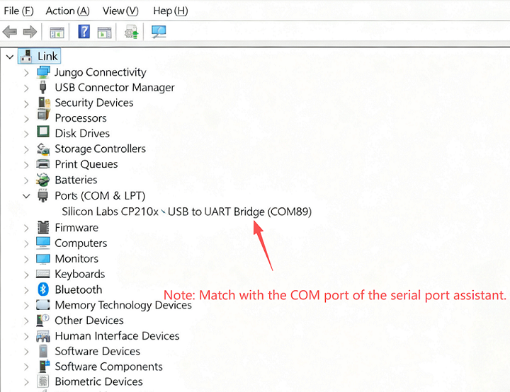

1.Connect the FSC-DB006-BT691 Quick Development Kit to the PC via USB. The PC will automatically recognize the serial port and generate a virtual COMx port.
