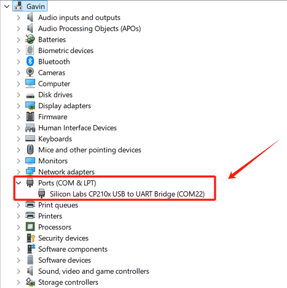

1.Connect the FSC-DB105-BW236 quick development kit to the PC via USB. The PC will automatically recognize the serial port and generate a virtual COMx port.

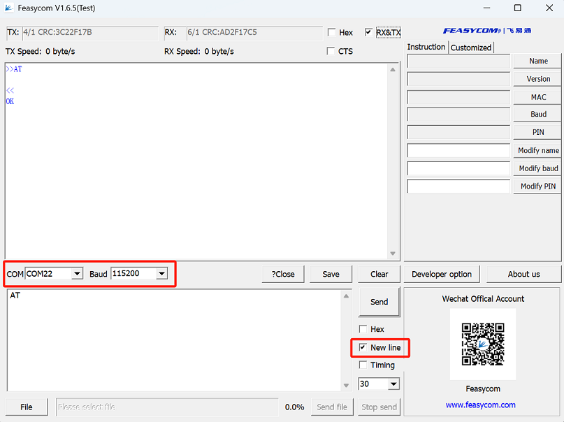

2.Run Feasycom Serial Port Tool on the PC, set the correct COM and Baud,and check the New line.
bw236

AT - Serial Communication Test
Send:     <<AT\r\n
Response: >>\r\nOK\r\n     //successfully connected
AT+NAME - Read the Bluetooth name
Send:     <<AT+NAME\r\n
Response: >>\r\n+NAME=FSC-BW236-LE\r\n       //Example, please refer to the actual reading result
AT+VER - Read the current firmware version
Send:     <<AT+VER\r\n
Response: >>\r\n+VER=FSC-BW236,V5.1.5\r\n      //Example, please refer to the actual reading result
