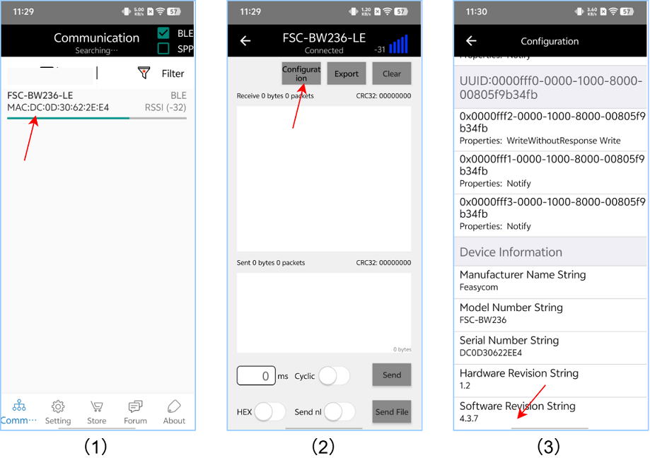

Obtain Firmware Version
FeasyBlue App
After establishing BLE connection with the FSC-BW236 Bluetooth module via the FeasyBlue App , view the firmware version information in the Configuration page.
app-ver
