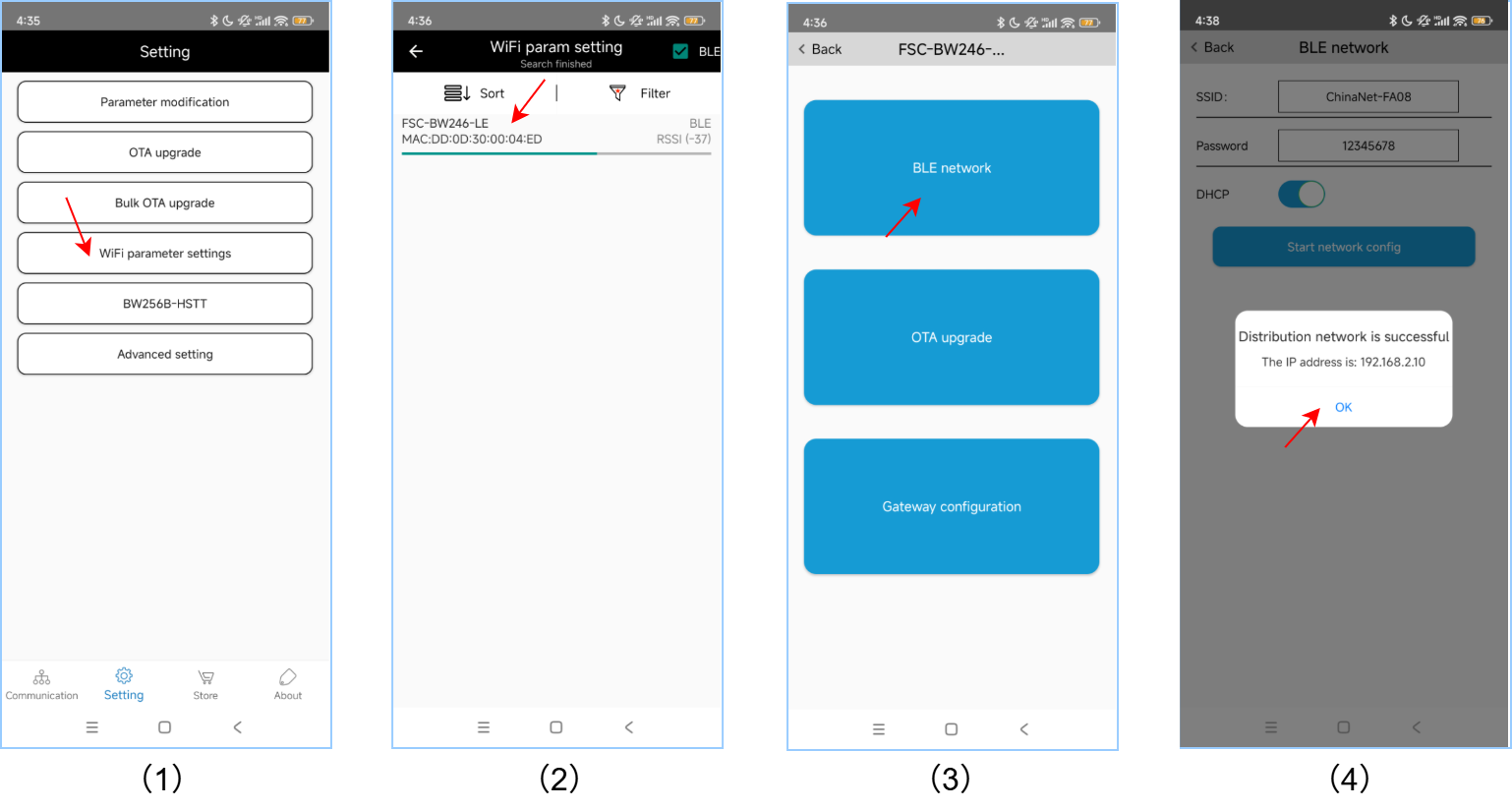

FeasyBlue Bluetooth Network Configuration
APP Download
User Guide
1.Open the FeasyBlue App and click on Setting - WiFi Parameter Settings to enter the WiFi param setting page.
2.On the WiFi param setting page, Check BLE , scan and select the WiFi param setting page.
3.Select and click on BLE Network to enter the BLE network page.
4.On the BLE network page, enter the enter the SSID 和 password of the Wi-Fi AP to be connected, and click Start network config.
5.After the distribution network is completed, It will show the Distribution network is successful and the IP address .
Example
../_images/bw246-bt-network-en.png

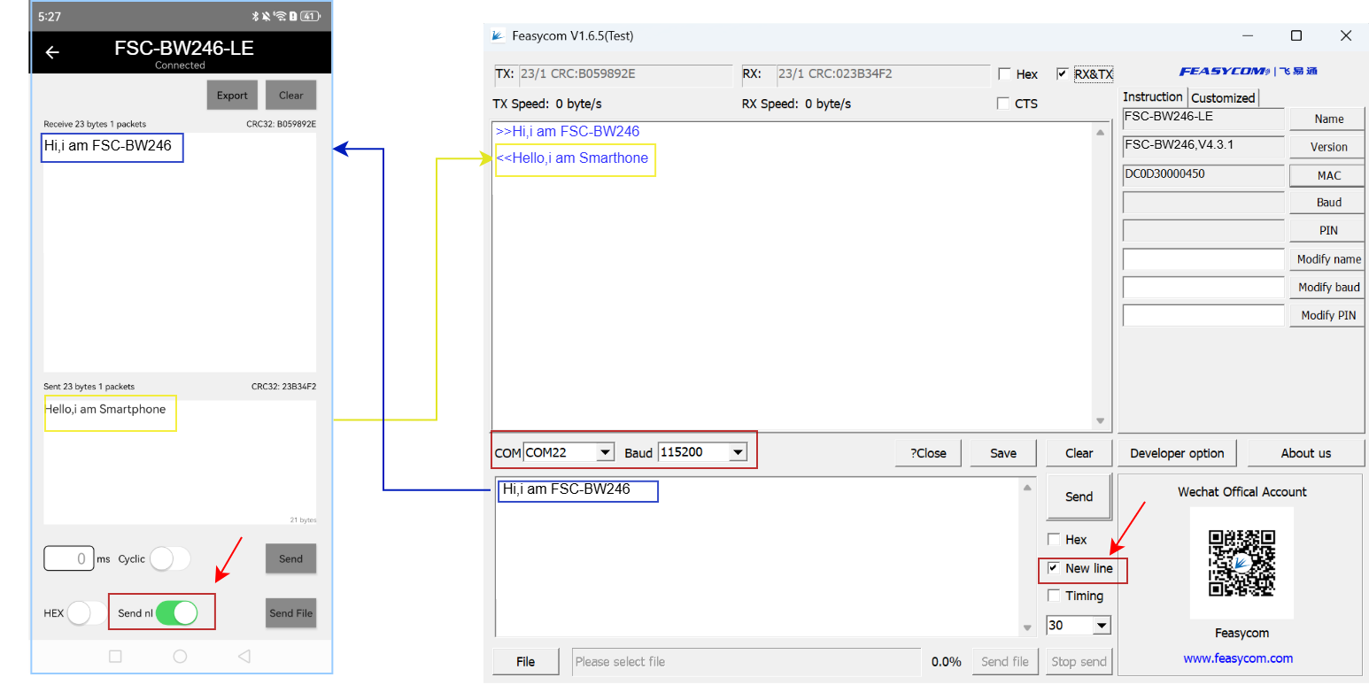

Throughput Mode Application
Module to Phone Communication
../_images/bw246-bt-app-tp-en.png

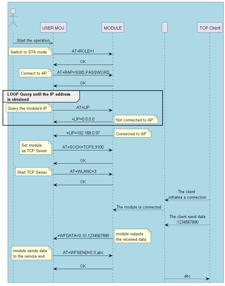

TCP Server Application Flowchart
box  #LightBlue
actor “ ” as person
participant “USER MCU” as mcu
participant MODULE as module
participant " " as nu
participant "TCP Client" as client
person ->> mcu: Start the operation
mcu -> module: AT+ROLE=1
note left
    Switch to STA mode
end note
module -> mcu: OK
mcu -> module: AT+RAP=SSID,PASSWORD
note left
    Connect to AP
end note
module -> mcu: OK
group LOOP Query until the IP address\nis obtained
mcu -> module: AT+LIP
note left
    Query the module's IP
end note
module -> mcu: +LIP=0.0.0.0
note right
    Not connected to AP
end note
end
module -> mcu: +LIP=192.168.0.97
note right
    Connected to AP
end note
mcu -> module: AT+SOCK=TCPS,9100
note left
    Set module
    as TCP Server
end note
module -> mcu: OK
mcu -> module: AT+WLANC=3
note left
    Start TCP Server
end note
module -> mcu: OK
client --> nu: The client \ninitiates a connection
nu --> module: The module is connected
client --> nu: The client send data\n:1234567890
module -> mcu: +WFDATA=0,10,1234567890
note right
    module outputs
    the received data
end note
mcu -> module: AT+WFSEND=0,3,abc
note left
    module sends data
    to the remote end
end note
module -> mcu: OK
nu --> client: abc

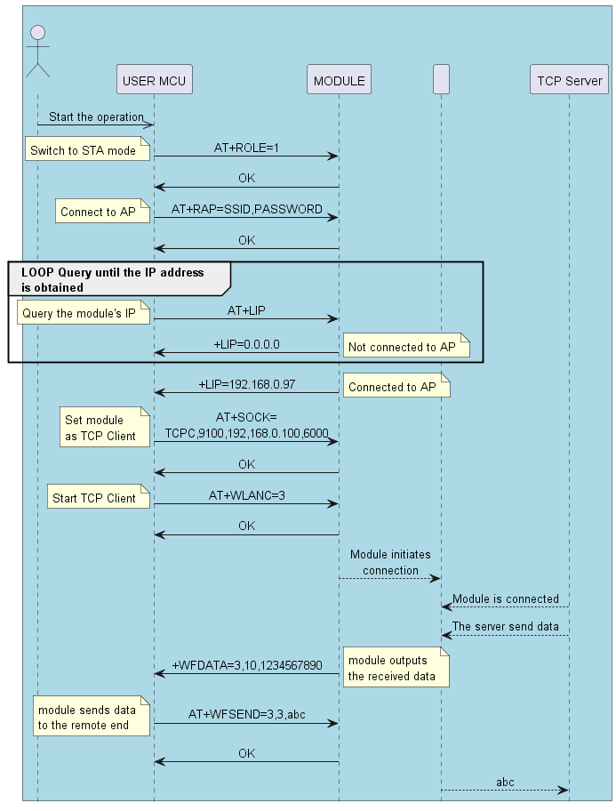

TCP Client Application Flowchart
box  #LightBlue
actor “ ” as person
participant "TCP Server" as server
note left
    Switch to STA mode
end note
module -> mcu: OK
note left
    Connect to AP
end note
module -> mcu: OK
note left
end note
note right
    Not connected to AP
end note
end
note right
    Connected to AP
end note
mcu -> module: AT+SOCK=\nTCPC,9100,192,168.0.100,6000
note left
    Set module
    as TCP Client
end note
module -> mcu: OK
note left
    Start TCP Client
end note
module -> mcu: OK
module --> nu: Module initiates\nconnection
server --> nu: Module is connected
server --> nu: The server send data
module -> mcu: +WFDATA=3,10,1234567890
note right
    module outputs
    the received data
end note
mcu -> module: AT+WFSEND=3,3,abc
note left
    module sends data
    to the remote end
end note
module -> mcu: OK
nu --> server: abc

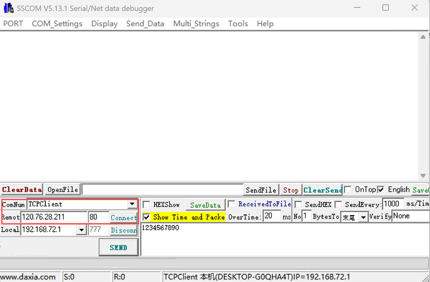

4.Connect the PC and the module to the same AP hotspot. Use a third-party network debugging tool on the PC to create a TCP Server.
For example, the IP address of the TCP Server is 192.168.0.79 and the port number is 8080.
5.Set the module as TCP client and configure the IP and port number of the remote TCP Server.
Send:     <<AT+SOCK=TCPC,9100,192.168.0.79,8080
Response: >>OK
6.The module acts as a TCP client to initiate the establishment of a TCP connection with the remote TCP Server.
Send:     <<AT+WLANC=3
Response: >>OK
7.After the TCP connection is successfully established, the PC-end network debugging tool will display the successful connection, as well as the data sending area and receiving area. TCP data sending and receiving can be carried out, such as sending data 1234567890 to the remote TCP Client module

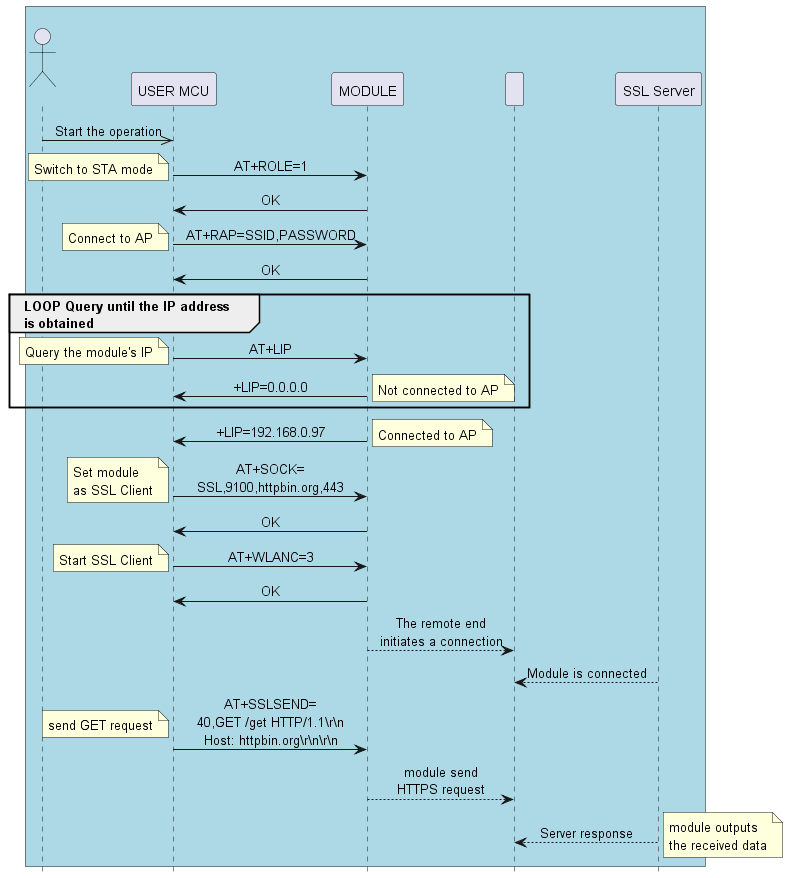

SSL Client Application
SSL Client Application Flowchart
box  #LightBlue
actor “ ” as person
participant "SSL Server" as server
note left
    Switch to STA mode
end note
module -> mcu: OK
note left
    Connect to AP
end note
module -> mcu: OK
note left
end note
note right
    Not connected to AP
end note
end
note right
    Connected to AP
end note
mcu -> module: AT+SOCK=\nSSL,9100,httpbin.org,443
note left
    Set module
    as SSL Client
end note
module -> mcu: OK
note left
    Start SSL Client
end note
module -> mcu: OK
module --> nu: The remote end\ninitiates a connection
mcu -> module: AT+SSLSEND=\n40,GET /get HTTP/1.1\\r\\n\nHost: httpbin.org\\r\\n\\r\\n
note left
    send GET request
end note
module --> nu: module send\nHTTPS request
server --> nu: Server response
note right
    module outputs
    the received data
end note
SSL Client Application Description
1.Set the Wi-Fi mode. If you are already in the current mode, you can skip this step
Send:     <<AT+ROLE=1
Response: >> OK
2.Connect to AP
Send:     <<AT+RAP=ssid,password
Response: >> OK
3.Query the IP address of the module
Send:     <<AT+LIP
Response: >>+LIP=192.168.0.97   //For local examples, please refer to the actual IP address obtained by connecting to the AP
Response: >>OK
4.Set the module as SSL client and configure the remote server and port number
Send:     <<AT+SOCK=SSL,9100,httpbin.org,443
Response: >>OK
5.The module initiates a connection to the remote end as an SSL client
Send:     <<AT+WLANC=3
Response: >> OK
6.Send relevant requests, such as GET requests
Send:     <<AT+SSLSEND=40,GET /get HTTP/1.1\\r\\nHost: httpbin.org\\r\\n\\r\\n
Response: >> OK
7.Receive data
Response: >>+SSLDATA=Specific data
To use throughput mode, simply send AT+TPMODE=1 before setting the Wi-Fi mode.

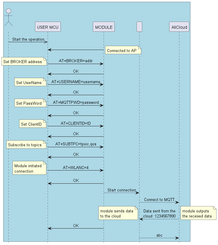

MQTT Application
MQTT Application Flowchart
box  #LightBlue
actor “ ” as person
participant "AliCloud" as cloud
module -> mcu:
note right
    Connected to AP
end note
mcu -> module: AT+BROKER=addr
note left
    Set BROKER address
end note
module -> mcu: OK
mcu -> module: AT+USERNAME=username
note left
    Set UserName
end note
module -> mcu: OK
mcu -> module: AT+MQTTPWD=password
note left
    Set PassWord
end note
module -> mcu: OK
mcu -> module: AT+CLIENTID=ID
note left
    Set ClientID
end note
module -> mcu: OK
mcu -> module: AT+SUBTPC=tpoic,qos
note left
    Subscribe to topics
end note
module -> mcu: OK
mcu -> module: AT+WLANC=4
note left
    Module initiated
    connection
end note
module -> mcu: OK
module --> nu: Start connection
nu --> cloud: Connect to MQTT
cloud --> nu: Data sent from the\ncloud :1234567890
note right
    module outputs
    the received data
end note
note left
    module sends data
    to the cloud
end note
module -> mcu: OK
nu --> cloud: abc
MQTT Application Description
Send:     <<AT+ROLE=1
Response: >>OK
2.Connect to AP
Send:     <<AT+RAP=SSID,PASSWORD
Response: >> OK
Send:     <<AT+LIP
Response: >>OK
4.Set the BROKER address
Send:     <<AT+BROKER=gpssensor.ddns.net
Response: >>OK
5.Set User Name
Send:     <<AT+USERNAME=admin
Response: >>OK
6.Set Password
Send:     <<AT+MQTTPWD=12345678
Response: >>OK
7.Subscribe to topics
Send:     <<AT+SUBTPC=user/get,0
Response: >> OK
8.Connect to MQTT
Send:     <<AT+WLANC=4
Response: >> OK
9.Receive the data sent by the cloud platform
1234567890
10.Send data to the cloud platform
Send:     <<AT+MQTTPUB=user/post,0,3,abc
Response: >>OK
