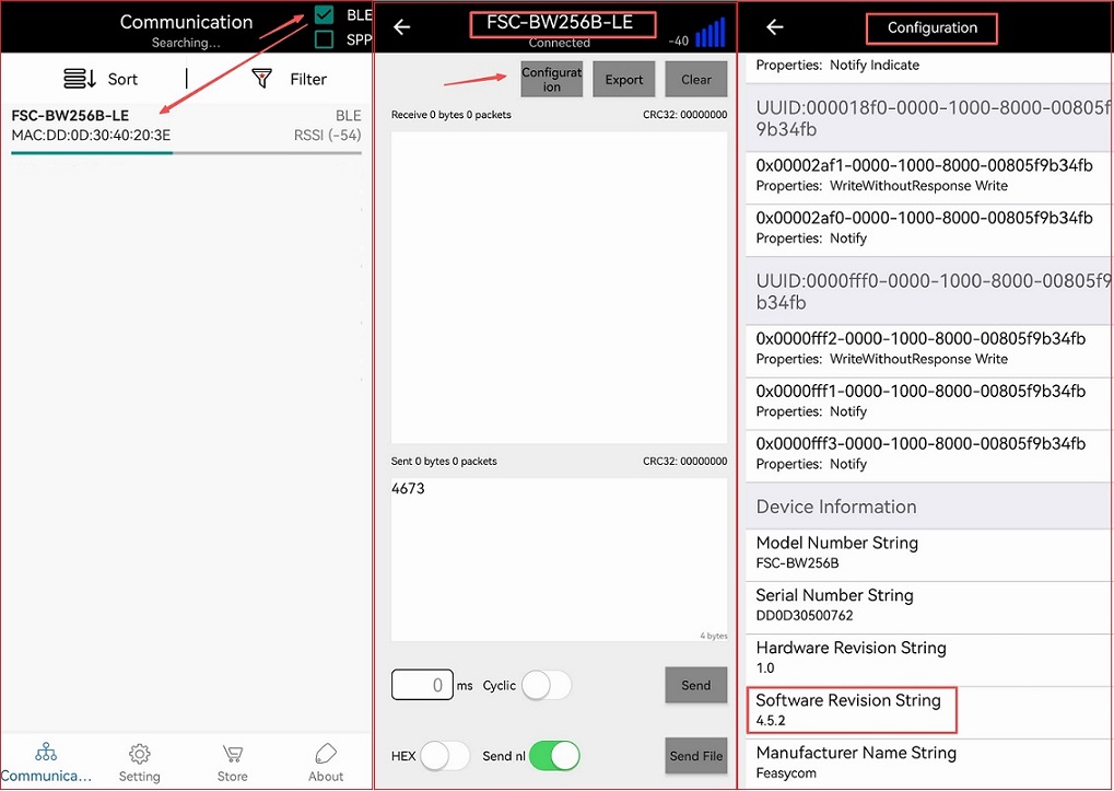

Obtain Firmware Version
FeasyBlue App
After establishing BLE connection with the FSC-BW256x series Bluetooth module via the FeasyBlue App , view the firmware version information in the Configuration page.
bw256b
