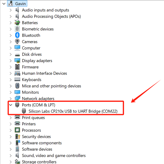

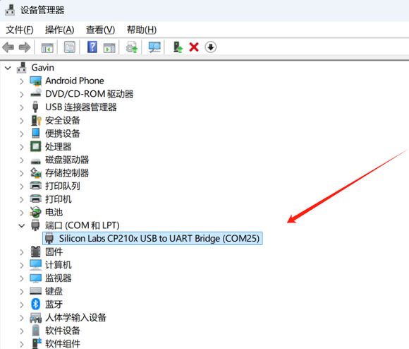

1.Connect the FSC-DB105-BW256B quick development kit to the PC via USB. The PC will automatically recognize the serial port and generate a virtual COMx port.

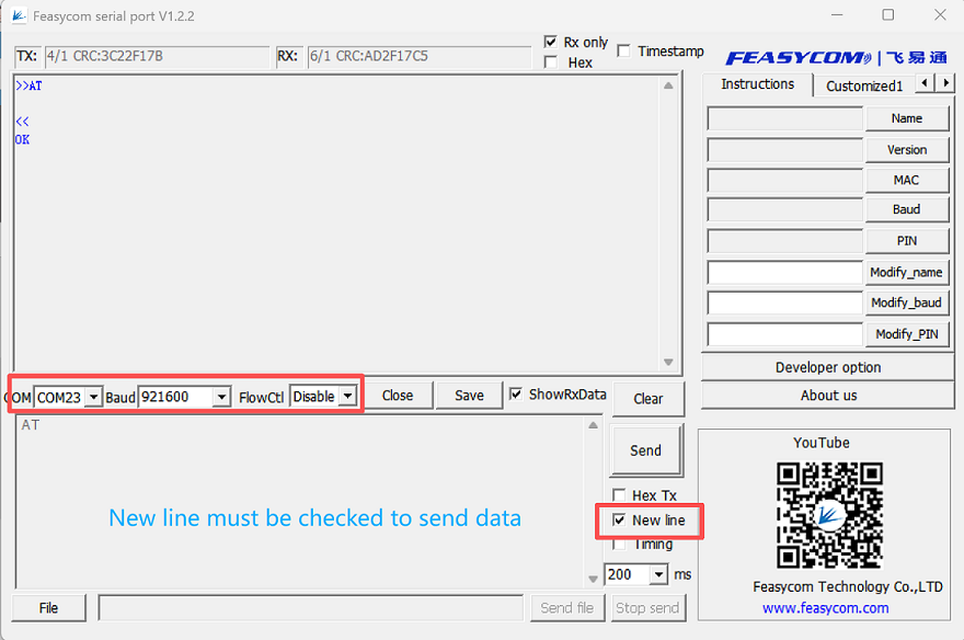

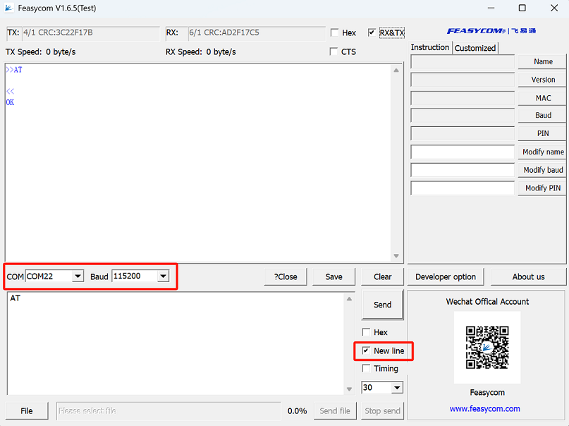

2.Run Feasycom Serial Port Tool on the PC, set the correct COM and Baud,and check the New line.
fsc-bw256x
Communication test
The following lists a few basic general AT command test examples.
For more commands, please refer to FSC-BW256B General Data AT Command Set .
Send:     <<AT\r\n
Response: >>\r\nOK\r\n     //successfully connected
AT+NAME - Read the BR/EDR Bluetooth name
Send:     <<AT+NAME\r\n
Response: >>\r\n+NAME=FSC-BW256B\r\n       //Example, please refer to the actual reading result
