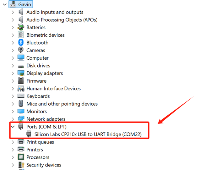

Module-to-PC
1.On the premise of ensuring compliance with the aforementioned UART connection requirements, set up the hardware testing environment with the PC. Upon completion, the PC will automatically recognize the device and virtualize a COM port.

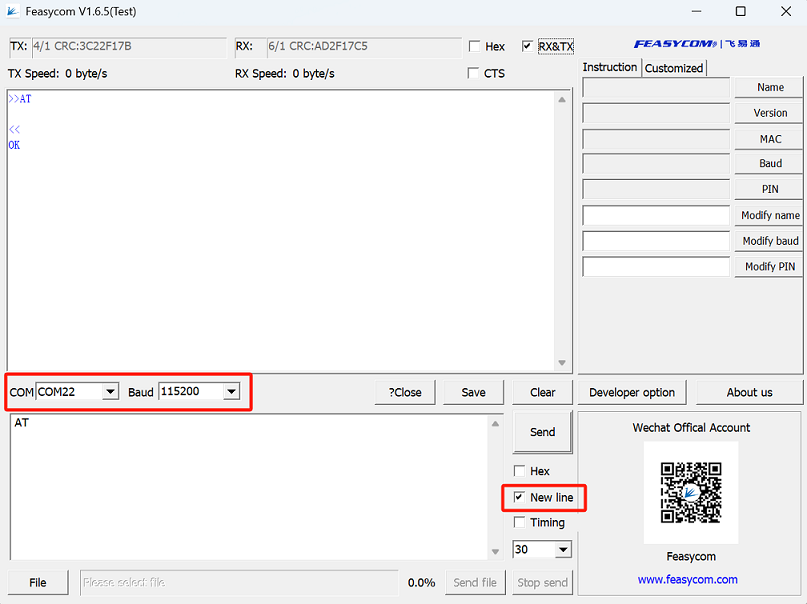

UART Communication Test
The following lists a few basic general AT command test examples.
For more commands, please refer to FSC-BT2064FI General AT Command Set.
Send:     <<AT\r\n
Response: >>r\nOK\r\n                 //Successfully connected.
