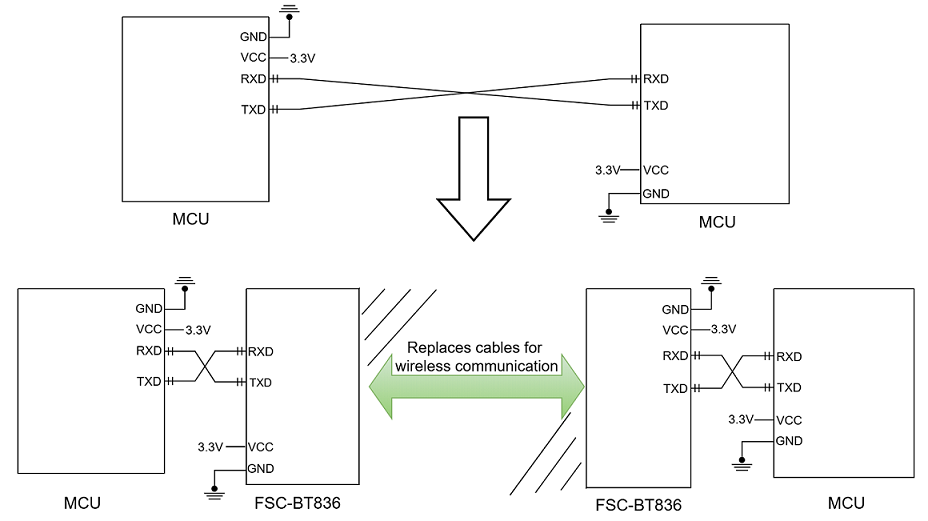

As shown in the figure, the Bluetooth module replaces the physical cable in full-duplex communication. A device like an MCU (left) sends data via its TXD pin to the Bluetooth module (left). The module’s RXD port receives the UART data and automatically transmits it via radio waves over the air to the remote Bluetooth module. The remote Bluetooth module (right) receives the airborne data and delivers it via its TXD pin to the local device, like an MCU (right).

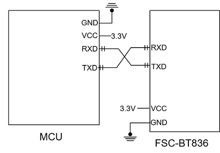

This diagram illustrates the connection between a master MCU (Microcontroller Unit) and an FSC-BT836 Bluetooth module via cross-connected serial ports, enabling command interaction between the master and the Bluetooth module to support wireless communication functions. It is applicable to IoT devices, remote control, and other scenarios.
  1. Serial Communication Interface: The master MCU’s transmit pin (MCU_TX) is cross-connected to the Bluetooth module’s receive pin (UART_RX), and the master MCU’s receive pin (MCU_RX) is similarly connected to the Bluetooth module’s transmit pin (UART_TX), forming a bidirectional data transmission channel.
  2. Power and Grounding: The Bluetooth module is powered by 3.3V through the VDD_3V3 pin and shares a common ground (GND) with the master MCU, ensuring level compatibility and signal stability.

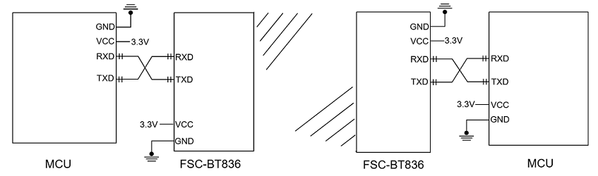

Two FSC-BT836 Bluetooth modules can establish a Bluetooth connection automatically upon power-up.
image-20250507181000226
A module can act as a master device to connect to a slave device. The host can send commands to control the module for Bluetooth scanning, connection establishment, data transmission, and connection termination.
