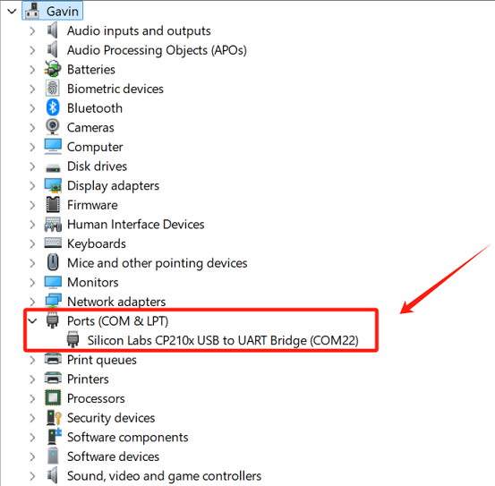

1.Connect the FSC-DB005-BT836B to the PC via USB. The PC will automatically recognize the serial port and create a virtual COM port.
pc_com_port

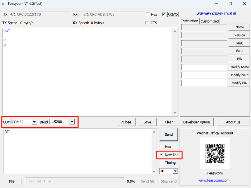

Communication Test
For more AT commands, please refer to FSC-BT836x General Dual-Mode Data AT Command Set.
send:     >>AT\r\n
response: <<\r\nOK\r\n   //Successfully connected.
